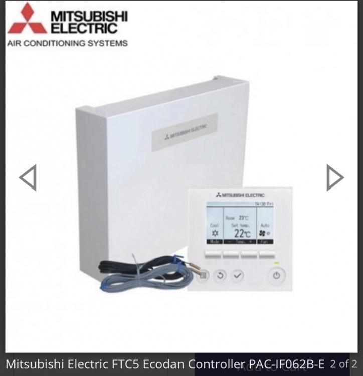

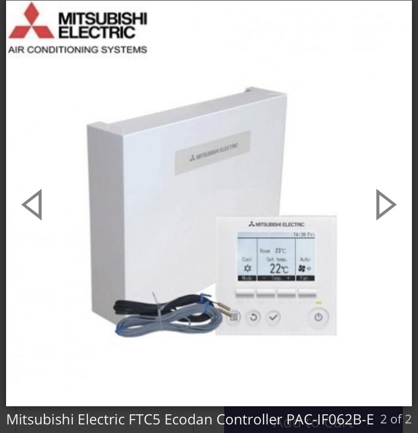

PeterW Posted December 18, 2020 Posted December 18, 2020 On 18/12/2020 at 05:56, RonDubber said: They said all I need to do is control it direct from the FTC Expand The FTC being referred to is a Mitsubishi FTC - it is their controller. https://www.swatengineering.co.uk/shop/mitsubishi-electric-ftc5-ecodan-controller-pac-if062b-e It is the brains of the ASHP and can’t be overriden by using anything else onto those connections as they are proprietary comms lines.
ProDave Posted December 18, 2020 Posted December 18, 2020 I am not seeing anything in the documentation yet that shows a "call for heat" input demand to the heat pump. Is this a special or strange version? Others with Mitsubishi ASHP's have found "room thermostat" inputs that do the job of call for heat. It is the ASHP end that is the issue at the moment, not the Heatmiser. Fig 6.1 refers to A, "Indoor Unit" which implies it has control inputs. Do you have the "indoor unit" and the manual for it, if not I think you need to get it. And this "indoor unit" is not the controller that peter linked to, that is C in Fig 6.1
PeterW Posted December 18, 2020 Posted December 18, 2020 (edited) On 18/12/2020 at 08:19, ProDave said: And this "indoor unit" is not the controller that peter linked to, that is C in Fig 6.1 Expand Thats not correct. Item A on the diagram is the interface unit or the flow temperature controller (FTC) that they are referring to. It comes as two parts - the first is the control box (A) that has no external visible controls, the second is the remote head unit (C) which is used to programme the FTC - this is what is supplied On 18/12/2020 at 08:19, ProDave said: Is this a special or strange version? Others with Mitsubishi ASHP's have found "room thermostat" inputs that do the job of call for heat. Expand This is a standard Mitsubishi external unit. Depending on the model they either come with a 5 core control wire to the indoor unit that is not connected to internal power, or this sort that uses a 3 core to control the external unit, but requires it’s own fused spur in the house. Whomever sold that Ecodan minus its FTC, and then said you could just connect “something” to S1/2/3 was telling lies !! It’s a 24v proprietary control signal that the FTC manages. Edited December 18, 2020 by PeterW Missing image
ProDave Posted December 18, 2020 Posted December 18, 2020 On 18/12/2020 at 09:04, PeterW said: Thats not correct. Item A on the diagram is the interface unit or the flow temperature controller (FTC) that they are referring to. It comes as two parts - the first is the control box (A) that has no external visible controls, the second is the remote head unit (C) which is used to programme the FTC - this is what is supplied This is a standard Mitsubishi external unit. Depending on the model they either come with a 5 core control wire to the indoor unit that is not connected to internal power, or this sort that uses a 3 core to control the external unit, but requires it’s own fused spur in the house. Whomever sold that Ecodan minus its FTC, and then said you could just connect “something” to S1/2/3 was telling lies !! It’s a 24v proprietary control signal that the FTC manages. Expand So presumably inside that "box with no controls" are all the terminals for call for heat, thermostat or whatever they choose to call them? That box with no controls is the "inside unit" they referred to I thought. but agreed that is what he needs.
PeterW Posted December 18, 2020 Posted December 18, 2020 On 18/12/2020 at 12:14, ProDave said: So presumably inside that "box with no controls" are all the terminals for call for heat, thermostat or whatever they choose to call them? That box with no controls is the "inside unit" they referred to I thought. but agreed that is what he needs. Expand Correct. It has the terminals for call for heat and the flow sensors etc

PeterW Posted December 18, 2020 Posted December 18, 2020 @RonDubber did you go to a Mitsubishi agent or Mitsubishi directly ..? There is no way to directly connect to a heat pump - they all use the same interface unit or Flow Temperature Control irrespective of the external unit and you should have been quoted for one of those also. The Heatmiser units just use the call for heat or boiler contact to close a contact on the FTC board (marked Room Thermostat from memory) which triggers the FTC to power up the external unit and set the flow temperature for the water etc. The only way to resolve is to get hold of an FTC unit. They very rarely come up on eBay or second hand as they can be connected to a newer external unit so you may have to bite the bullet and get a new one which are around £750.
