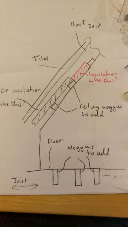

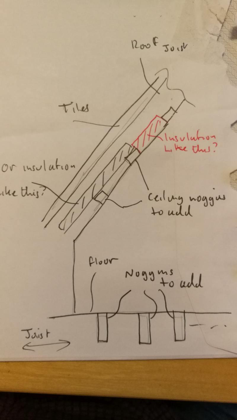

AlanUK Posted December 13, 2020 Posted December 13, 2020 Stud wall between joists I have a detached garage with room above, and I’m splitting the room into two, with a stud wall. I want to place it running midway between two joists, running parallel with them – see the picture. I will put noggins ever 400mm under the wooden floor between the pair of joists for the stud wall base to go onto. Would this be ok? For the walls and ceiling, can I just do the same, with small noggins? Also, the insulation that is to go into the roof, would it sit behind the noggins, running the full length, or would I cut up small pieces of insulation to put between the noggins? See my terrible drawing, showing a section through the room. Would the insulation run behind the smaller noggins (as shown in the black hatched option) or would it sit between noggins, as shown in the red hatched option? Thanks, Alan
nod Posted December 13, 2020 Posted December 13, 2020 Yes nogs under the sole plate Your easy way for the underside of the slope would be to counter baton with 75x25 mi This will give you fixing for stud and PB and leav a void for insulation
AlanUK Posted December 13, 2020 Author Posted December 13, 2020 44 minutes ago, nod said: Yes nogs under the sole plate Your easy way for the underside of the slope would be to counter baton with 75x25 mi This will give you fixing for stud and PB and leav a void for insulation Thanks nod. Silly question - When you say "counter baton", do you mean laying the boards out horizontally across the joists? I think I will need to do that anyways, to make up the depth of the diagonal boards that are stiffening the rafters together, so yes, that would work.
nod Posted December 13, 2020 Posted December 13, 2020 1 hour ago, AlanUK said: Thanks nod. Silly question - When you say "counter baton", do you mean laying the boards out horizontally across the joists? I think I will need to do that anyways, to make up the depth of the diagonal boards that are stiffening the rafters together, so yes, that would work. Yes I do You may find that you have do this twice Once to take you flush with the bracing Then the next will allow you to set out at 600 centers But I would get all your 70 mil kingspan in first
AlanUK Posted December 13, 2020 Author Posted December 13, 2020 25 minutes ago, nod said: Yes I do You may find that you have do this twice Once to take you flush with the bracing Then the next will allow you to set out at 600 centers But I would get all your 70 mil kingspan in first Good. I hope only to do it once, otherwise the room will get too narrow. Is 70mm a mandated depth of insulation? My builder said I need to put 25mm insulation boards over the bracing too. But I don't know if it's a requirement.
nod Posted December 13, 2020 Posted December 13, 2020 No that’s not enough We normally use 70 between the rafter 30 mil air gap at the top and a minimum of 38 mil insulated backed plasterboard or 48 mil PB Check with building control

tonyshouse Posted December 13, 2020 Posted December 13, 2020 Insulation between noggins and above them, leave 50mm ventilation gap but add as much insulation as you can for me nogs at 1200cc or two per run floor needs insulating and whole thing a vapour barrier and air tightness layer
