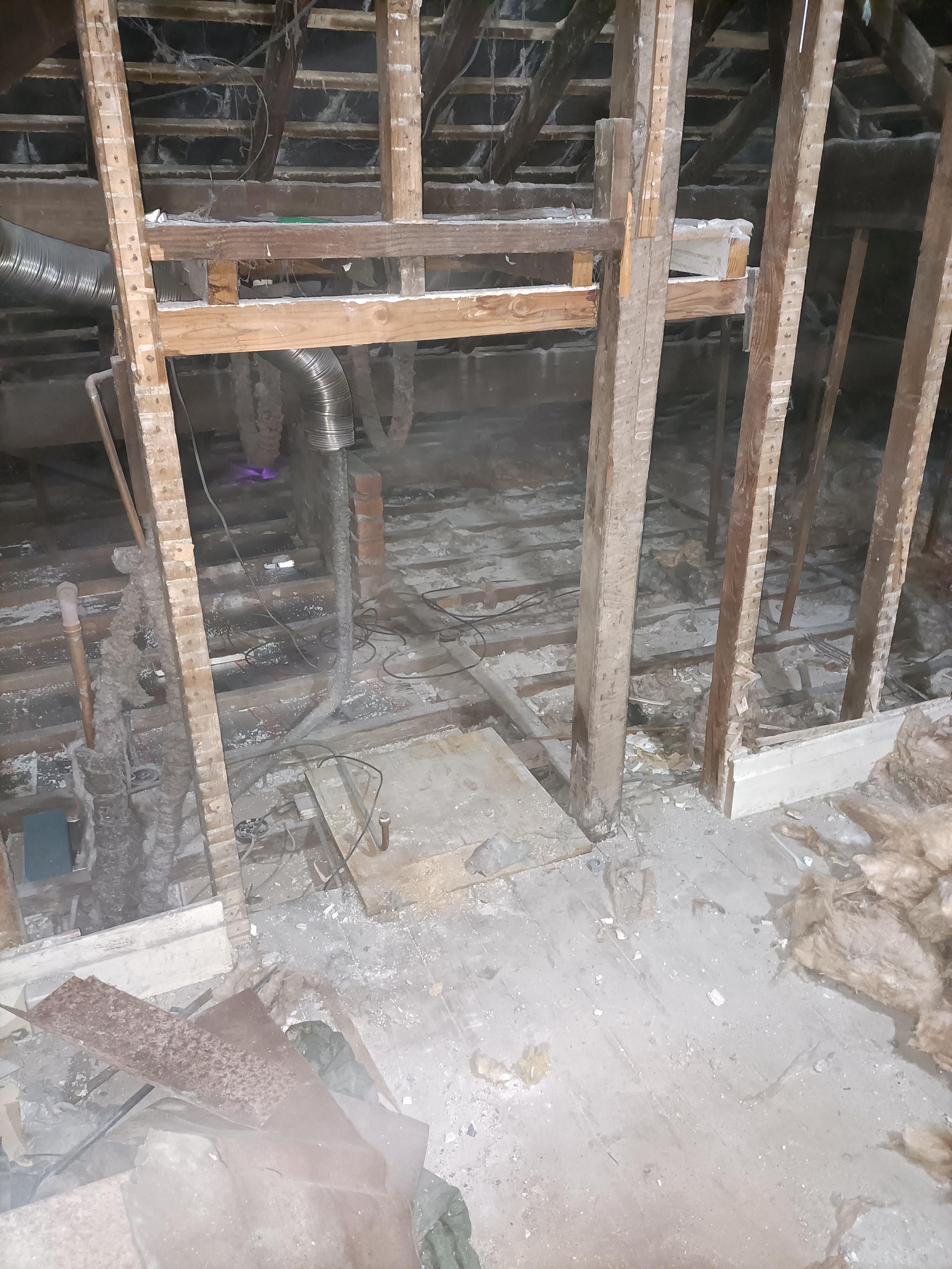

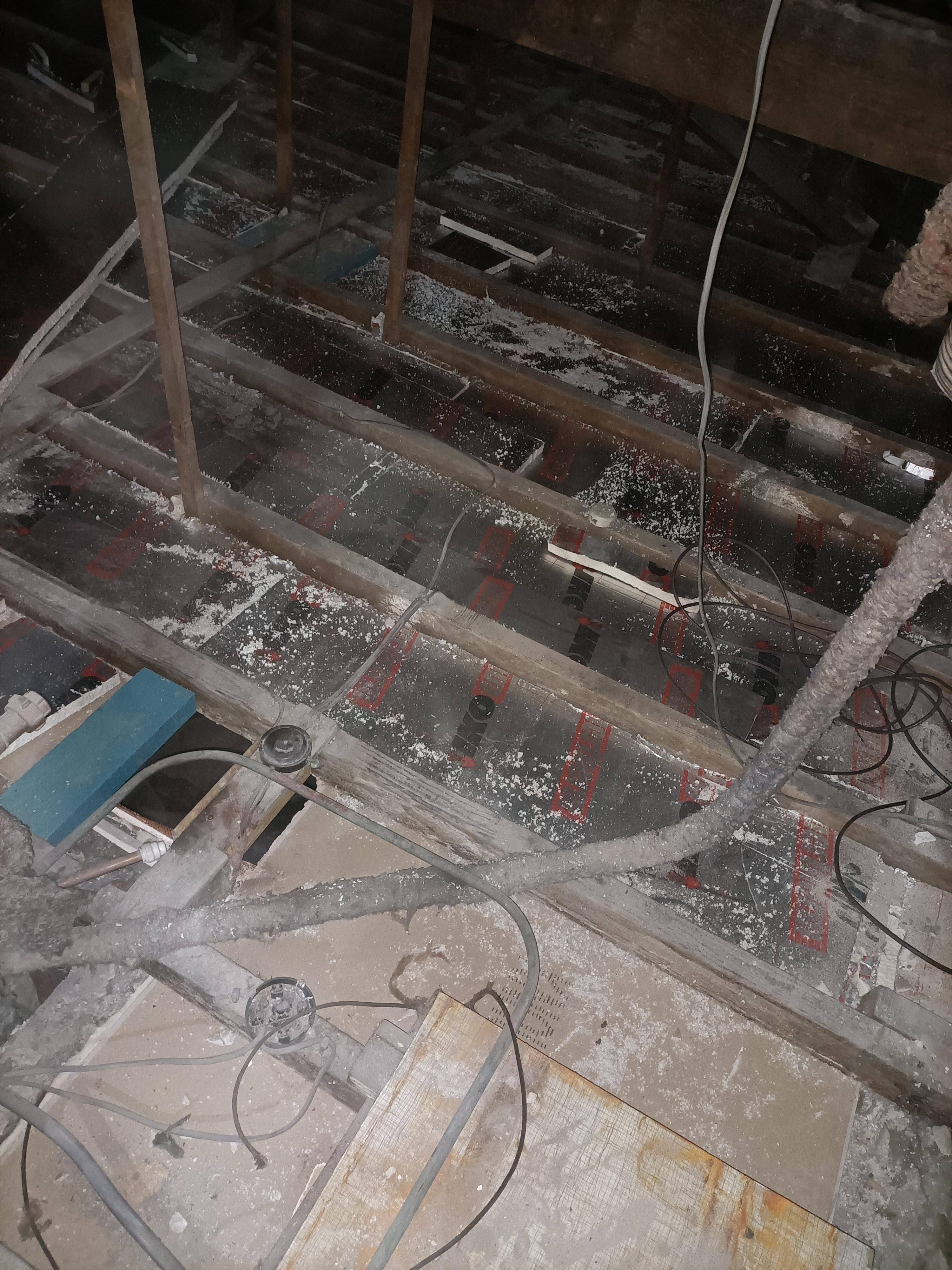

Hay guys and girls not been on here for a long time and I have moved since and remember how helpful people was on here ? I have just got up all the very old insulation from the loft and binned all the old stuff and started laying that kingspan stuff between the joists where I have put a new bedroom ceiling in. Now I want some of the fleecy stuff to lay on top of the kingspan for more insulation what's best to go for ???
I will also at some point be doing in between the joists where the roof is and was thinking more kingspan but keep seeing the foam stuff they spray but see a lot of mixed reviews on it just wanted to know what's best ???
Thanks again guys and girls this is something new to me so learning along the way so any help or advice you have is much appreciated
You shouldn't use kingspan between the joists as you'll have condensation issues behind the plasterboard. You should have 100mm mineral wool between joists and 200-300mm layed across the joists. You should also put all of you insulation on either the ceiling joists or under the roof rafters- not both.
Are you planning on using the attic space for storage or anything more? Looks to be a decent size. If you just want storage space, get those stilts so you can lay loft boards above the insualtion. I see you've no roof felt under your slates so that would mean no to any sort of spray insulation.

@Bryera  It looks like your timbers are at 400mm  centres, the most important thing is to find insulation rolls which are already partially pre-cut into 3 x 380mm sections, then find a thickness compatible with the remaining timber depth. The question then is do you use 'cheap as chips' loft roll with a thermal conductivity of 0.044 or premium Frametherm32, thermal conductivity 0.032 at about three times the price. If you intend to add more insulation above this I would not bother with the premium stuff, just use (150-200mm)  more loft roll.
There will be no problem with condensation on the underside of the Celotex if it has silver foil there, it acts as a vapour barrier layer. The additional insulation will keep it warm and there will be no problem with interstitial condensation
I put 70mm of kingspan under my shed rafters and 200+mm frametherm or something similar.... above it and was surprised at just how much heat wast trapped between them, it was toasty warm on the back of the kingspan ! It was a reminder that on general you can’t have to much insulation. Where there was just kingspan it just felt like the ambient temperature and one would assume it was working great as it was not warm but that was only because the heat from the room must instantly disperse into the air as there was no secondary insulation layer to trap it. I taped all the insulation sheets on the front so it acted as the VCL.
