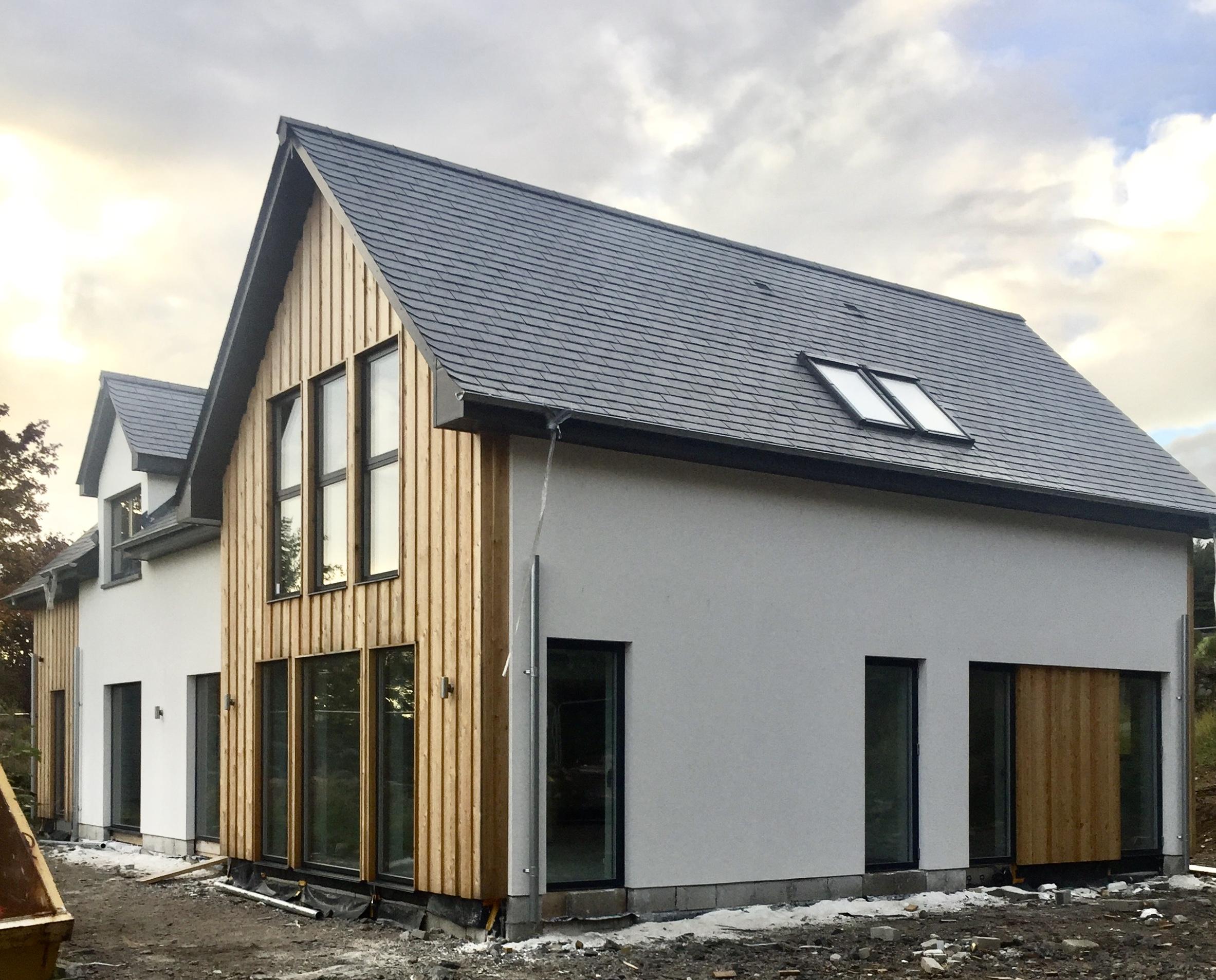

Bozza Posted November 23, 2020 Share Posted November 23, 2020 Are you using K rend or similar if so I think it needs an expansion gap/strip every 5/6m. Reason I say that is if you would prefer to not have an expansion strip you can perhaps use a change of material eg cladding. One end of my house was a bit bland so we did timber cladding between windows for interest. Per attached. another thing you can do for interest is the gutters and downpipe which you can get in quite a range of colours. We went for galvanised and were glad we did. appreciate might not be right for you but just throwing ideas in... 4 Link to comment Share on other sites More sharing options...
SuperJohnG Posted November 23, 2020 Share Posted November 23, 2020 @Bozza s looks nice. Look up russwood. Lots of cladding detail, black cladding is pretty nice. I going for rainscreen siberian larch cladding mixed with white render on carrier board. I thought you didnt need an expansion joint on renderboard, defo don't need vents. 1 Link to comment Share on other sites More sharing options...
Bozza Posted November 24, 2020 Share Posted November 24, 2020 20 hours ago, SuperJohnG said: @Bozza s looks nice. Look up russwood. Lots of cladding detail, black cladding is pretty nice. I going for rainscreen siberian larch cladding mixed with white render on carrier board. I thought you didnt need an expansion joint on renderboard, defo don't need vents. You may be totally right about that. our krend is on blockwork. 1 Link to comment Share on other sites More sharing options...
