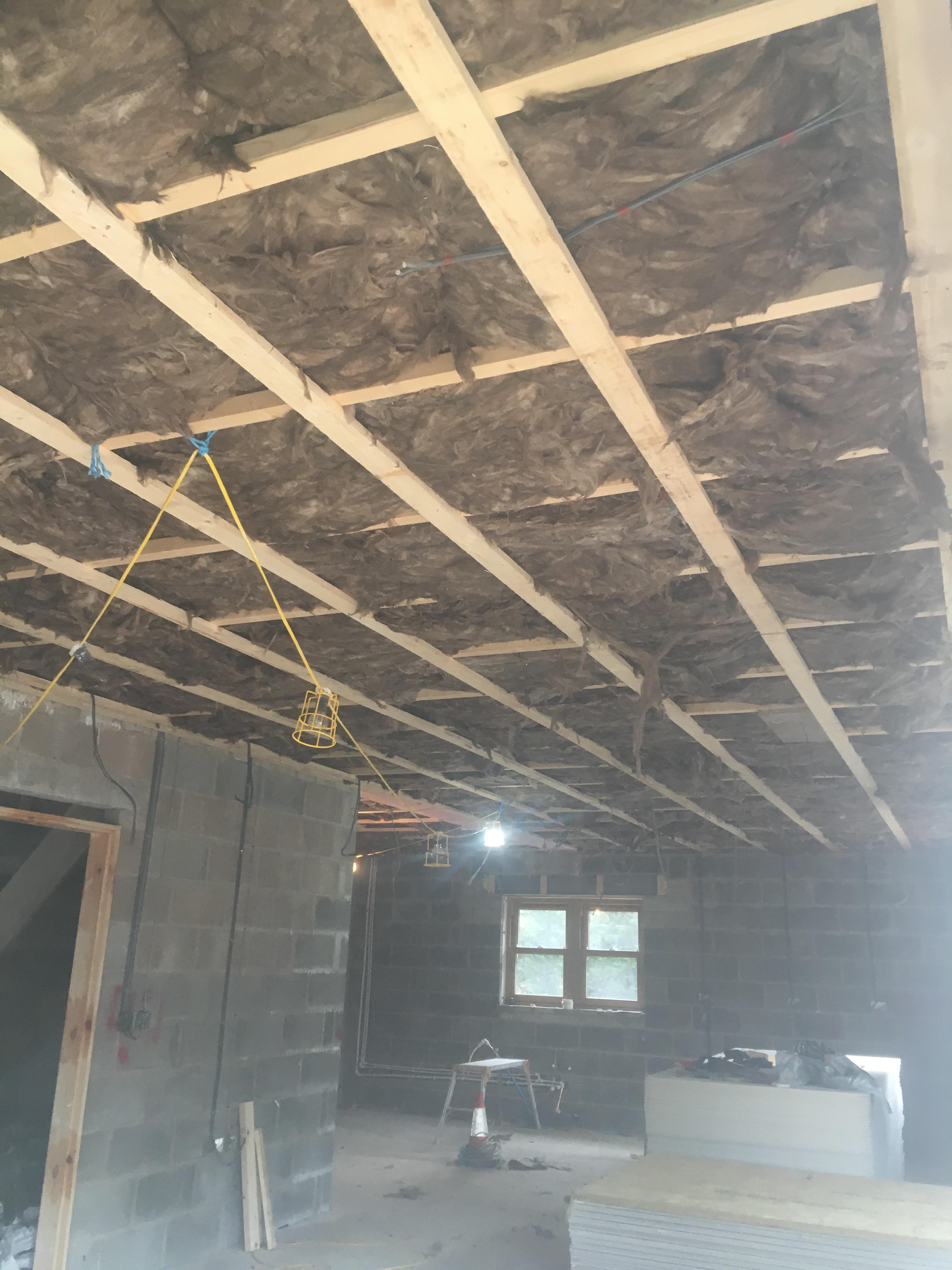

epsilonGreedy Posted November 23, 2020 Share Posted November 23, 2020 My roof design includes many metal joist hangers due to the hipped roof shape. This week's task is to fill in the hip corners with ceiling joists and this requires adding metal hangers to the non wallplate end of the infill joists. The concern I have is with the fitted height of these hangers, the options are: Position the hanger a couple of mm below the bottom of a truss so that as the wooden joist is supported by the cup of the hanger the joist meets the truss at exactly the same level or... Position the height of the hanger so that the bottom of the metal hanger cup is flush with the bottom of the roof truss with the result that the ceiling joist meets the truss a few mm to high. Option 1 seems technically correct but will this result in bumps in the finished plasterboard as the protruding hanger cups distort the plasterboard? Link to comment Share on other sites More sharing options...
nod Posted November 23, 2020 Share Posted November 23, 2020 I usually counter baton the trusses and floor joists with 70x25 mil sawn cut This sorts out the bumps that the joist hangers leave and give you a better fixing for the PB Also it helps to stop floor joists creaking Link to comment Share on other sites More sharing options...

epsilonGreedy Posted November 23, 2020 Author Share Posted November 23, 2020 12 minutes ago, nod said: I usually counter baton the trusses and floor joists with 70x25 mil sawn cut This sorts out the bumps that the joist hangers leave and give you a better fixing for the PB Also it helps to stop floor joists creaking Ah so for the loss of just 25mm of ceiling height this creates a nice wide 75mm target to aim the pasterboard fixing screws at? "Counter baton" means fixed at 90 degrees to the line of the roof trusses I assume? Link to comment Share on other sites More sharing options...
epsilonGreedy Posted November 23, 2020 Author Share Posted November 23, 2020 I have enough ceiling height on the ground floor to adopt the counter baton idea but upstairs things are a bit tight. Upstairs joist to floorboard is 2353mm from which I need to subtract 15mm for plasterboard, another 18mm for the wooden floor and now another 25mm for the counter batons = 58mm. Is 2295mm head height ok for upstairs? It feels low at the moment without any room stud walls to visually partition the whole space upstairs. Link to comment Share on other sites More sharing options...
nod Posted November 23, 2020 Share Posted November 23, 2020 (edited) 3 hours ago, epsilonGreedy said: Ah so for the loss of just 25mm of ceiling height this creates a nice wide 75mm target to aim the pasterboard fixing screws at? "Counter baton" means fixed at 90 degrees to the line of the roof trusses I assume? If you look to the left I would of had the same problem with a row of hangers either side of the steel and the same to the right (Out of shot ) Edited November 23, 2020 by nod Link to comment Share on other sites More sharing options...
