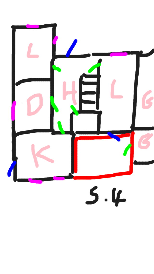

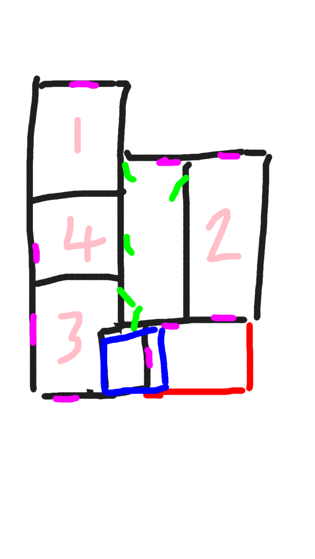

RoseD Posted November 22, 2020 Posted November 22, 2020 Afternoon everyone I’m enjoying reading everyone’s posts on here. We’re just starting to plan our extension haven’t received advice from anyone at all yet but wanted to do an intro and ask a general question. I’ve added my drawings which are not to scale - I’ve also drawn what I want things to look like on sketch up but couldn’t work out how to add them here. Green lines are internal doors, blue external doors and pink lines are windows. The red area is the planned extension which actually comes out further than the kitchen line which I’ve not depicted in the pics! The pic with letters is the downstairs and numbers upstairs with the bathroom marked in black - and my idea in blue to extend it. I don’t think this will be possible though because to save costs I’m thinking it’s best we keep the external wall that’s already there. Which leads to my first question. Can an external wall be stripped of the external bricks and made into an internal wall? My second complete beginner question I think I know the answer to also - the downstairs already has a conservatory over half the area for the extension that leads to the garage. So the garage wall is where the extension wall would need to be up against - I’m assuming that means we’ll have to knock down the garage wall. Hopefully not the whole garage though and then the extension wall could replace the garage wall. We have a waste manhole in the area too so will need to move it further into the garden and the toilet is on the window wall of the bathroom so would have to be moved to the outside wall. We’ve had the water pipe plans and spoken to the correct utility company so know this is possible. And the downstairs loo will have to be moved into the extension to stay accessible to the waste. extension will be 5.5x5.5m with the aim of giving us another bedroom and en-suite. I wanted a bigger main bathroom but unless I take some of bedroom 3 I don’t think that will be possible. Thanks for reading all of this :-) I’m in the excited research stage - I’m sure that will morph into stress once we start! I also have some roof questions but still looking myself at how we might do this first - the current roof is in a T shape
DevilDamo Posted November 22, 2020 Posted November 22, 2020 Do you have any existing floor plans, even if they are the agents’ plans for when you bought the property? You may be able to find these via Rightmove or Zoopla. Do you have or can you take and upload some photos, which will also help? I’m pretty sure SketchUp designs can be saved into various formats of which are supported here. So just save them as JPG’s or PDF’s. When are you looking to engage an architect/designer? What is your budget, assuming it’ll be in excess of £120k?
Russell griffiths Posted November 22, 2020 Posted November 22, 2020 Not sure what you mean by turning an external wall into internal, you would normally just plaster over the bricks so it becomes internal. You dont sort of take half half of it down to make it thinner, it stays there as it’s holding the roof up, you just hide it.
RoseD Posted November 22, 2020 Author Posted November 22, 2020 30 minutes ago, Russell griffiths said: Not sure what you mean by turning an external wall into internal, you would normally just plaster over the bricks so it becomes internal. You dont sort of take half half of it down to make it thinner, it stays there as it’s holding the roof up, you just hide it. thank you - that’s a perfect solution. I wasn’t sure if there was any reason why you couldn’t leave it there.

DevilDamo Posted November 22, 2020 Posted November 22, 2020 2 hours ago, Russell griffiths said: You dont sort of take half half of it down to make it thinner, it stays there as it’s holding the roof up, you just hide it. If it’s a cavity wall and where space is tight, no harm in removing the external skin and taking the wall back to the external face of the internal skin.
