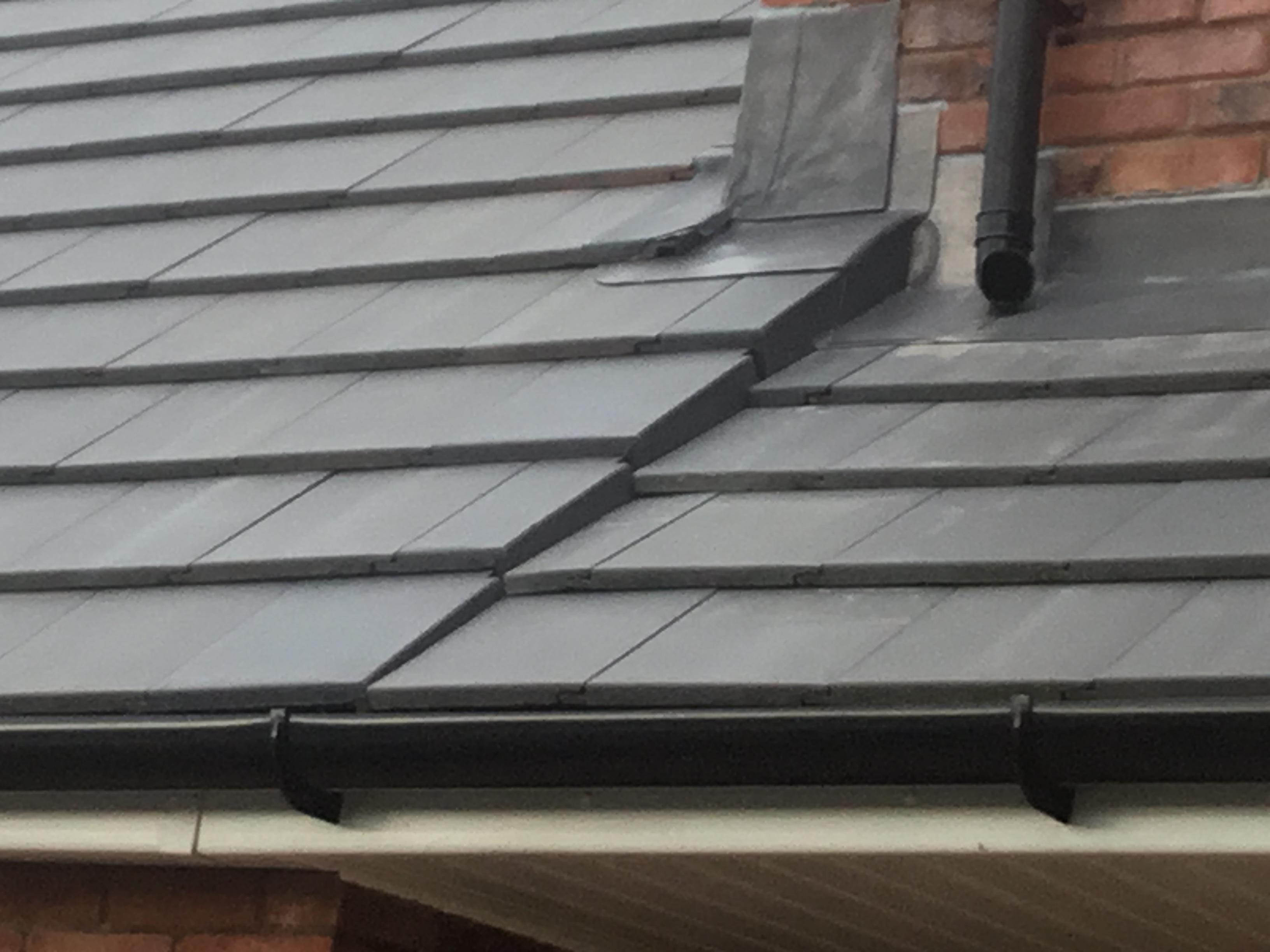

On 10/12/2020 at 16:26, Tomfromsurrey said:
Maybe this is whats needed. Dry Valley, equal depth at the lower end, and unequal depth at the upper end so deeper on the right top.
Image is a bit of a quick drawing, but you get the idea. That would need to be bespoke in GRP I assume. something made with lead and battens would probably do the job.
Better that what is there now.
So this is the original transition on the roof. It has taken 2.5 years to get the developer to fix it. It wasn’t until I designed the way to fix it that it got done. I purchased cloak verge tiles, and the developers had their roofer install them. See the attached photo of the finished result. There is a lead tray to the gutter beneath the cloak verge
