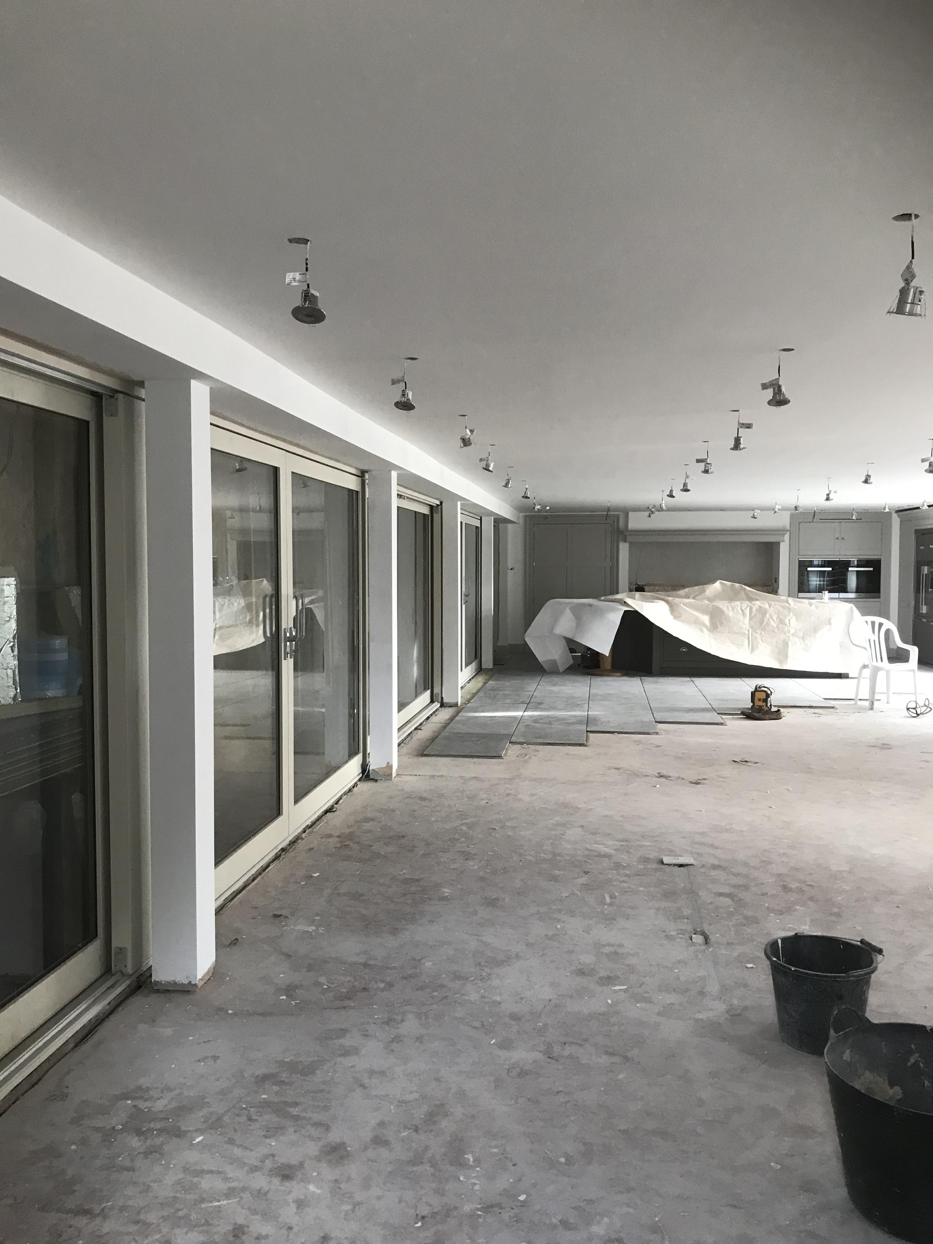

nod Posted November 16, 2020 Share Posted November 16, 2020 Most seem to be doing that quite a few banks pulling funds We are on one today 6000 sq foot Trying to sell as is Link to comment Share on other sites More sharing options...
