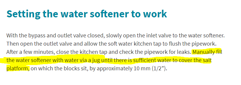

I don't have any user/install instructions apart from what I have found on the web. So having installed all pipework, turned off bypass valve and opened up the valve to the unit, I can hear twin tanks fill, but then starts squirting out of the fill valve ( the pipe thing mounted on the side, between the two tanks.). Is that supposed to happen? I'm guessing not as instructions state the water softener compartment should be filled manually with a jug of water:
So I imagine if the above instructions are correct, then my unit should not be filling up! Video attached to show the water running out of fill valve below. I turned the water off in case this isn't supposed to happen!
Is it perhaps in regeneration mode (see first pic)? Or perhaps an o-ring needs replacing in the fill valve? Or as it's a float valve it will stop filling when the desired water level is reached?

I think the manual suggests filling with water manually to start because the water can sometimes be orange from the new resin before you flush it. Filling it manually prevents the orange water going in the salt tank and you thinking there is a fault.

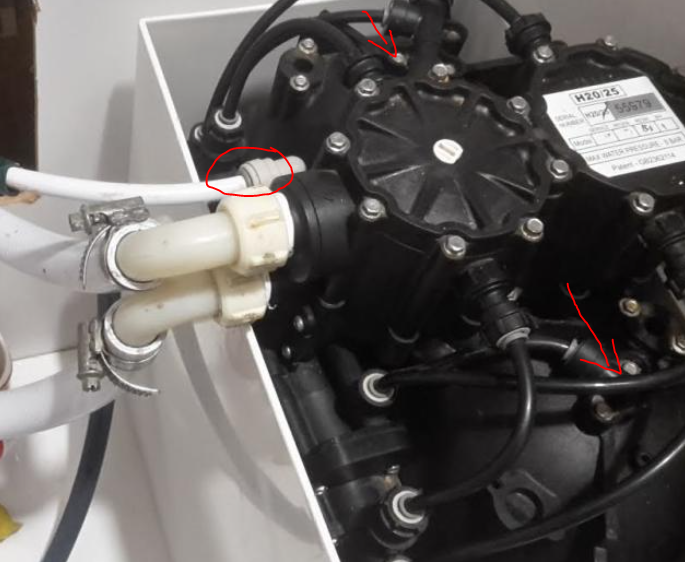

2) The pipe's that dripping is the 3/8"waste pipe from the 'shuttle valve' mechanism (see pic). I've done another manual rejen to see whether that make's any difference. Worth changing it for another mechanism? Or could it be a valve in the timing mechanism which isn't quite closed?
3) Yes, the salt decay has also slowed down
I've just tested the water and it's bloomin' hard! So I guess that indicates the resin bed has been damaged/needs changing? I read somewhere that you need to turn off the water to the unit de-pressurise by turning the rejen button and the unscrewing the top 2 screws on each tank (see arrows in pic)? If the beads spurt out, I need new resin!
I may just keep it as a spare and see if I can pick up a reconditioned unit!
