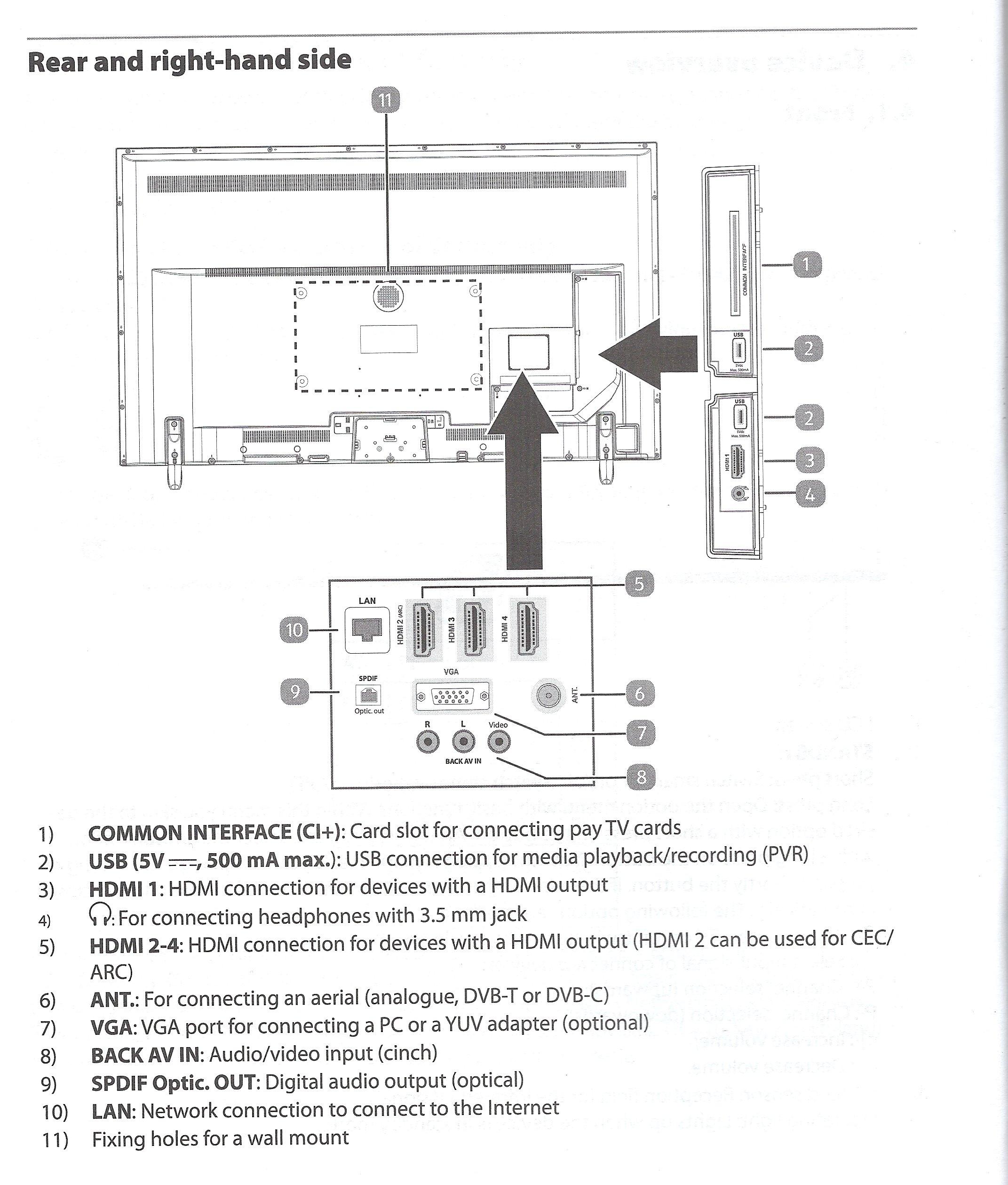

These are the TV connections:

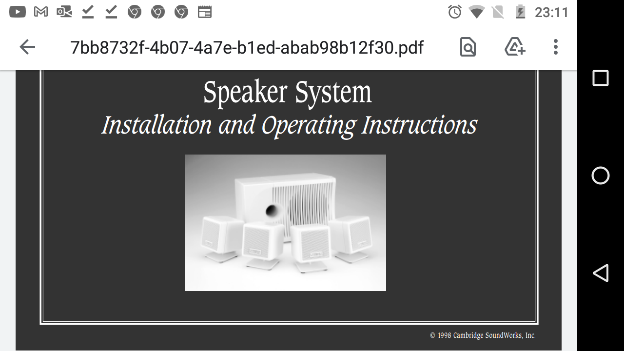

I just happen to have an old Cambridge Soundworks 4 Point Surround Sound kit. Sounded pretty good back in the day on the old pc. It's all now discoloured off white but nothing a quick spray with some plastic primer and satin black won't sort!

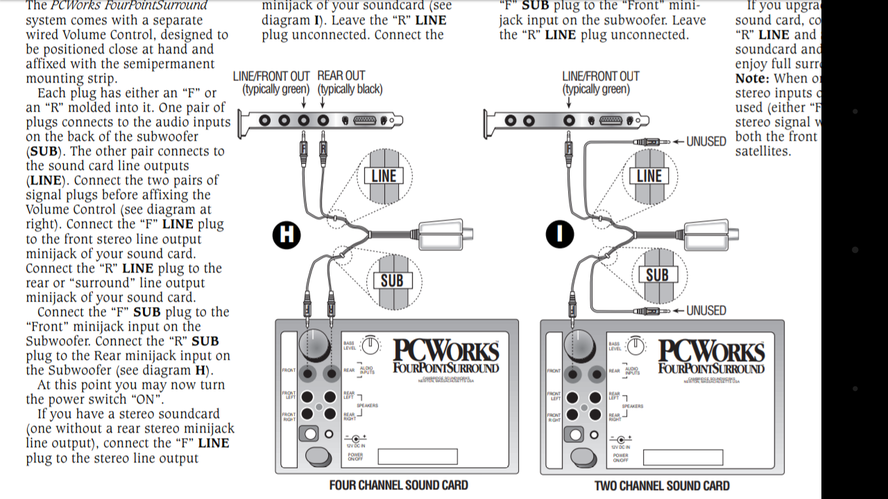

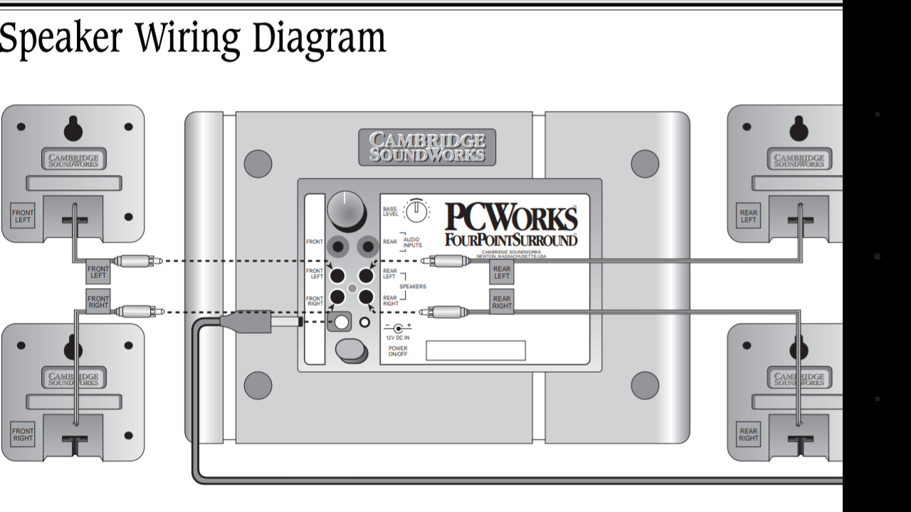

These are the connections:
How best to connect the TV? Taking the analogue, stereo headphone output to feed the 4 point seems a bit too simple. I have SPDIF optical out and HDMI as options.
Any magic box that'll go between the two?
Cheers

If you want "something" to come out of all four speakers, I'd suggest split Left to feed F-L and R-L, and Right to feed F-R and R-R. Make sense?
12 hours ago, Onoff said:
This kit consists of a powered subwoofer and 4 satellites. Is it 4:1, 4.1:1? Really not sure. A Googling I go to find out!
It is "nothing.nothing" , as the 5.1 style notation is about the surround compression codec decoding and your 4-point has no codec decoding. It has 4 channel analog input (F-L, F-R, R-L, R-R) and presumably constructs its own sub channel from a combination of FL & FR (and maybe rear too?)
Thus the decoder would need to decode to 4.0 in order to create exactly four channels that your 4-point requires as input.

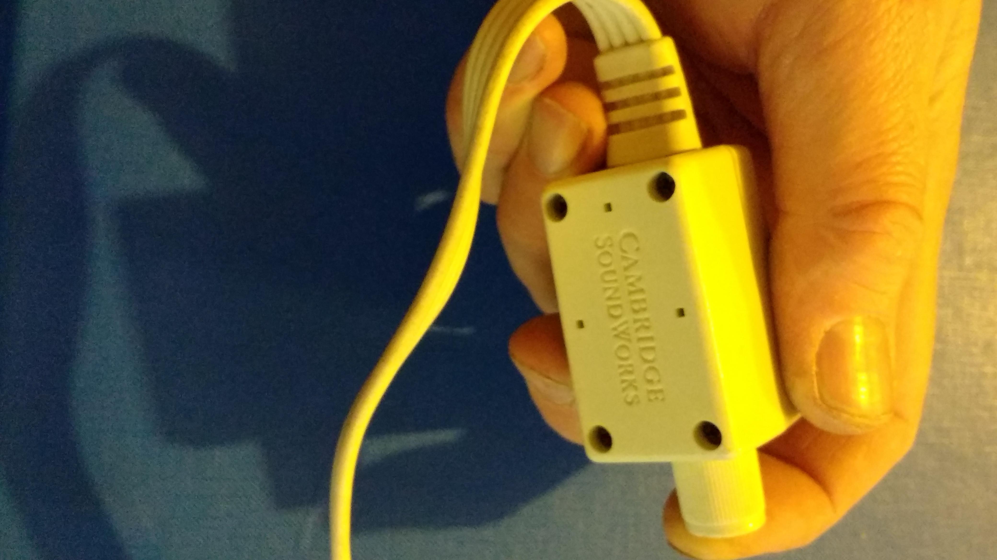

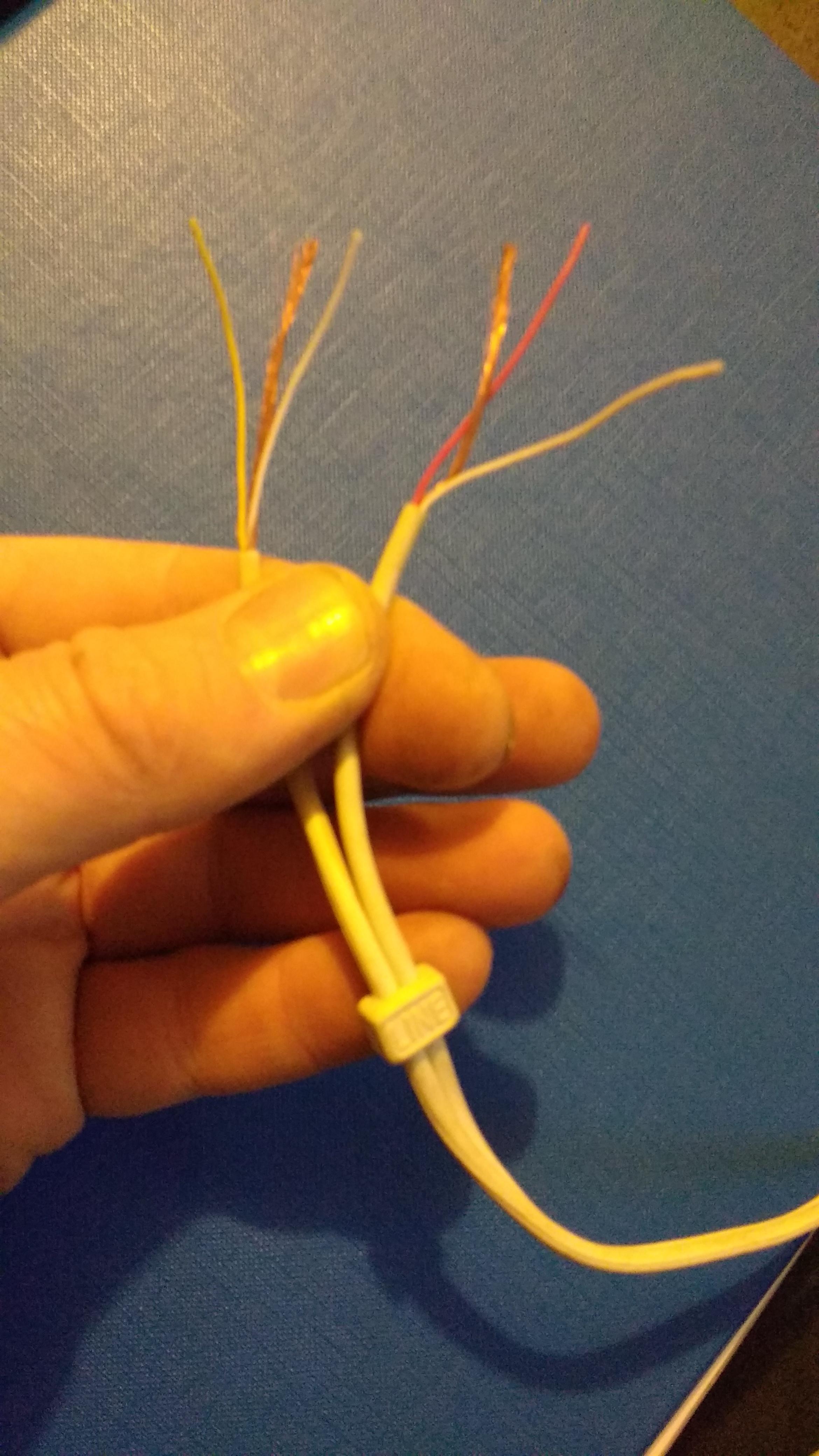

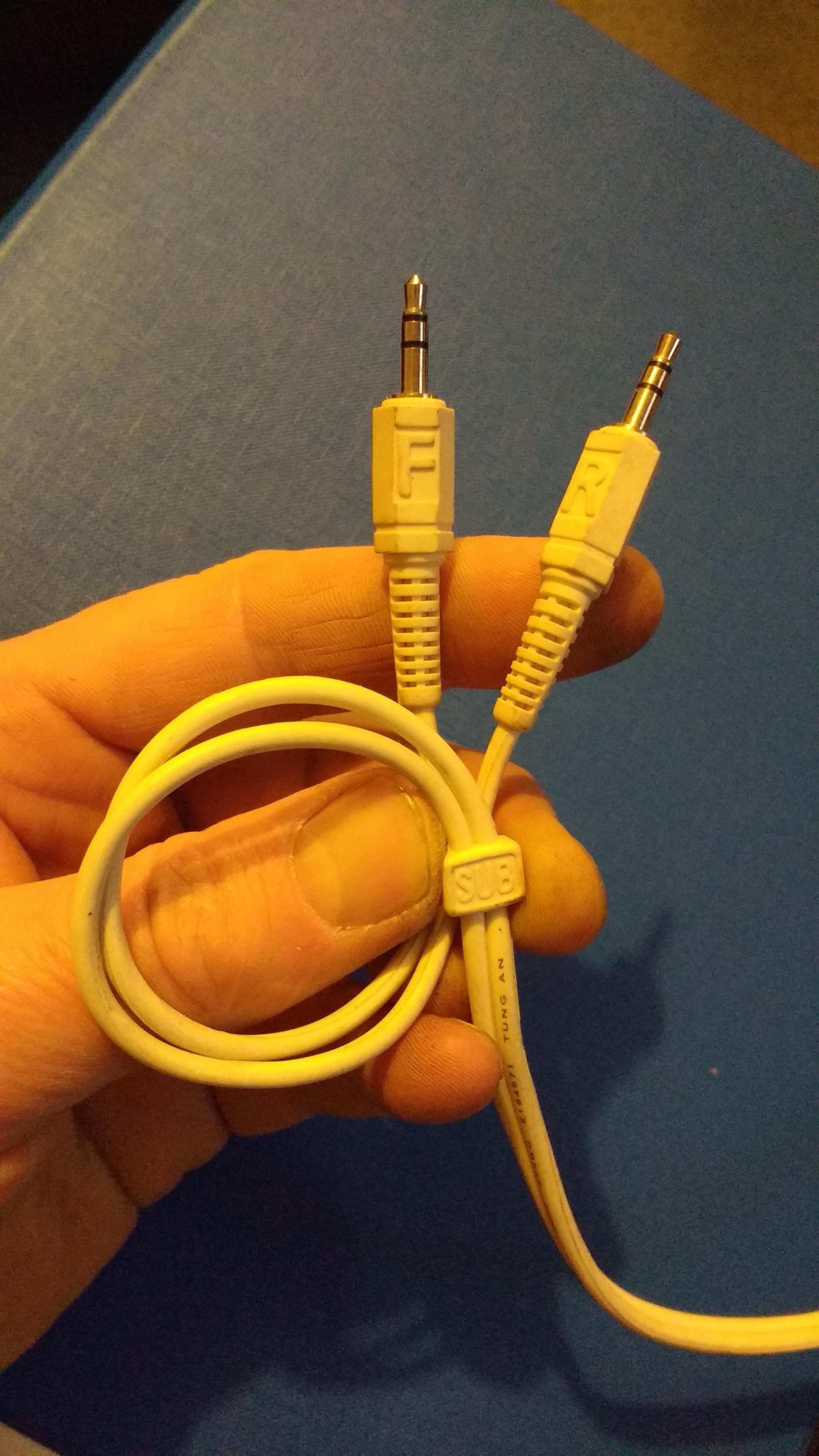

Managed to find all the bits. However, some idiot ? cut off the two line plugs years ago to use for something else no doubt...
They should look like the SUB connection:
So "he" now has to trace out what wire's what from the 4-gang pot!
27 minutes ago, joth said:
Do you need the inline volume control?
If not just grab a couple of 3.5mm jack to jack cables and ditch that thing.
https://www.amazon.co.uk/Zerist-Braided-Premium-Auxiliary-Smartphones/dp/B07SZT58P1
Not sure. Would it be to maybe attenuate the headphone output into the amp?
I'm just going to meter it out and chuck a 3.5mm stereo plug on one of the bare ends and plug in as though a 2 channel sound card.

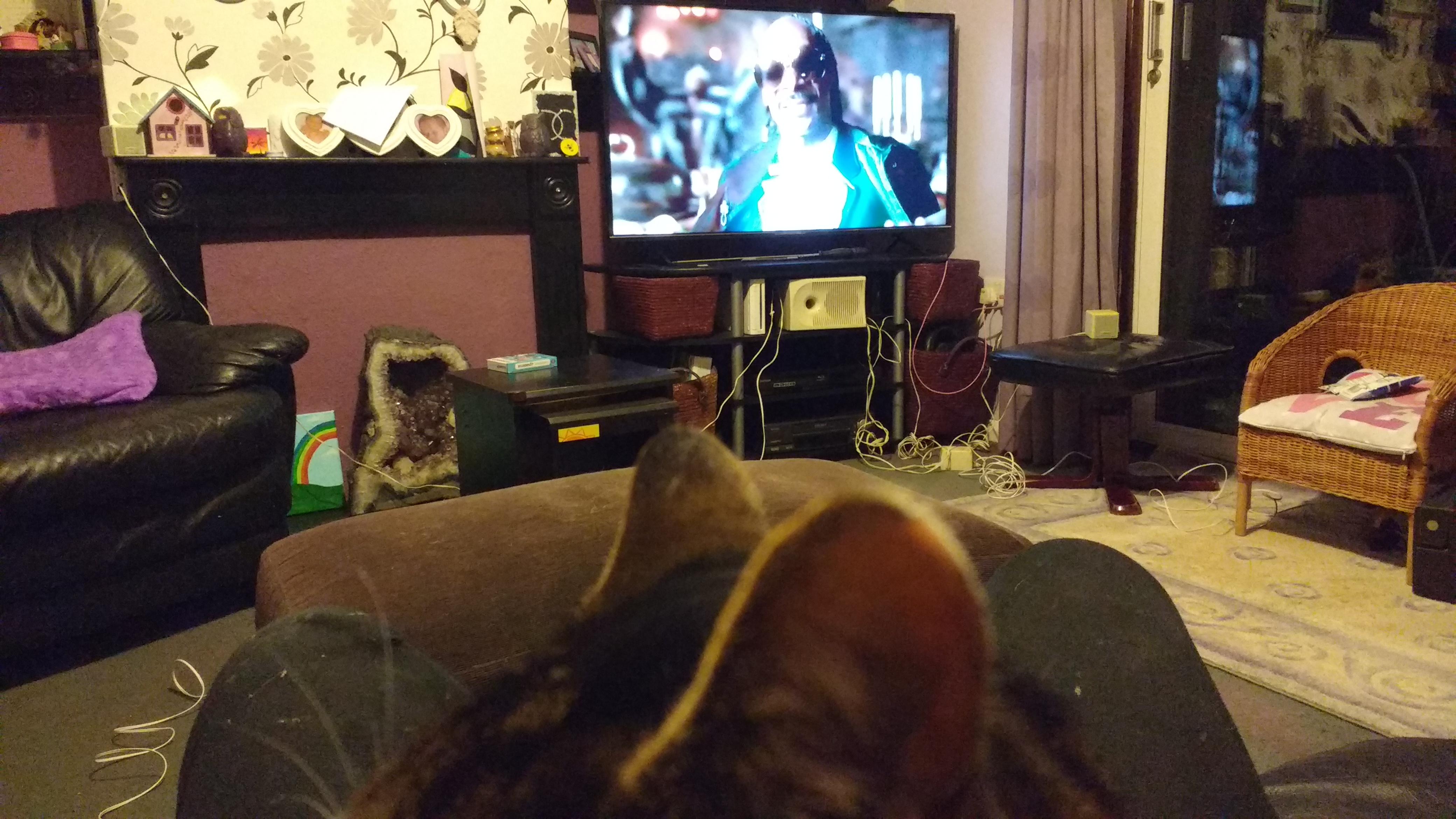

Just used a straight 3.5mm to 3.5mm lead from telly to speaker. Sounds surprisingly good! Need some satin black spray paint for the speakers and to hide the wires!
Call me Mr Cheapseats, oh yeah!
Edited by Onoff

Cheers. Cat shot out of the room when I first turned it on.
Going through the TV sound menu and I first had the 3.5mm output set to LINEOUT. Beyond deafening and then some!
I've set it on HEADPHONE ONLY now and it's controllable. I wonder if LINEOUT would be better in any way? I'd need that 4-gang pot between the TV and amp I reckon though.

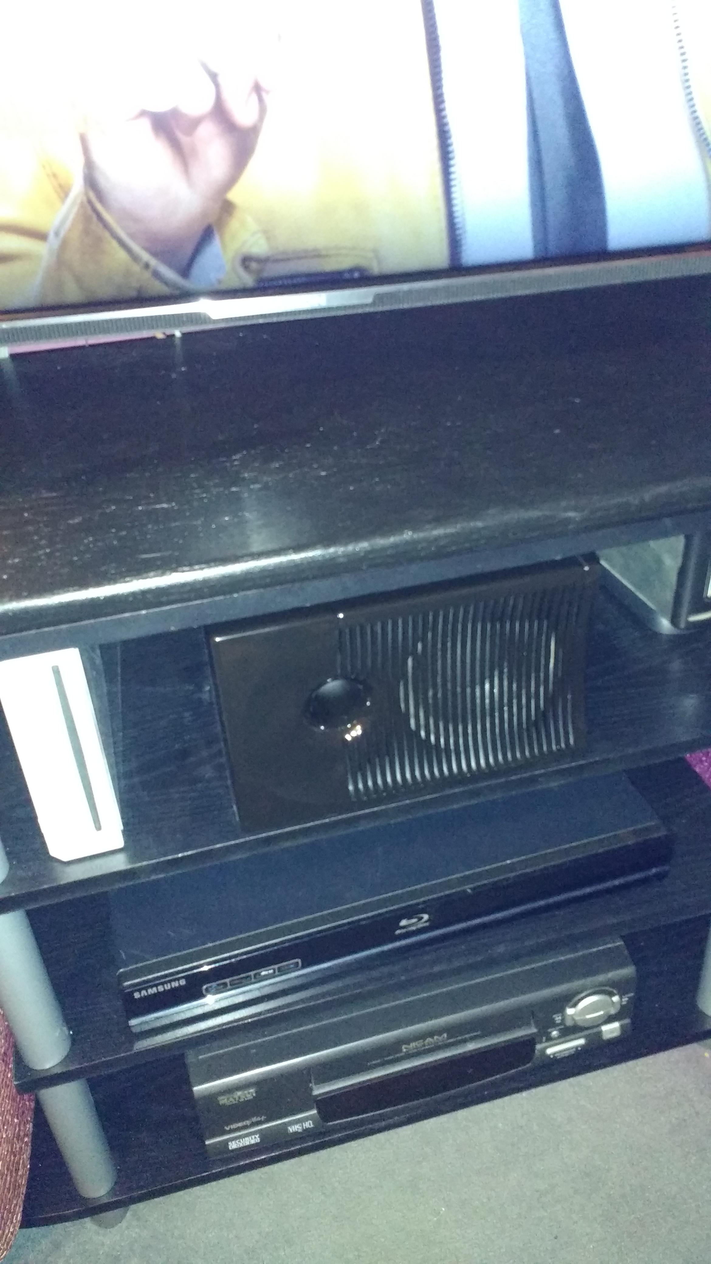

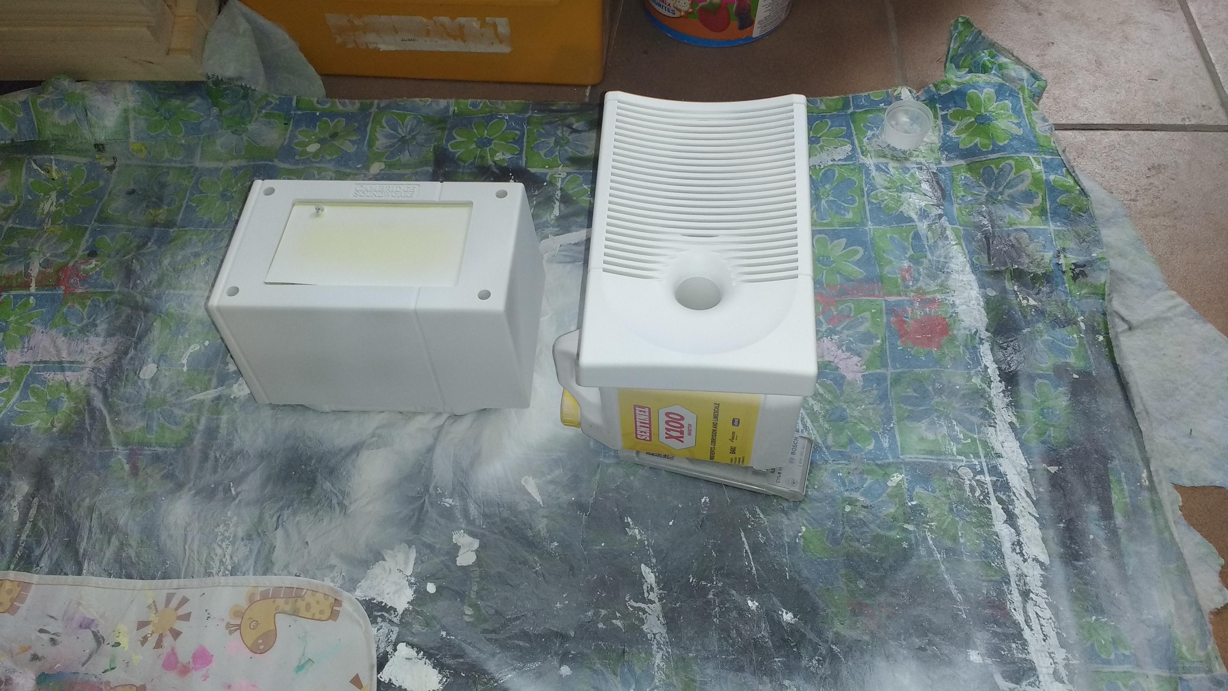

Paint it black...well, plastic prime it first:
Some black spray later...looks better than in the photo...
