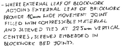

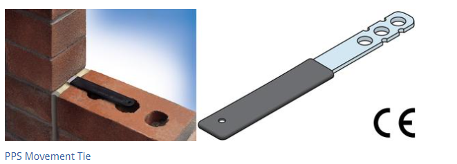

MortarThePoint Posted October 4, 2020 Share Posted October 4, 2020 Our design has some brickwork that adjoins rendered blockwork in the same elevation or at corners. The Structural Engineer has called for movement joints here: I presume that calls for the likes of the sleeved tie below, some form of foam strip and then a mastic seal on the outside. If that's correct, can anyone recommend a good foam strip to use (suggestion below) and give any guidance as what to look out for on installation? https://www.buildbase.co.uk/ancon-safetyended-movement-10367-2801192 https://www.buildbase.co.uk/fillcrete-brickfill-100x10mm-10351-2801693 Link to comment Share on other sites More sharing options...
nod Posted October 4, 2020 Share Posted October 4, 2020 It’s exactly that Link to comment Share on other sites More sharing options...
LA3222 Posted October 4, 2020 Share Posted October 4, 2020 Yarp...pretty simples. You need a load of wall ties in as well either side of the expansion joint. I filled the joint on mine with a load of white silicone, render bead went over that and then all covered with render. 1 Link to comment Share on other sites More sharing options...

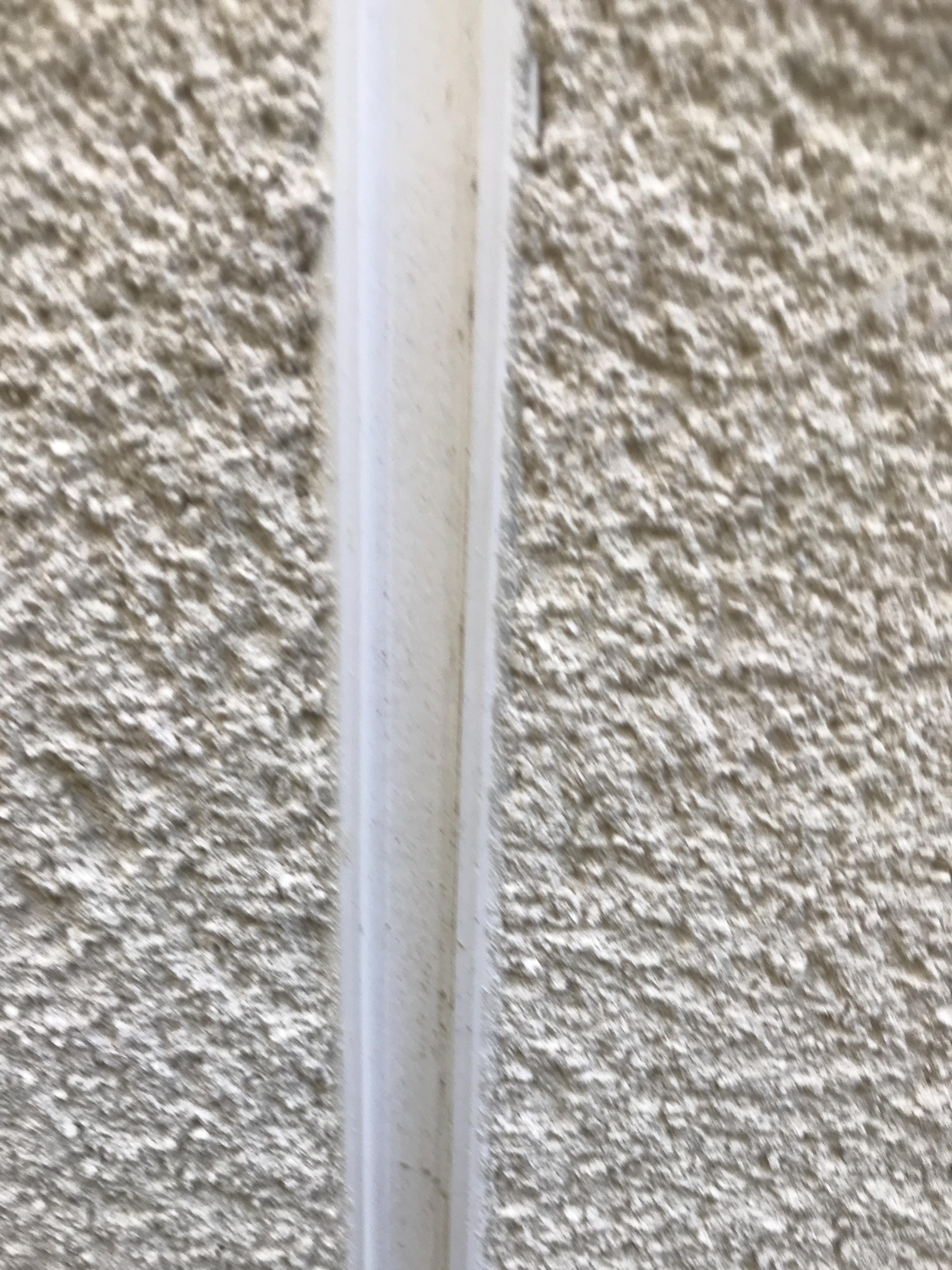

nod Posted October 4, 2020 Share Posted October 4, 2020 1 hour ago, nod said: It’s exactly that 1 Link to comment Share on other sites More sharing options...
MortarThePoint Posted October 5, 2020 Author Share Posted October 5, 2020 14 hours ago, nod said: That looks really smart @nod , is that some kind of plastic strip either side of mastic? Link to comment Share on other sites More sharing options...
LA3222 Posted October 5, 2020 Share Posted October 5, 2020 34 minutes ago, MortarThePoint said: That looks really smart @nod , is that some kind of plastic strip either side of mastic? Nope. That is a plastic render expansion joint placed over the blockwork expansion joint and then rendered over. Gives a nice clean finish for the render. Link to comment Share on other sites More sharing options...
MortarThePoint Posted October 5, 2020 Author Share Posted October 5, 2020 4 minutes ago, LA3222 said: Nope. That is a plastic render expansion joint placed over the blockwork expansion joint and then rendered over. Gives a nice clean finish for the render. Cool thanks. Does that go in at the rendering stage then? A product suggestion would be good as it always helps to see what the finished result looks like. Link to comment Share on other sites More sharing options...

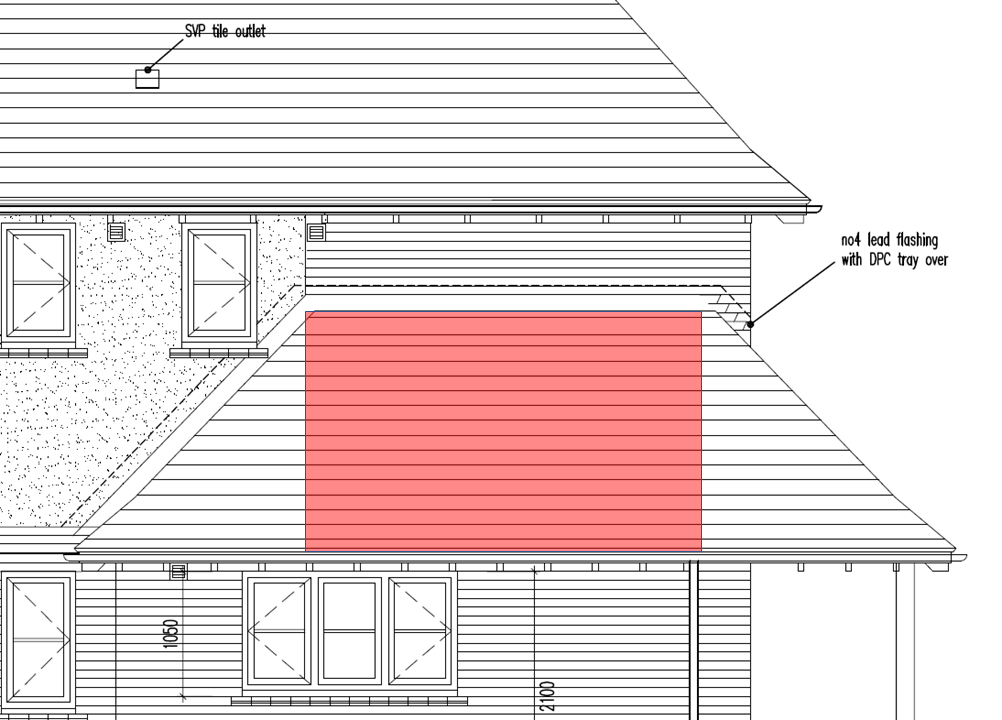

MortarThePoint Posted October 7, 2020 Author Share Posted October 7, 2020 We've got a single storey utility room at the side of the house and there is a section of brickwork wall above it. I was wondering whether the area shaded in red in the image below should to be brickwork of blockwork. This area is on the side of the main house. The SE have called for a movement joints between the external leaf blockwork and brickwork. This red area sits above the blockwork in the wall between the kitchen and the utility room. I guess the options are: Blockwork: if this is the case what should the expansion joint(s) be. Should there be a full height movement joint going up the left hand side of the red area and between the brickwork and blockwork above, as well as a movement joint on the right hand side of the red area? Is a movement joint not needed on the right (and in fact a bad idea) because the blockwork there is within the roof space and therefore not external. There is brickwork over the top of the blockwork and any possible movement joint on the right. Brickwork: I guess this would just be a full height movement joint going up the left hand side of the red area and between the brickwork and blockwork above. Blockwork is easier to install obviously. Link to comment Share on other sites More sharing options...
