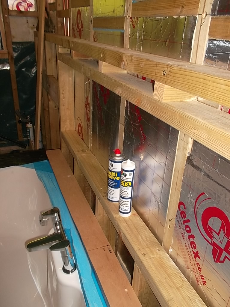

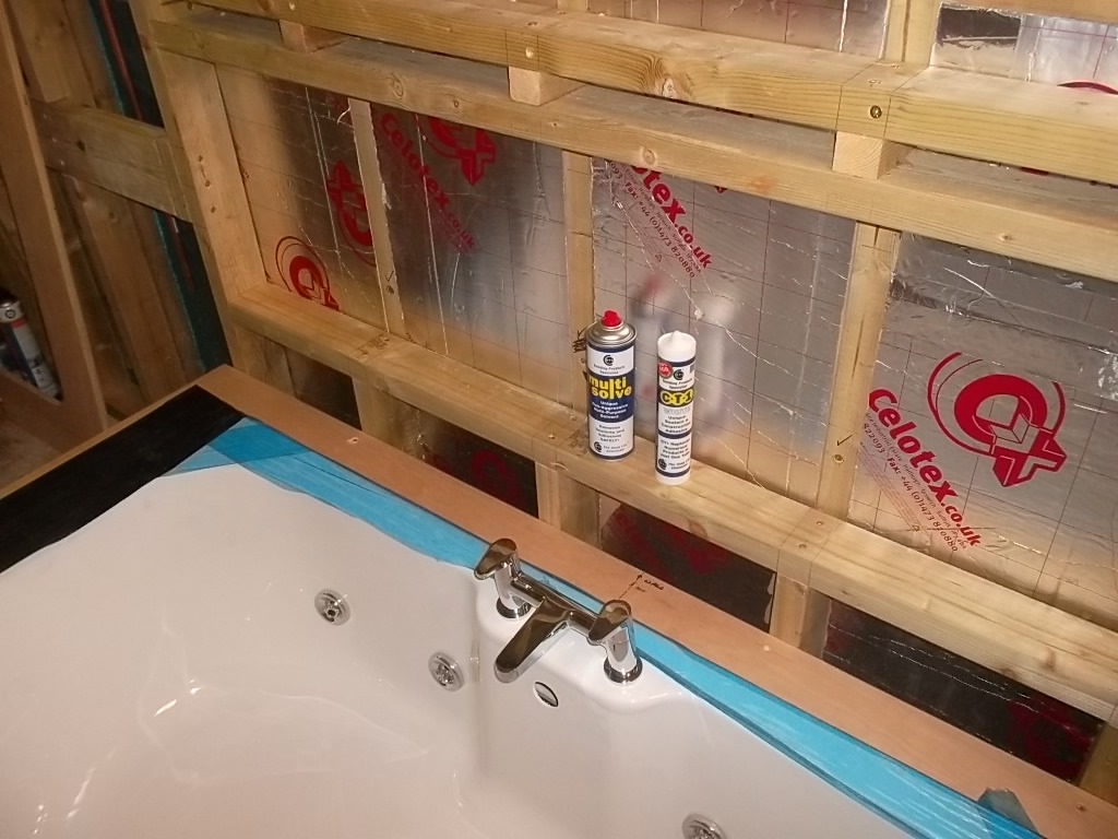

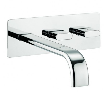

Onoff Posted May 28, 2016 Author Posted May 28, 2016 (edited) With hindsight I might have ordered the bath without the tap holes drilled in and had a wall mounted bath filler something like this: I don't think I could live with blanking off the existing tap holes either and going wall mounted. Half toyed with having a wall mounted tap and fitting a couple of waterproof lights in the tap holes. Might look a bit naff though? Where the drill is and the UFH sensor pipe will be a boxed in "riser". You can just see the pump motor behind: Did consider rotating the bath 180deg and having the taps on the outside but we don't want that. I'd also have to cut a slot in the slab for the pump motor bracket and then I'd hit the UFH pipes. Access as it is is v.tight to get to the pump / motor so if there's any issue the bath'll have to come out anyway. Then I'll be glad of the flexibles. Just to complicate things (), on the outside edges of the bath I'm considering raking the timber frame back so the tiled sides are at an angle. Back to the piping issue. This is looking along from where the pipes come down from the wall: It's all a bit tight and there is no way I'll be able to get to these connections once the bath is in: Edited May 28, 2016 by Onoff
Onoff Posted May 29, 2016 Author Posted May 29, 2016 Better shot of the taps.The CT1 and Multisolve are sitting on the recessed shelf to simulate where the wine glass will go:
Nickfromwales Posted May 30, 2016 Posted May 30, 2016 Couldn't you still ditch the taps for a combined overflow filler? Hot and cold taps but no spout?
Onoff Posted May 30, 2016 Author Posted May 30, 2016 34 minutes ago, Nickfromwales said: Couldn't you still ditch the taps for a combined overflow filler? Hot and cold taps but no spout? Thanks, I'd forgotten about that as an option! Still got the pita of getting to the "tap" connections if they leak or to replace once it's all in though. Picked at random but that downward pointing tube on some of these looks ideally positioned to catch your knee etc: http://www.heatandplumb.com/acatalog/Ultra_Quest_Bath_Filler_Side_Valves_Chrome.html?utm_source=google&utm_medium=Shopping&gclid=CPnWso23gc0CFRYTGwodCHYM1w Really got to decide on these pipes asap to move on. With hindsight I might even have cut a big square access "hatch" through the cavity wall behind but then that would have meant major disruption to the adjacent room, removal of bookcases etc.
Nickfromwales Posted May 30, 2016 Posted May 30, 2016 Easy tiger. I really, really think you need a chill pill on the access issues. Once the bath is in you'll never see them again. How about putting isolation valves in the attic and just coming down and going direct? I do this for a living and personally dislike isolating valve on baths and showers as they tend to restrict the flow a bit plus I can't ever think where they would have been 1) necessary or 2) handy when it's just a 2 second job to knock the mains off and drain down. The overflow fillers do stick out a bit and your bath is quite pronounced there so maybe just go for the overflow there ( deep breath ) and find a way to connect to the water jet system so it backfills through them ( I'll get my tin hat ready ). Only problem will be washing goop out but if you tee into that somehow it might be quite cool. You'd need additional double check valves for protection against cross contamination but just a thought.
