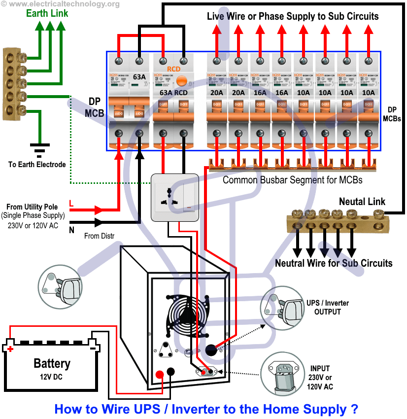

NotJustin Posted November 3, 2020 Author Share Posted November 3, 2020 I now have a 48v inverter, the seller tells me that it connects right at the mains, before my distribution box. Does anyone know how this gets wired up? I'm going to get an electician to do it, but I feel I need the info before that. Thank you. Link to comment Share on other sites More sharing options...
NotJustin Posted November 3, 2020 Author Share Posted November 3, 2020 Found this: Link to comment Share on other sites More sharing options...

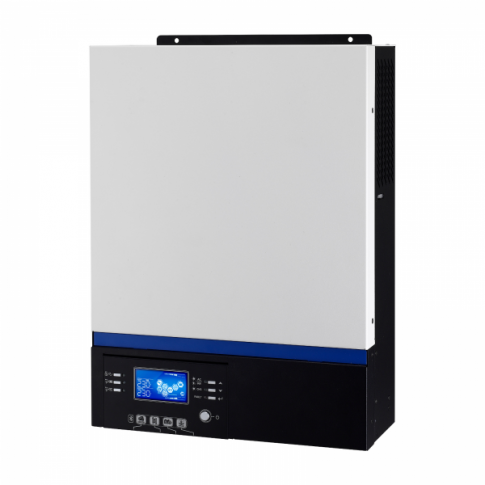

NotJustin Posted November 3, 2020 Author Share Posted November 3, 2020 this is the imverter https://www.photonicuniverse.com/en/catalog/full/449-Iconica-5000W-48V-hybrid-pure-sine-wave-inverter-with-4000W-solar-input-80A-500V-MPPT-solar-controller-60A-mains-battery-charger-and-inbuilt-Bluetooth-No-battery-required.html Link to comment Share on other sites More sharing options...

NotJustin Posted November 3, 2020 Author Share Posted November 3, 2020 I now have one of these: https://www.photonicuniverse.com/en/catalog/full/449-Iconica-5000W-48V-hybrid-pure-sine-wave-inverter-with-4000W-solar-input-80A-500V-MPPT-solar-controller-60A-mains-battery-charger-and-inbuilt-Bluetooth-No-battery-required.html It's just wiring it into the system I am unsure about Link to comment Share on other sites More sharing options...
NotJustin Posted November 3, 2020 Author Share Posted November 3, 2020 1 hour ago, Dave Jones said: https://www.victronenergy.com/inverters/phoenix-inverter-smart Is this for the connection diagrams? Link to comment Share on other sites More sharing options...
