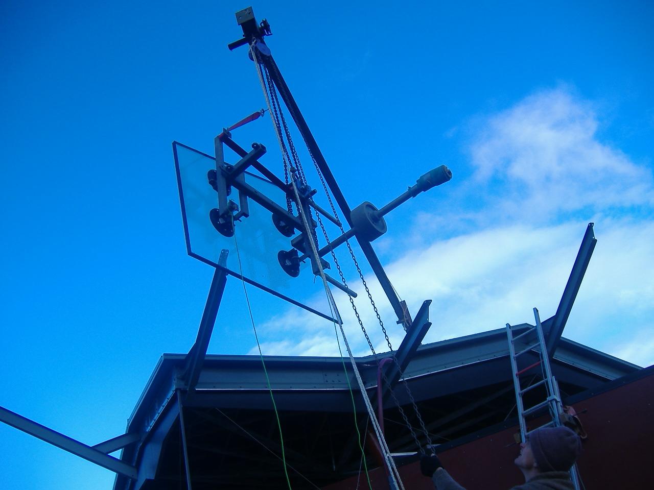

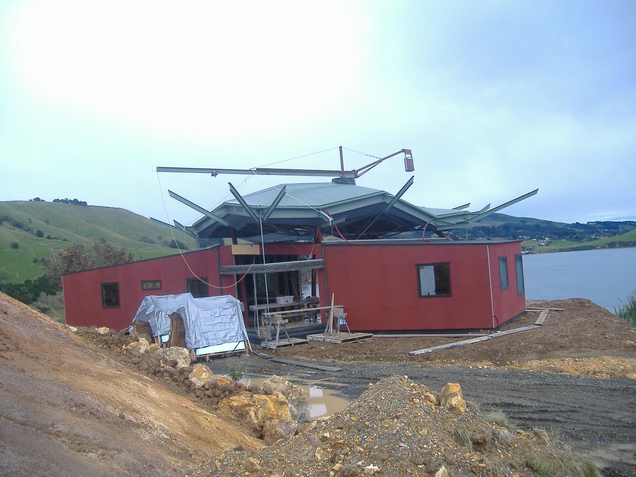

Onoff Posted September 19, 2020 Share Posted September 19, 2020 A fella I used to work with here and in NZ built his own place over there...and his own crane to do it with... He's said it's still in the long grass at the back of the house and I'm welcome to come and get it! ? Link to comment Share on other sites More sharing options...

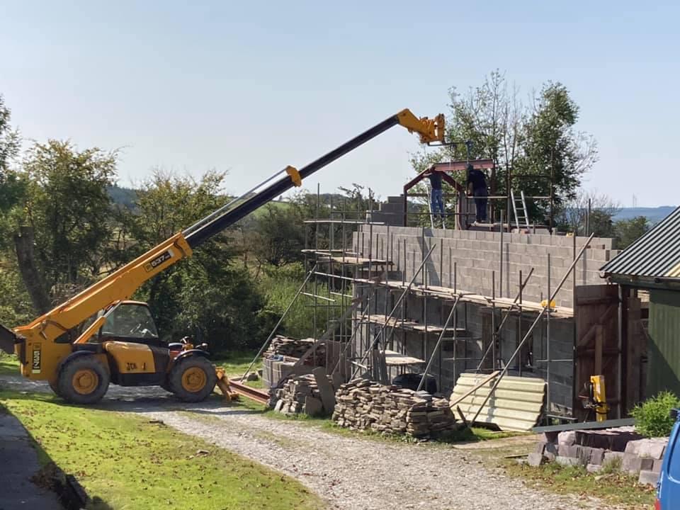

Puff Posted October 24, 2020 Share Posted October 24, 2020 I hired one of these to put up the steel ridge beams on my build. Longest beam was 5m and was 31kg/m so 150kg. Floor to apex is 6m and its another 1.5m to ground level at the end in the picture. I'd never driven one before but it was an absolute doddle to get them in place. Recommend using a 2-way radio if you can! Link to comment Share on other sites More sharing options...

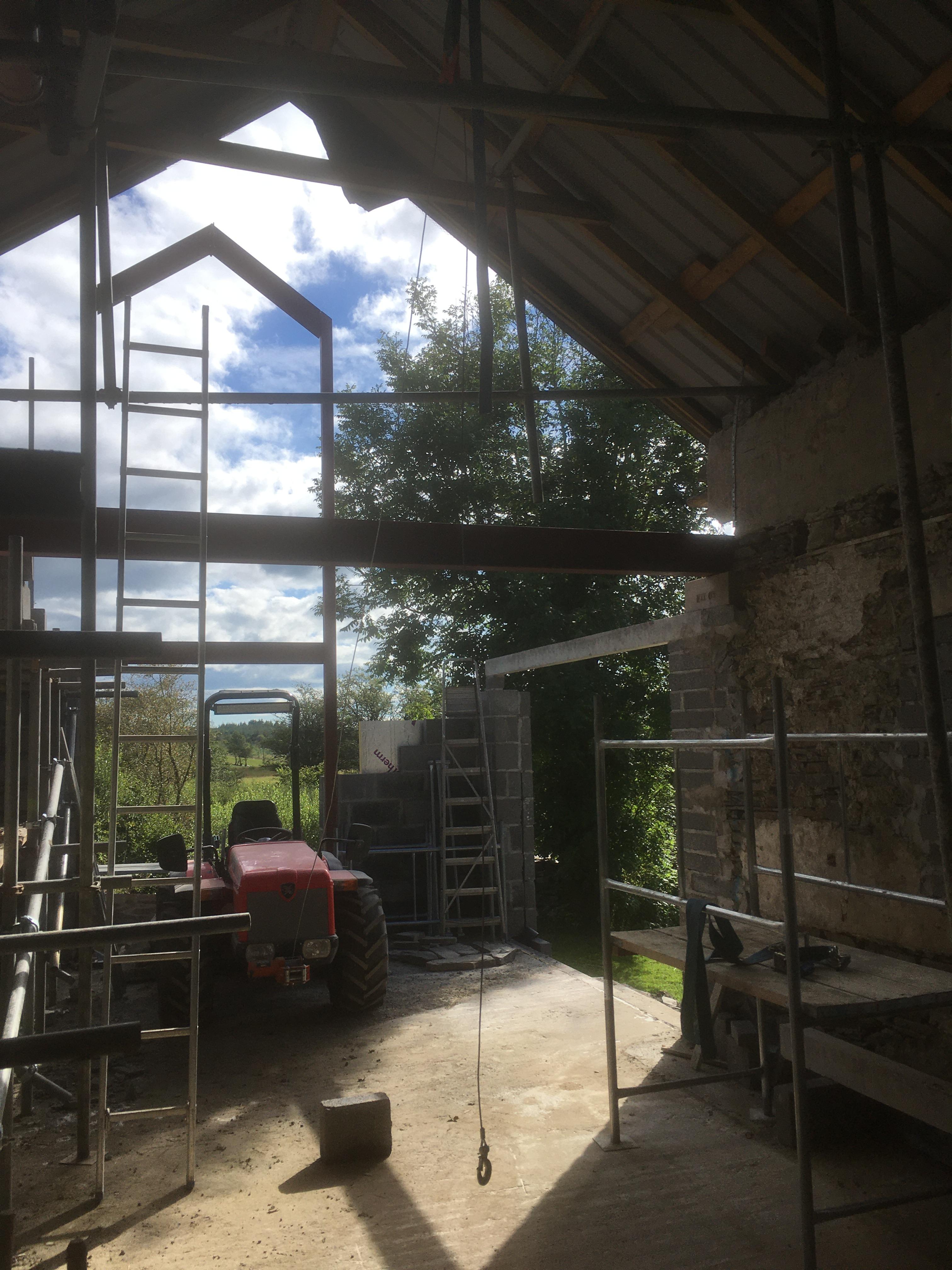

Puff Posted October 24, 2020 Share Posted October 24, 2020 Alternatively... 4.5m of 30kg/m using 1 ton winch on the tractor and braced scaffold frame but that only had to raise 2.5m Link to comment Share on other sites More sharing options...
