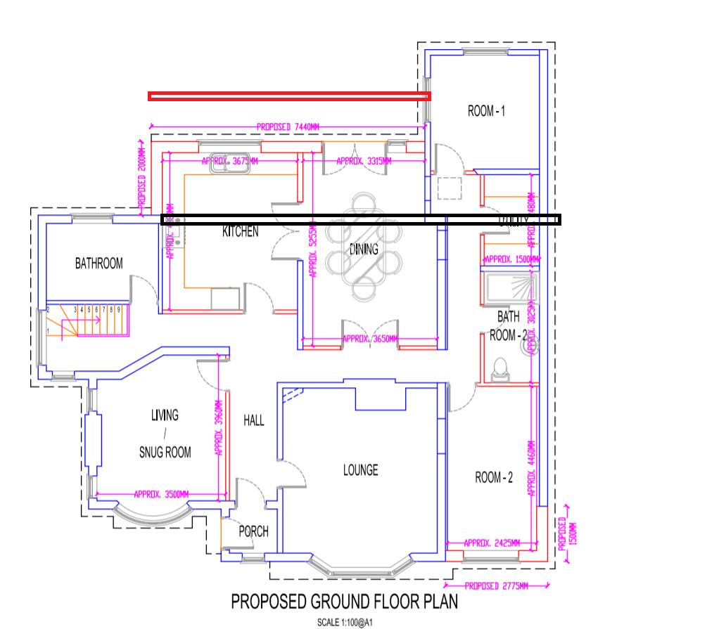

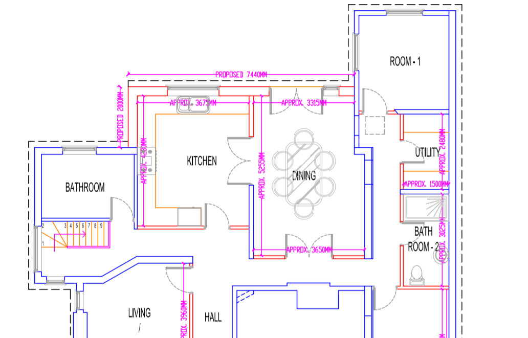

Gina_Violet Posted September 18, 2020 Share Posted September 18, 2020 (edited) Hi, We have detached chalet bungalow and about to start work on a single story back extension. In the plans signed off by the council the architect has stated its width is approx 2meters and I would like to go 2.6 now. There are no neighbours with 10meters either side of the work. I sent an email to the council and received a generic email about ammendment submissions. But doesn't this come under permitted development? We applied for full planning permission as we were doing work on the front and roof of the house, but those are not happening yet as we focus on the rear extension instead. Below is the plan f, with the 2000mm back extension (Room 1 was extended 4 meters by the previous owners). Is that an issue going any further back that requires full permission? Thanks Edited September 18, 2020 by Gina_Violet Link to comment Share on other sites More sharing options...
Temp Posted September 18, 2020 Share Posted September 18, 2020 (edited) I think your 2.6 x 7.4m would need full planning permission because the 7.4m part is more than half the width of the original house. Edit: Actually I think we need to know the exact outline of the original house before ANY extensions were made and if any were added after getting planning permission or were they all done under permitted development. Edited September 18, 2020 by Temp Link to comment Share on other sites More sharing options...

Gina_Violet Posted September 20, 2020 Author Share Posted September 20, 2020 Hi, Thanks @Temp and @DevilDamo The black line I have added is is the original back of the house, no idea if room 1 was done under permitted development as it was so long ago I can't find a trace of it on the planning site. The rest of the right side is a garage conversion (as in room 2 and the bathroom part) done long ago, Link to comment Share on other sites More sharing options...
DevilDamo Posted September 20, 2020 Share Posted September 20, 2020 On that basis, the extension you are proposing would normally be considered PD as it would come under the 4m deep rear extension guidelines. Link to comment Share on other sites More sharing options...

Temp Posted September 21, 2020 Share Posted September 21, 2020 I agree. Normally permitted development provided not more than half the original garden has been built on nor would it be within 7 meters of the rear boundary. 1 Link to comment Share on other sites More sharing options...
