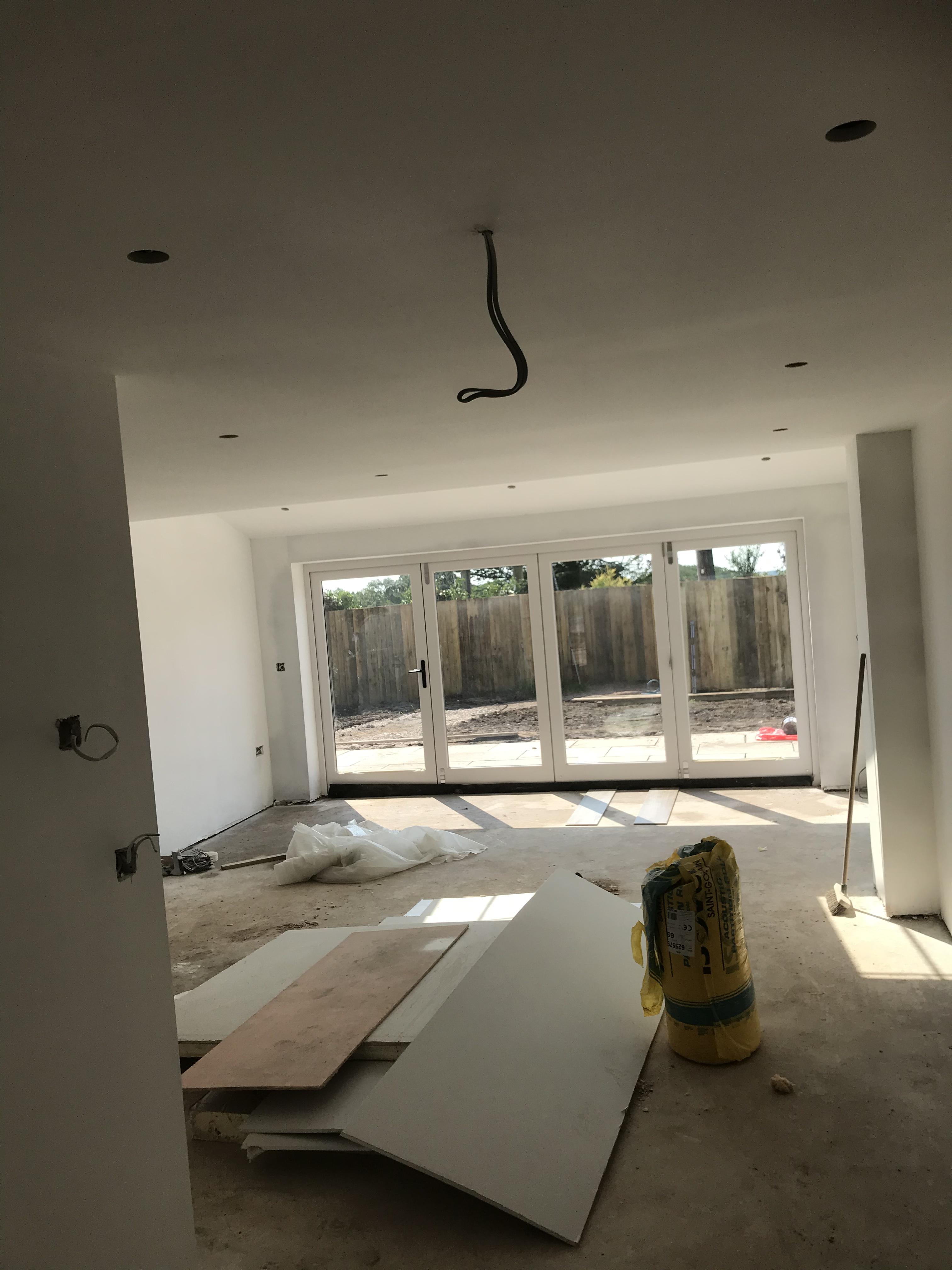

nod Posted September 16, 2020 Posted September 16, 2020 The problem you have with lintels If there’s not much above them they are likely to move Anything over 2ntrs I used a steel with a hit and mis plate For one skin a steel is perfect Especially with bifold This is one of three that I’ve just fitted 1

Joe87 Posted September 16, 2020 Author Posted September 16, 2020 7 hours ago, PeterW said: OK so which way do the roof joists run ..?? If they land on the lintel then there is a huge load, if they are parallel then the load is negligible. That affects the size of the beam. The roof joists would be running away from the lintel not across it. So if the lintel is left to right then the joists would run backwards from it. I did forget to say aswell that the opening has an end pier on each side of it. So two dense concrete blocks laying face down and then two side by side to make the end pier. So the area the lintel would rest on would be about 215mm rather then the 100mm of the block edge. I hope that makes sence, my explaining of these things is not great. 7 hours ago, nod said: The problem you have with lintels If there’s not much above them they are likely to move Anything over 2ntrs I used a steel with a hit and mis plate For one skin a steel is perfect Especially with bifold This is one of three that I’ve just fitted How big was this opening Nod in the image? It looks good. Do you have an example of what you would use over a 4 meter span, like a website link or something? Sorry to be a pain. Thanks! I appreciate the help

nod Posted September 16, 2020 Posted September 16, 2020 1 hour ago, Joe87 said: The roof joists would be running away from the lintel not across it. So if the lintel is left to right then the joists would run backwards from it. I did forget to say aswell that the opening has an end pier on each side of it. So two dense concrete blocks laying face down and then two side by side to make the end pier. So the area the lintel would rest on would be about 215mm rather then the 100mm of the block edge. I hope that makes sence, my explaining of these things is not great. How big was this opening Nod in the image? It looks good. Do you have an example of what you would use over a 4 meter span, like a website link or something? Sorry to be a pain. Thanks! I appreciate the help 4 mtr
nod Posted September 16, 2020 Posted September 16, 2020 1 hour ago, Joe87 said: The roof joists would be running away from the lintel not across it. So if the lintel is left to right then the joists would run backwards from it. I did forget to say aswell that the opening has an end pier on each side of it. So two dense concrete blocks laying face down and then two side by side to make the end pier. So the area the lintel would rest on would be about 215mm rather then the 100mm of the block edge. I hope that makes sence, my explaining of these things is not great. How big was this opening Nod in the image? It looks good. Do you have an example of what you would use over a 4 meter span, like a website link or something? Sorry to be a pain. Thanks! I appreciate the help The handy thing I find with a steel is that you can jack the frame up tight against the underside and know it will never move The four that we fitted a few weeks back and the one on my house have no adjustment So you are relying on Toe and healing the glass Any movement and the doors won’t open Our structural engineer refers to lintels as his bread and butter jobs and hates any lintel over 2000 mil 1
