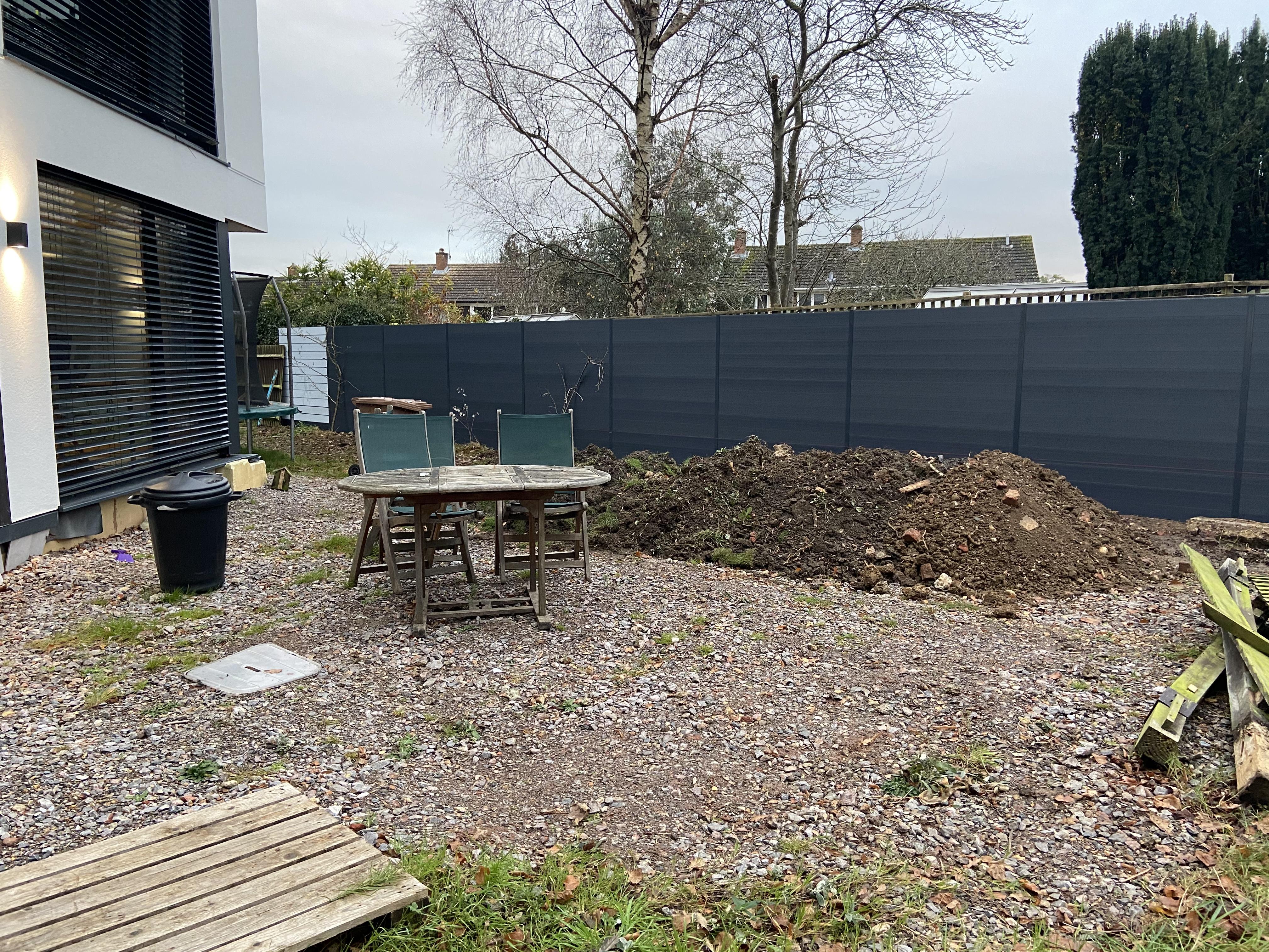

Weebles Posted December 6, 2020 Author Share Posted December 6, 2020 We bit the bullet and went for some composite in the end. With aluminium posts. Love the look of it as it fits our modern build. Got some caps and a capping rail still to fit. Really pricey but it needs nothing more than a jet wash and I might do that whereas I’m not going to paint a fence every 2 years. @Ferdinand we did consider the graffiti risk. In fact our teenagers also said it. But it’s just as likely with a timber fence and we hope that it won’t be done. If it is then at least we won’t see it from our side (though I would be very cross) photo attached. I’m sure it will look even better when the paving and landscaping is done. 1 Link to comment Share on other sites More sharing options...

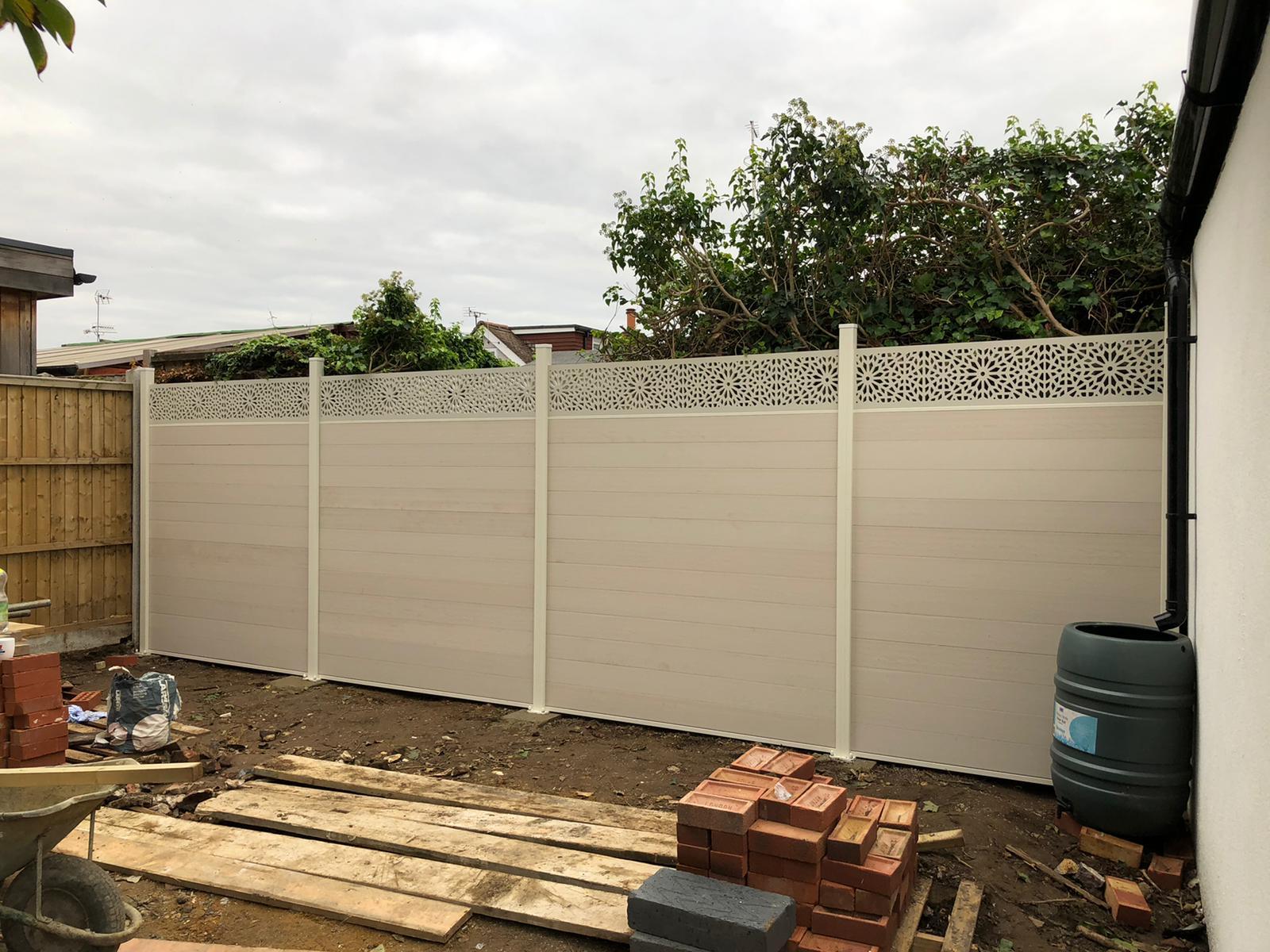

Donal Posted March 14, 2021 Share Posted March 14, 2021 hi Weebles, your fencing looks great ! We're planning to use composite fencing for our garden project and are finding it pretty tricky to identify good products/suppliers. Hopefully yeir new fence has withstood the recent gales ! Can I ask where ye purchased the composite fence or what product ye used Many thanks Donal Link to comment Share on other sites More sharing options...
Weebles Posted March 20, 2021 Author Share Posted March 20, 2021 Thank you. It’s still looking like new. It’s Durapost kit. Some good install videos and a very helpful customer service. We’ve got some spare bits if you are thinking of the same colour....... We are in South Oxfordshire - where are you? Link to comment Share on other sites More sharing options...
