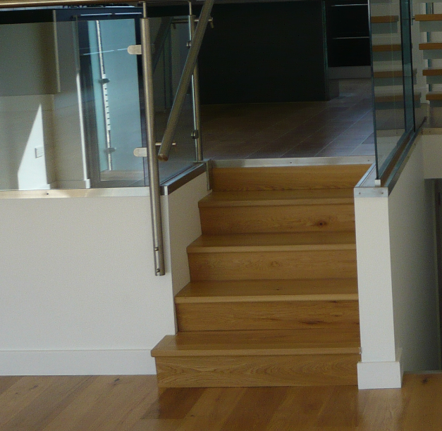

Yes the concrete stairs are expensive.  I have clad them in timber before and extra for glass balustraded and stainless handrail.  Also lining up treads with floor finishes can be tricky.  You often have to screed the hollowcore to take out the camber, as well as batten the underside for plasterboard.

The upside is no string - if you like the minimalist look.  These took ages to finish compared to a timber staircase but like you we had Bison in to do the floors so it was one less thing to consider and straight away we had safe access between floors.

We have no string timber stairs internally (basement set are more standard). They use a hidden fixing into the structural wall on one side.
