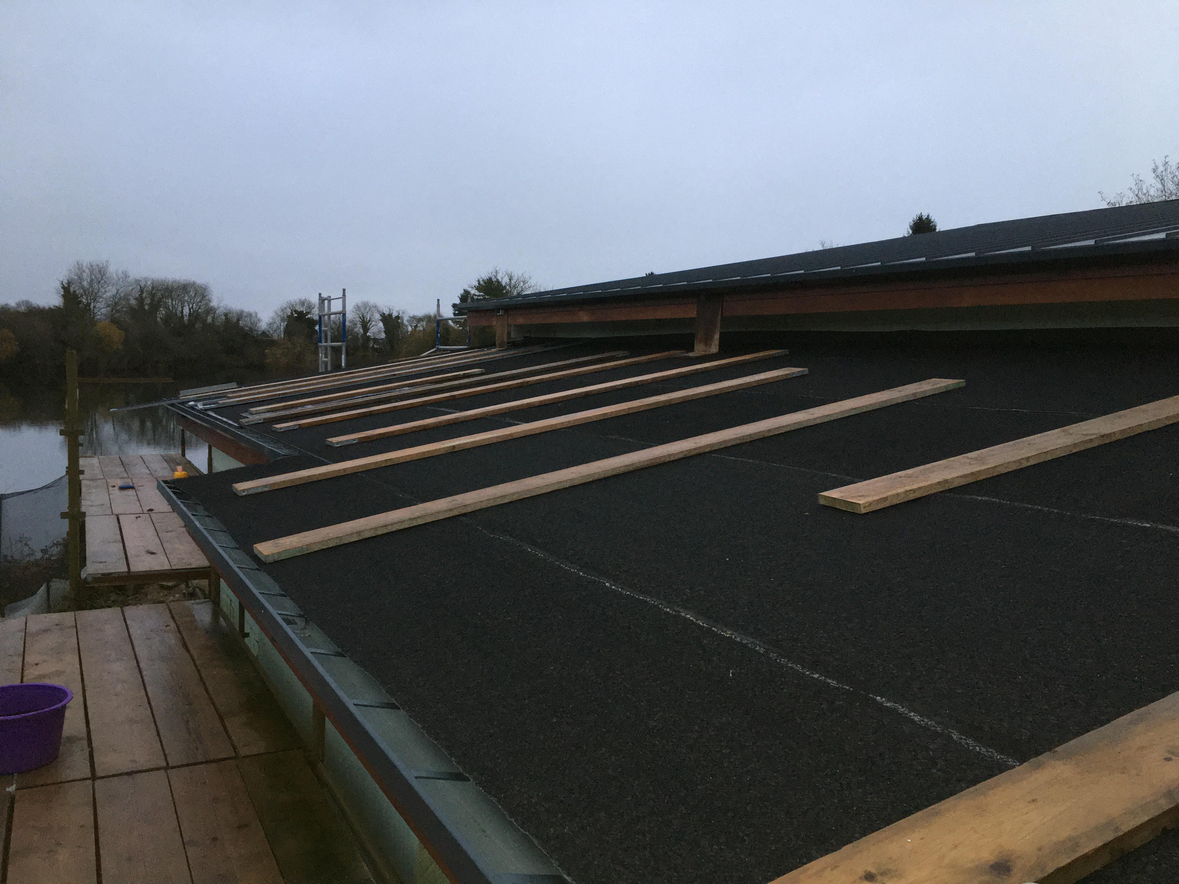

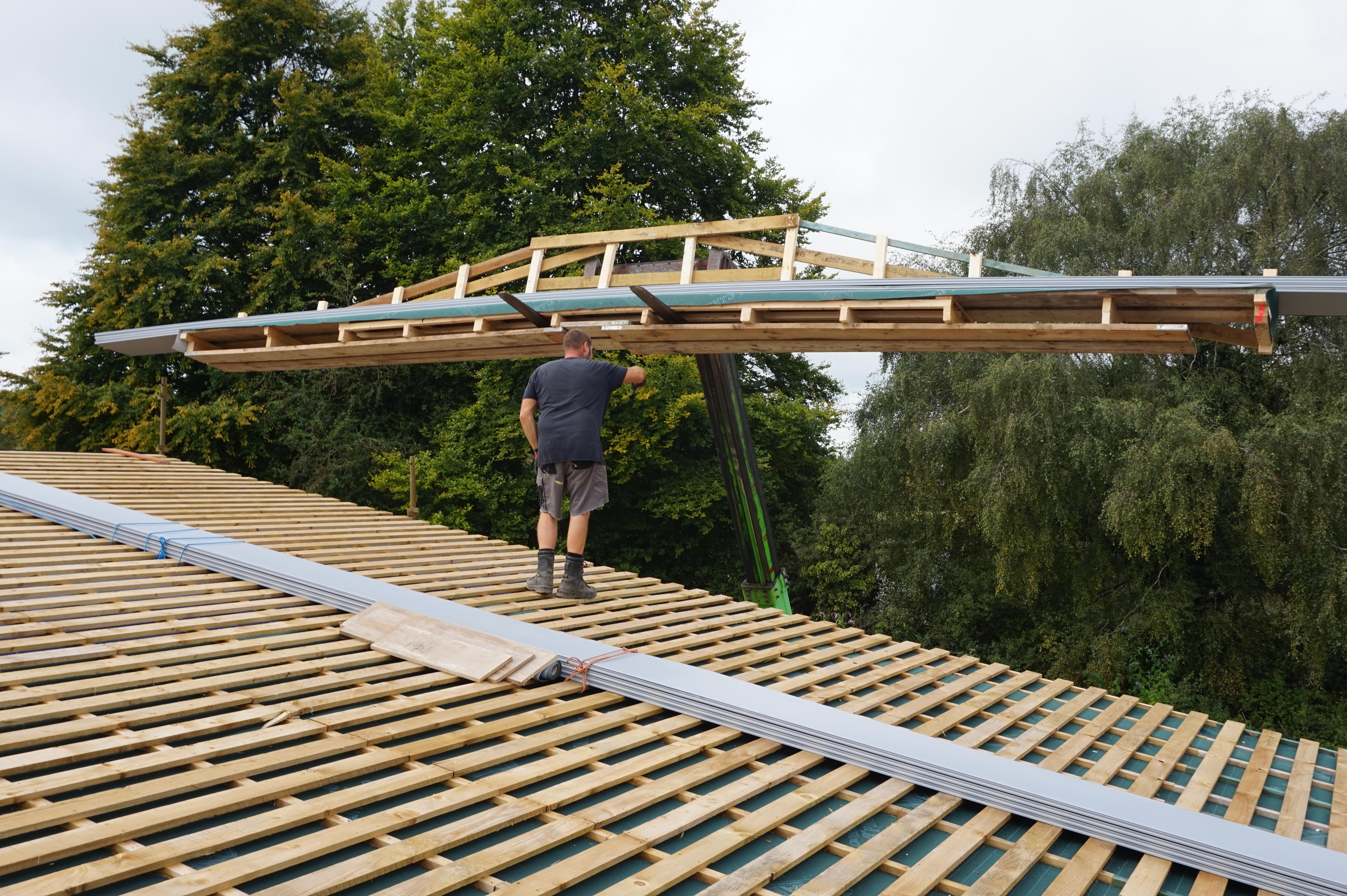

I have two lots of membrane, metal roof but similar,
membrane
counter batten,
sarking fitted hit n miss style
membrane
metal roof. FCE86DDF-6956-41C9-B98A-C94802278326.thumb.jpeg.e807087c7966a1545a0132cffc840bed.jpeg7B0270EB-1B03-4D72-B267-3F9FE313E04F.thumb.jpeg.01a2f154a11ced3f7d47612f5a75c3bb.jpeg

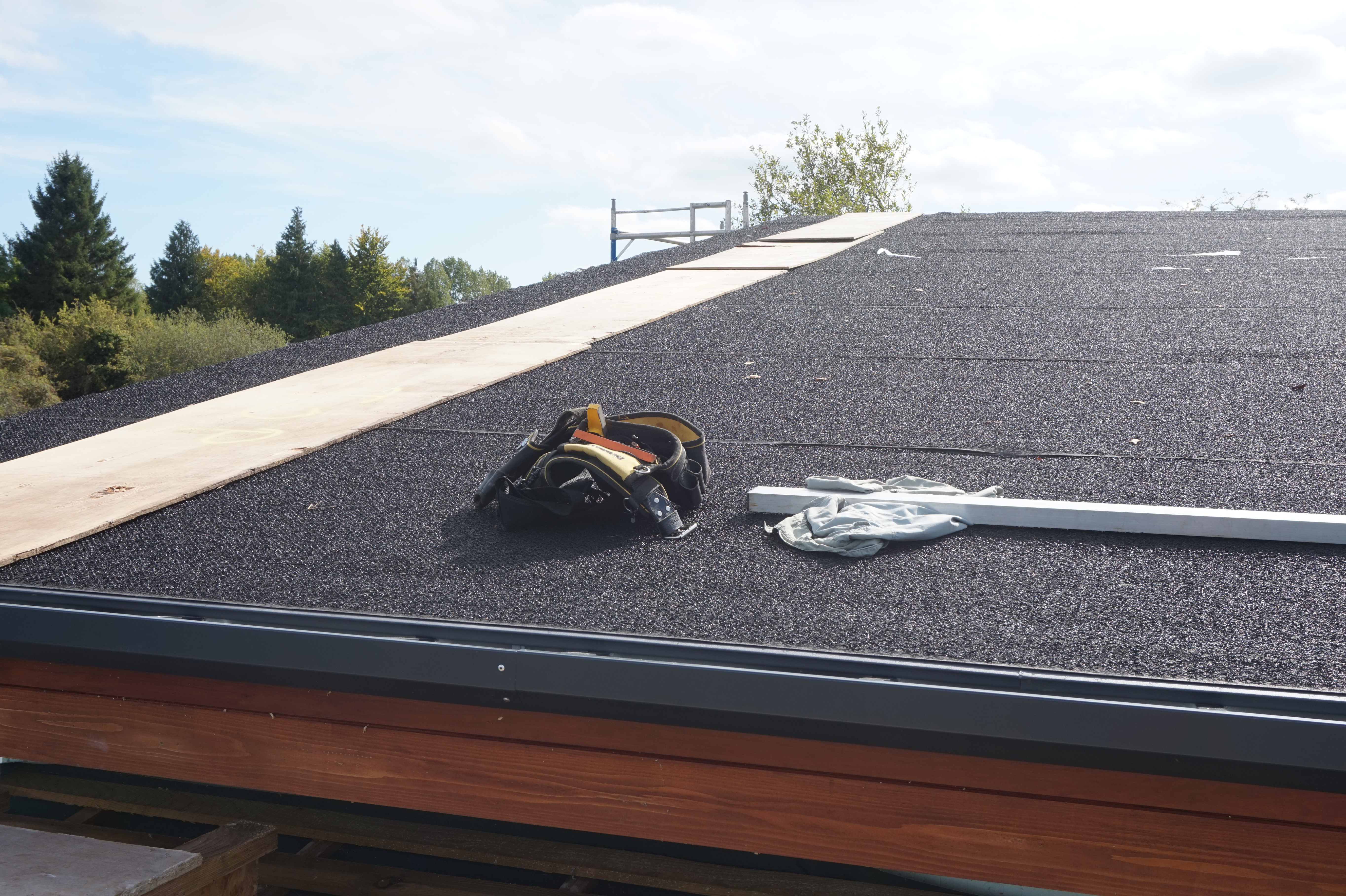

I'm going for the same build-up and after seeing some wee rips on the house wrap membrane today am now thinking about fitting a membrane onto sarking when I put it up at the weekend (was going to just stick some polythene over it to keep the rain at bay for the 5 weeks until the rooflights and windows get fitted but a bit of membrane won't cost too much more). Maybe a daft question but once you've put the membrane across does that then make it difficult to walk on the roof/work from it/install any 'metal mat' below metal roof given you can't see the hit and miss sarking?
Posted
Get some boards to walk on.
Posted
👍 Is the second layer just cheaper impermeable stuff?
