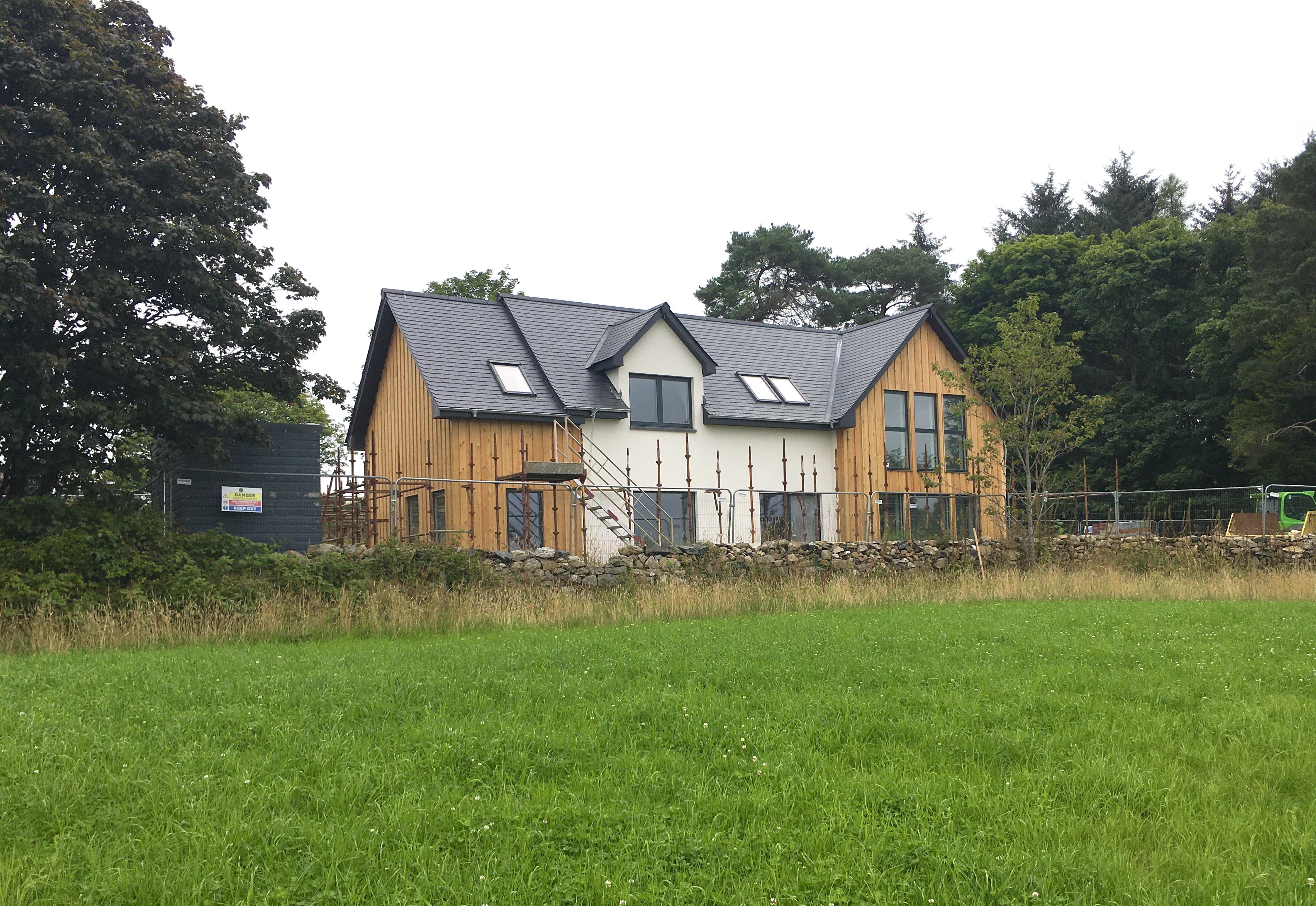

It’s too late to change anything now !  I have some regrets about the design but was wondering what you lot think. Great view over hills to the South & north, nice garden to east.  Country lane to north close to the house.    What would you have changed?

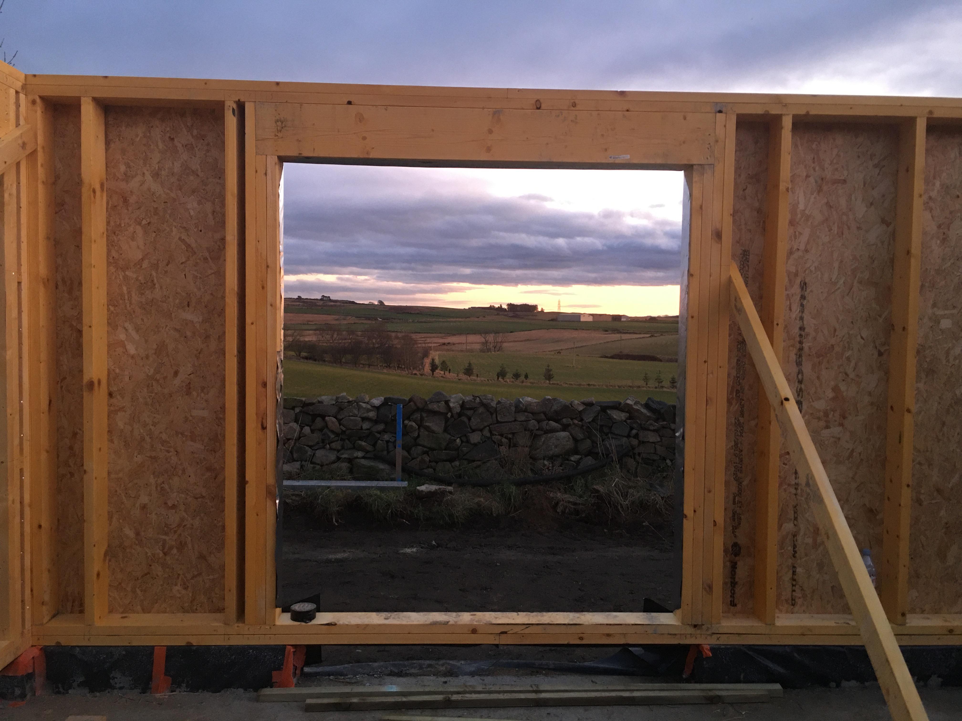

Yeah re the table I’d looked at that possibly with an L shaped diner type seat In the corner. Even looked at a table built from the islan as one whole unit. Thing is the table centred on the window gives the view I’ve attached here.  I’ve estimated I’ll have 1.4m from the island, more if I reduce the island from 1.2 to 900 deep.  Or try to get a narrow table with slimline chair back possibly Scandi type design.
