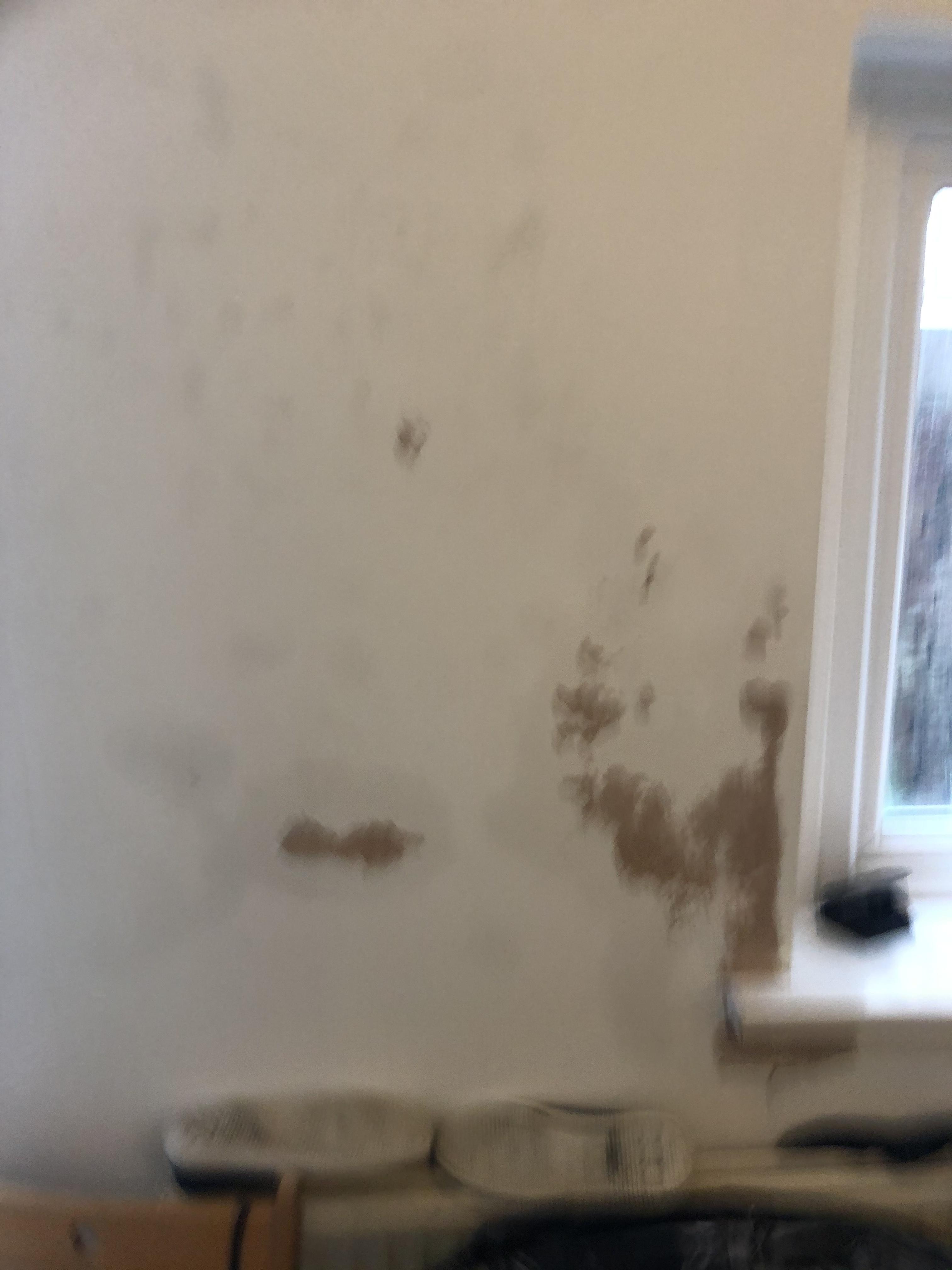

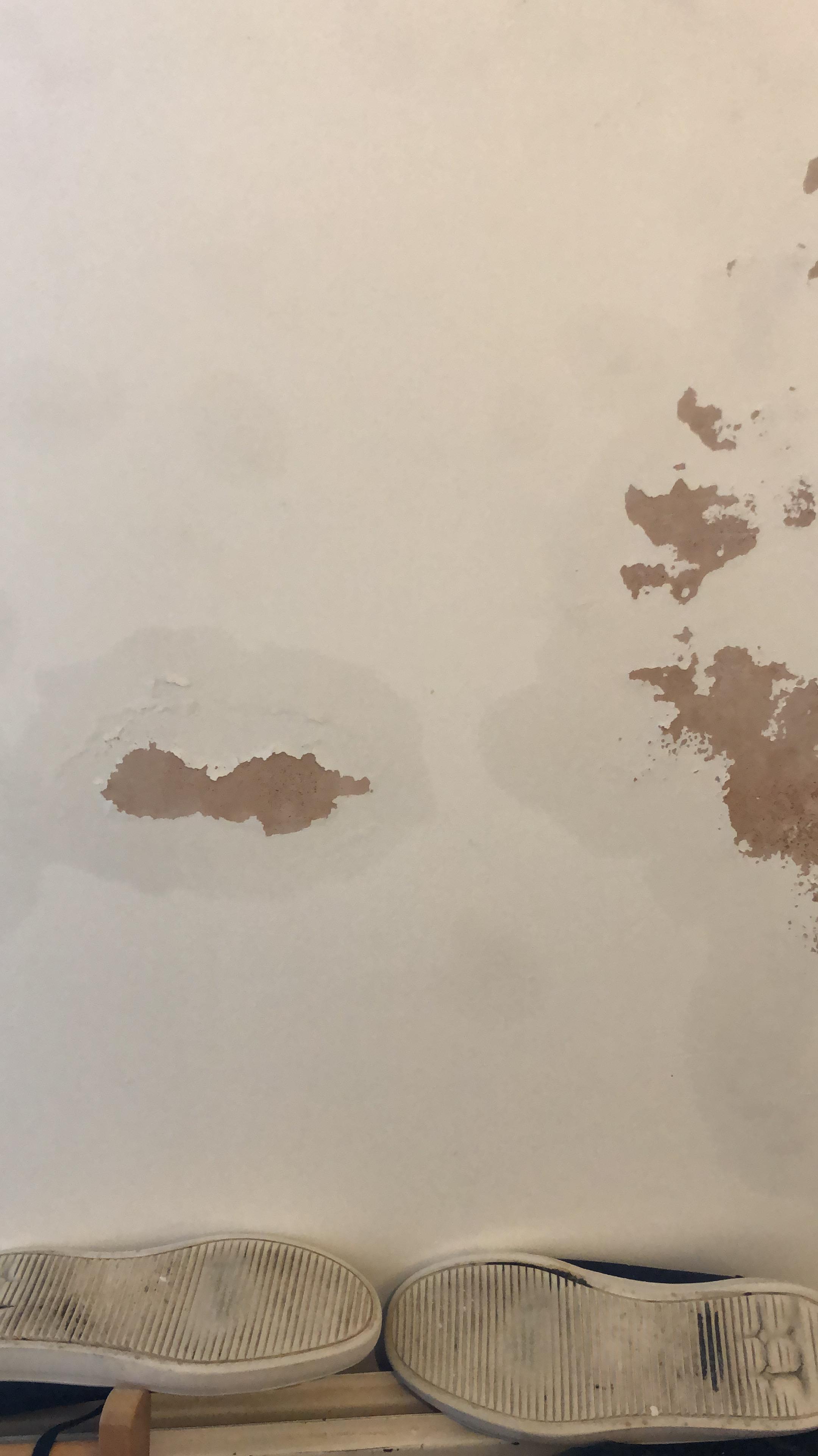

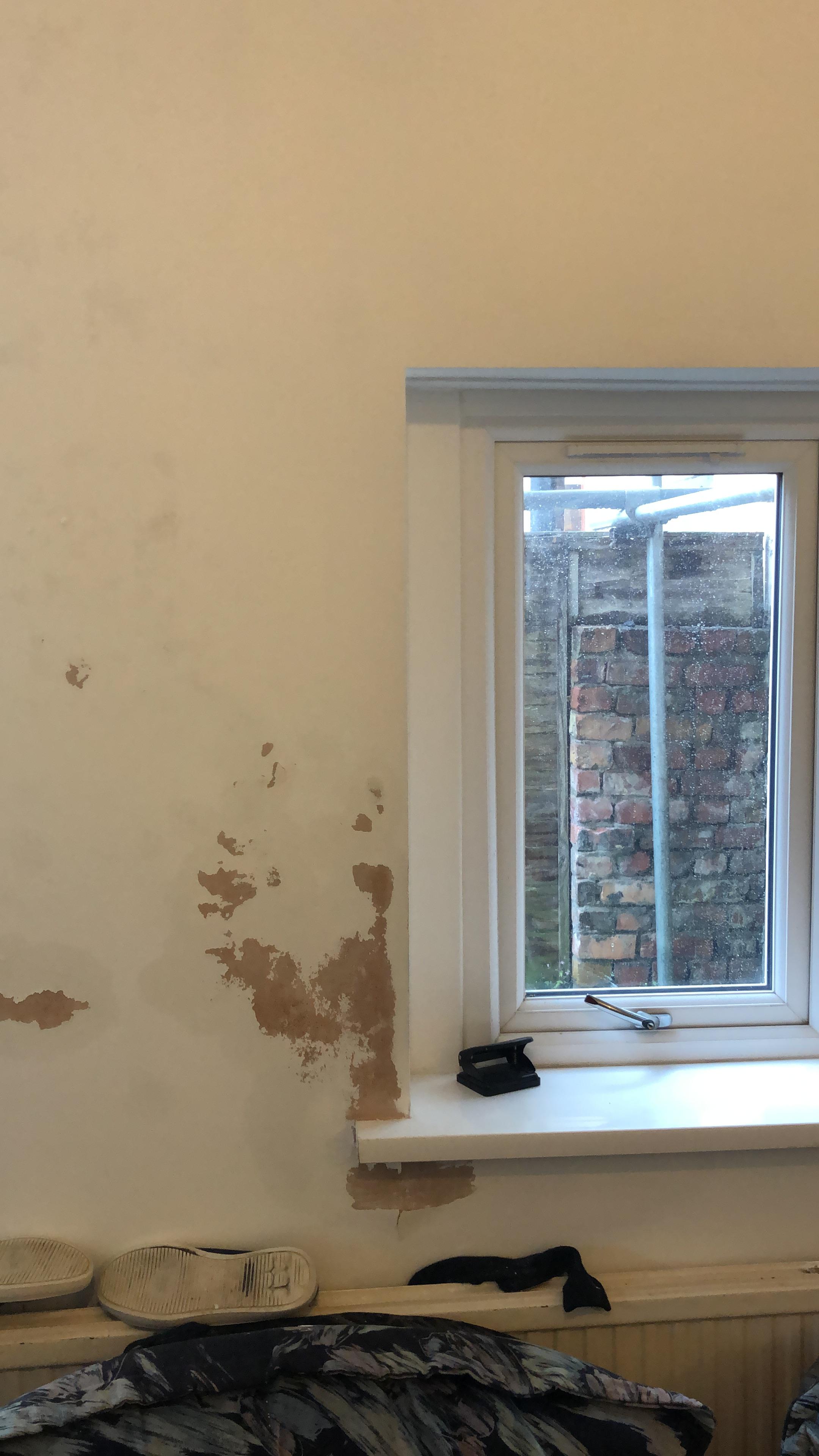

Pocster Posted August 19, 2020 Posted August 19, 2020 (edited) This walls always been a pain . It’s been supposedly fixed before ( cracks in External render filled ) This is the downstairs lounge wall . Bathroom directly above . Bathroom internal wall seems fine . No obvious leak in bathroom. No water marks on ceiling in lounge . Assume not a roof issue as half way down . Nothing obvious outside , even checked in the rain . Edited August 19, 2020 by pocster
Mr Punter Posted August 19, 2020 Posted August 19, 2020 What is the wall construction? If is is cavity, there should be a cavity tray / DPC above the window lintel sloping to the outside leaf with weep holes either end to let water drain out.
Pocster Posted August 19, 2020 Author Posted August 19, 2020 8 minutes ago, Mr Punter said: What is the wall construction? If is is cavity, there should be a cavity tray / DPC above the window lintel sloping to the outside leaf with weep holes either end to let water drain out. Presume it’s cavity There’s a lip above the window external directing water away . I’ll grab a photo later
Mr Punter Posted August 19, 2020 Posted August 19, 2020 Is this in your dungeon place or the dosshouse Luxury HMO?
Pocster Posted August 19, 2020 Author Posted August 19, 2020 35 minutes ago, Mr Punter said: Is this in your dungeon place or the dosshouse Luxury HMO? Lol the ‘basic’ non luxury hmo . All my houses leak

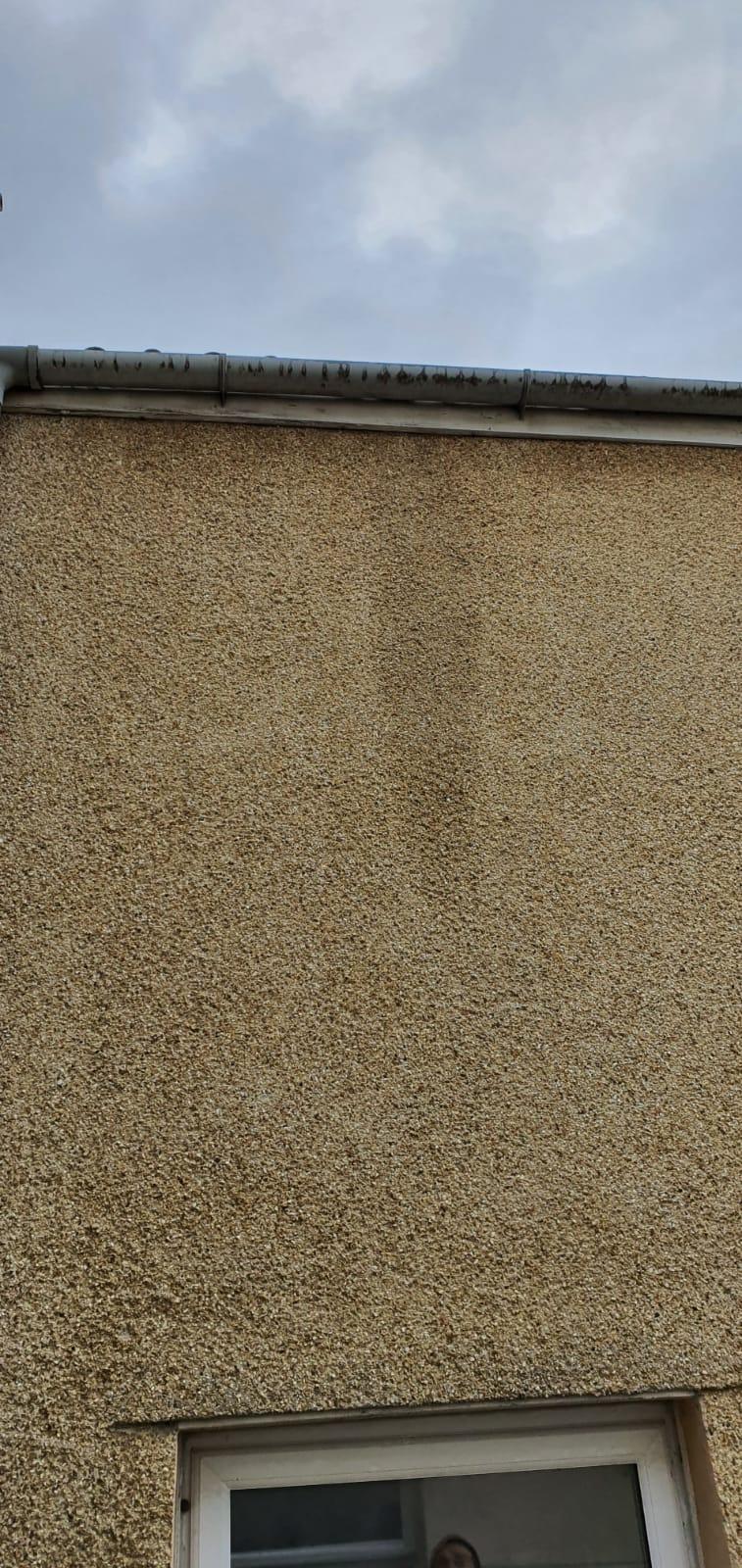

Pocster Posted August 23, 2020 Author Posted August 23, 2020 Did spot this after rain . So perhaps guttering is leaky as water seems to be running down the render ?
Mr Punter Posted August 23, 2020 Posted August 23, 2020 Well spotted. Get your ladder and up you go. You may find one of those ladder stand off brackets will make it easier if you need to unclip a section. 1

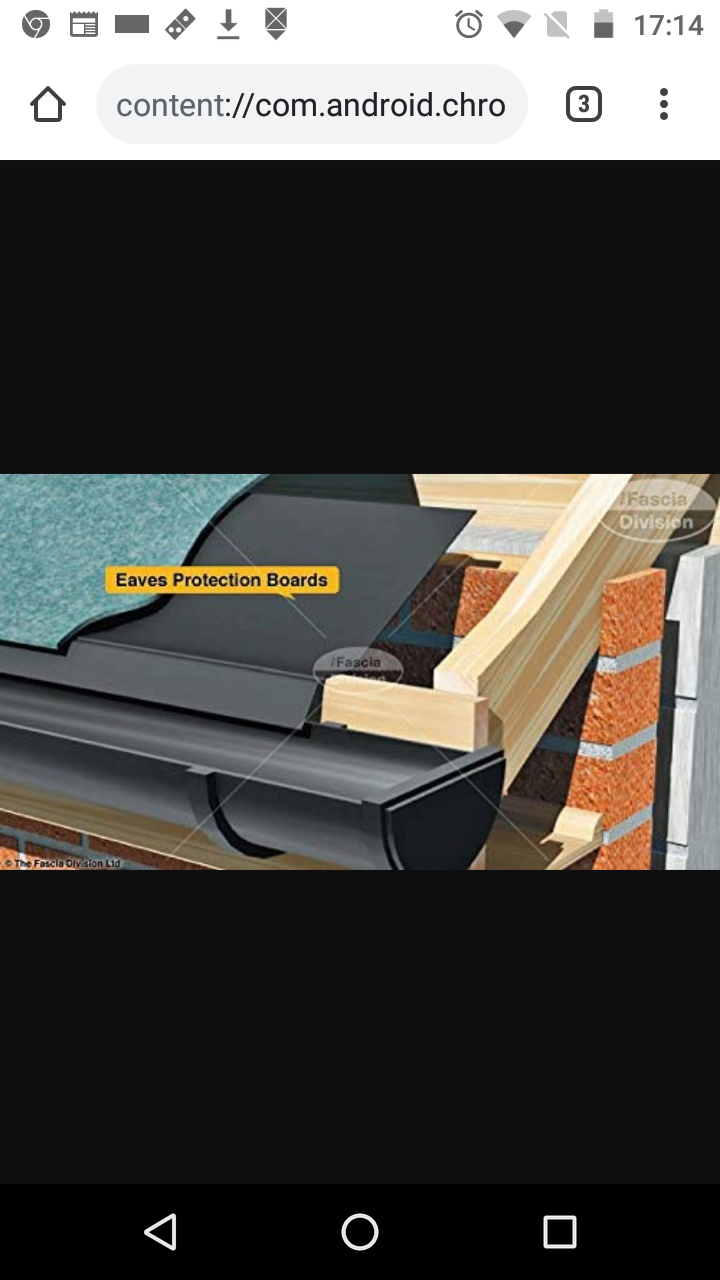

Onoff Posted August 23, 2020 Posted August 23, 2020 If you were to lift a tile or two you may find the underlying roofing felt that should direct into the gutter has perished/split/sunk. Eaves protectors might help. Even a blocked downpipe/gutter can contribute to something like this. 1
Pocster Posted August 23, 2020 Author Posted August 23, 2020 2 hours ago, Mr Punter said: Well spotted. Get your ladder and up you go. You may find one of those ladder stand off brackets will make it easier if you need to unclip a section. I don’t do heights . So up builder goes .... ????

ToughButterCup Posted August 23, 2020 Posted August 23, 2020 On 19/08/2020 at 12:37, pocster said: ... Should be obvious to a man of your existence innit..... 'S the trainers innit. Wet trainers, wet wall obvs. 1
