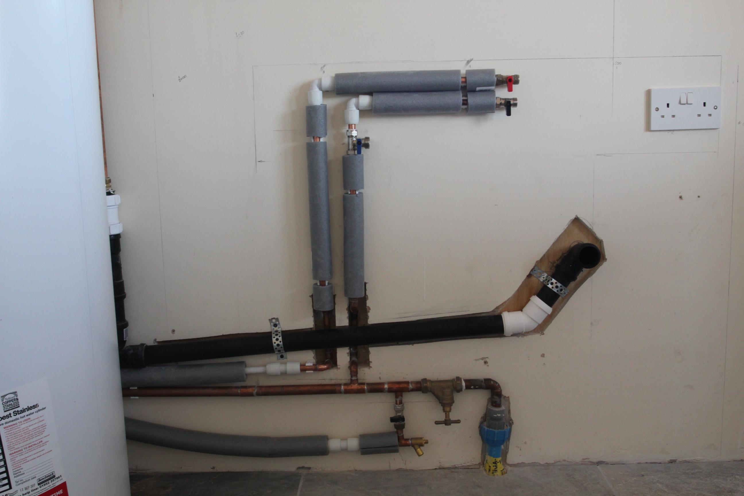

CC45 Posted August 18, 2020 Posted August 18, 2020 here you go. In prep for a DIY kitchen unit. All went in fine. Good luck 2
MJNewton Posted August 18, 2020 Author Posted August 18, 2020 (edited) Looking good! You've also made me realise that a recessed waste pipe also enables greater freedom of how/where to route the supply pipework. Edit: Looking closer I see that the waste pipe is in front of the water pipes - I was assuming it was sitting behind.. Edited August 18, 2020 by MJNewton
PeterW Posted August 18, 2020 Posted August 18, 2020 10 minutes ago, MJNewton said: Looking good! You've also made me realise that a recessed waste pipe also enables greater freedom of how/where to route the supply pipework. Edit: Looking closer I see that the waste pipe is in front of the water pipes - I was assuming it was sitting behind.. I’ve hidden a waste pipe in a wall - 50mm insulation on an external wall was chased to accept a 40mm waste and then just wedged and foamed. Then boarded over and you wouldn’t know it was there (until the sink runs though it..!!)
CC45 Posted August 19, 2020 Posted August 19, 2020 18 hours ago, MJNewton said: Looking good! You've also made me realise that a recessed waste pipe also enables greater freedom of how/where to route the supply pipework. Edit: Looking closer I see that the waste pipe is in front of the water pipes - I was assuming it was sitting behind.. yep, waste pipe is in front of the hot & cold supply. You need to take the PB layer off and maybe a bit of the insulation. I tidied it all up before the unit went in (more insulation etc) but it gives you an idea. The bottom pipe feeds an external tap - I wanted to be able to drain it from inside the house hence the drain plug. 1
