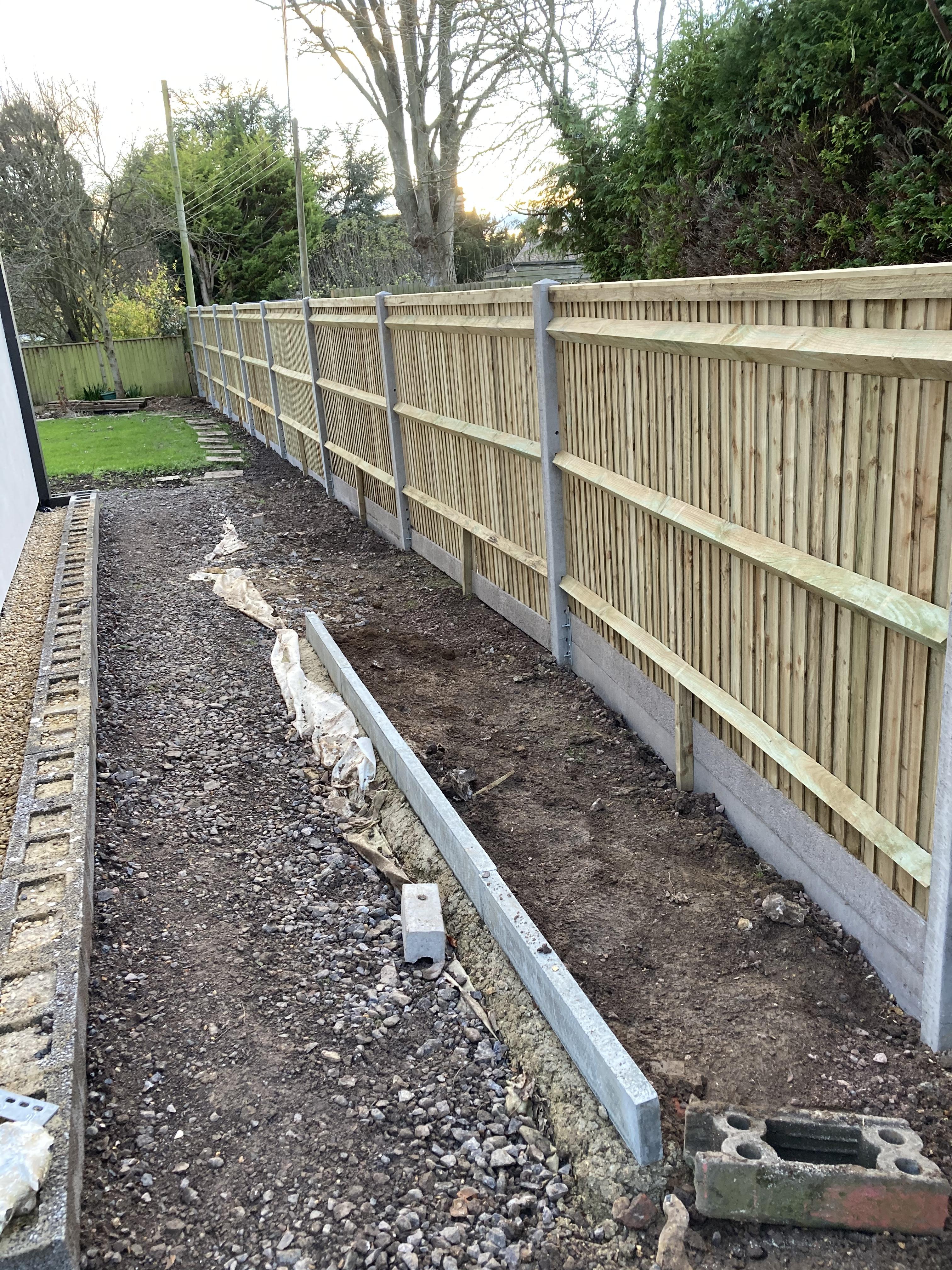

Dave Jones Posted December 5, 2020 Share Posted December 5, 2020 2.4 between posts as arris tails come in 4.8 lengths. Pushing to 3m is lazy as they saving on a couple posts at the expense of quality. Link to comment Share on other sites More sharing options...
avabanana Posted January 20, 2021 Share Posted January 20, 2021 3 meter arris rails is the standard size and absolute fine. I am the director of a fencing company. We give a 5 year guarantee on our work and I've NEVER had a call back on an arris rail snapping at 3 meters in 10 years. You can't even buy 2.4 m arris rails in 99% of fencing suppliers and 4.8m I have never even heard of. 1 Link to comment Share on other sites More sharing options...
Onoff Posted January 20, 2021 Share Posted January 20, 2021 I've 300' of feather edge fencing running East/West across the valley. Concrete posts, 3 X 3m arris rails. Never had a problem. Link to comment Share on other sites More sharing options...
Russdl Posted January 20, 2021 Share Posted January 20, 2021 Our fence was done with 3m arris rails for aesthetics. Any shorter and it seemed to me there would be too many post cluttering things up. I can’t fault the quality. (My nephew did it and he’s bigger than me.) Link to comment Share on other sites More sharing options...
