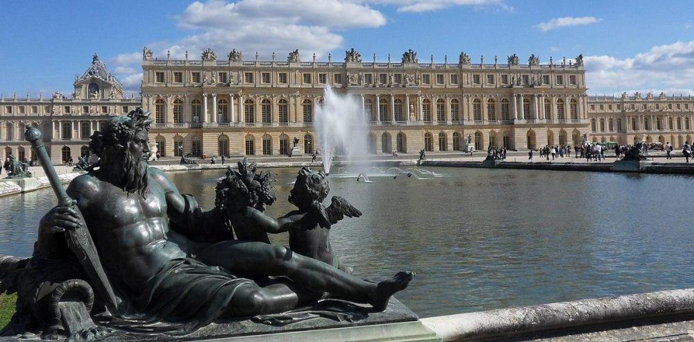

Temp Posted August 13, 2020 Share Posted August 13, 2020 (edited) 4 hours ago, lek28 said: Is there an accepted threshold for variances that I could point to in arguing that the window is not to spec and needs to be remedied? Typically you measure the opening and subtract 10mm (5mm each side and top and bottom) to allow for manufacturing tolerances. But the issue isn't a manufacturing tolerance issue but a spec issue. 7 hours ago, lek28 said: The planning application specifically described "Replacing the window in the ground floor closet wing with a new window to match the existing window on the 2nd floor above to enhance the symmetry of the outrigger" In no way can 46 x 110 be said to "match" 59 x 127. When you have one window above another, as you do here, the Architecturally "right" thing would normally be to match the width. The height normally being less critical. Its common to have higher ceilings and windows on some floors ... If the windows are side by side then the height would normally be the thing to match. PS no thats not my house. Edited August 13, 2020 by Temp Link to comment Share on other sites More sharing options...

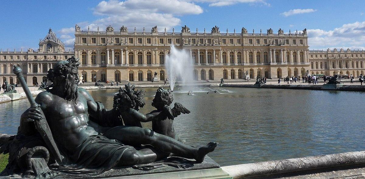

Simplysimon Posted August 13, 2020 Share Posted August 13, 2020 1 hour ago, Temp said: Typically you measure the opening and subtract 10mm (5mm each side and top and bottom) to allow for manufacturing tolerances. But the issue isn't a manufacturing tolerance issue but a spec issue. In no way can 46 x 110 be said to "match" 59 x 127. When you have one window above another, as you do here, the Architecturally "right" thing would normally be to match the width. The height normally being less critical. Its common to have higher ceilings and windows on some floors ... If the windows are side by side then the height would normally be the thing to match. PS no thats not my house his is off left, just out of shot ? 1 Link to comment Share on other sites More sharing options...
