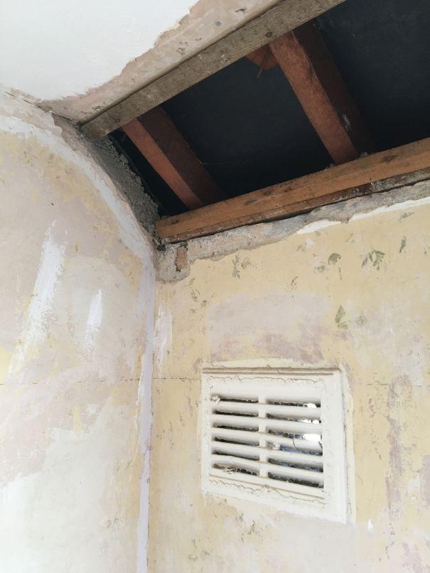

First of all - what is the proper name of this feature, where a wall morphes into a ceiling due to roof height restriction?
Anyway - this is the photo of the current state once the only element separating inside and roof space (a single layer of plasterboard) has been removed:

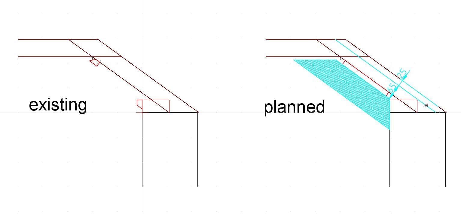

So the said plasterboard was held by chamfered battens - my plan would be to remove them and attach to rafter to space out, so the insulation board would not have to be trimmed in a weird way to fit between the wall plate and rafter, but rather go against the wall. In picture something like that:
The blue object with weird hatching (one doesn't get the right tools with free cad software...) is 100mm K108 (or equivalent) phenolic board: at 450mm standard width this board should only need chamfering to fit wall/ceiling, where 1200mm PIR board cut in half and then butchered would produce so much waste, that in this case phenolic happens to be cheaper - and protrudes less into the room.

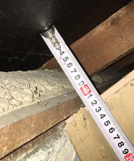

25mm from the top of the rafter (surface of the felt) would be a ventilation tray, the remaining 65mm space filled with Thermofloc - I'm planning to use it on the ceiling (70mm between joists, then 9mm osb to support, then up - to 400mm in total), so it would probably spill in the void anyway. A layer of plasterboard would be placed directly on the phenolic board.
The walls are concrete, so for airtightness I'm planning to sandwich a layer of membrane between the insulation board and the plasterboard and tape it to the wall. I'm assuming the walls are airtight enough (concrete + plaster): the vent seen ot the first photo  - an original feature, present in each room - must be there for a reason. Ultimately MVHR will take their role, hence the trouble of sealing.
Not sure yet what to do at the ceiling: whether to stick membrane to existing ceiling and board over, or go over to the loft and lay it there
Questions:
- hand laid Thermofloc comes with 'it is designed to install by hand in horizontal spaces' clause - but as its blown brother lives happily inside vertical walls, what problems could I potentially expect from stuffing it into this sloped void? Has anybody done that before?
- any ideas how to attach the new plasterboard? Loking at the drawings my best chance it to screw at an angle into the wall plate and roof joists. Easier would be to go into the rafters, but I'm worried about the edges sagging.
- can anyone point me to loong ventilation tray - for this I'd need something at least of 1m. Or should I simply stagger 2 or 3 standard ones for required length, just making sure that air channels align?
- any recommendations for airtight tape that seals well to old, rough concrete? Or how to prepare the concrete so the tape binds better?
You need to buy a sheet of 62 mil insulated PB
Cut it to size measuring from the bottom of the timber wall plate
Then further up the sloping timber measure down 62 mil Draw a pencil line between the two points up against the flat part of the ceiling and you have your size
Then cut the foam back with a saw so it sits flat
Fix with 100 mil drywall screws
I like the idea of bonded insulation, found https://www.xtratherm.com/products/sr-pr/ that gives me 100mm phenolic, and seems to be rougly the same price as K108+plasterboard (even with offcuts), saving on hassle of mounting 2 layers separately.

Unless I lifted the level of tiles, there would not be more room for insulation (at least at the junction with the wall)?
I need to open the soffit to see exactly what is happening there, but in principle I'd put EWI all the way up, to meet (get as close as possible) with the above skeiling layer discussed here.
