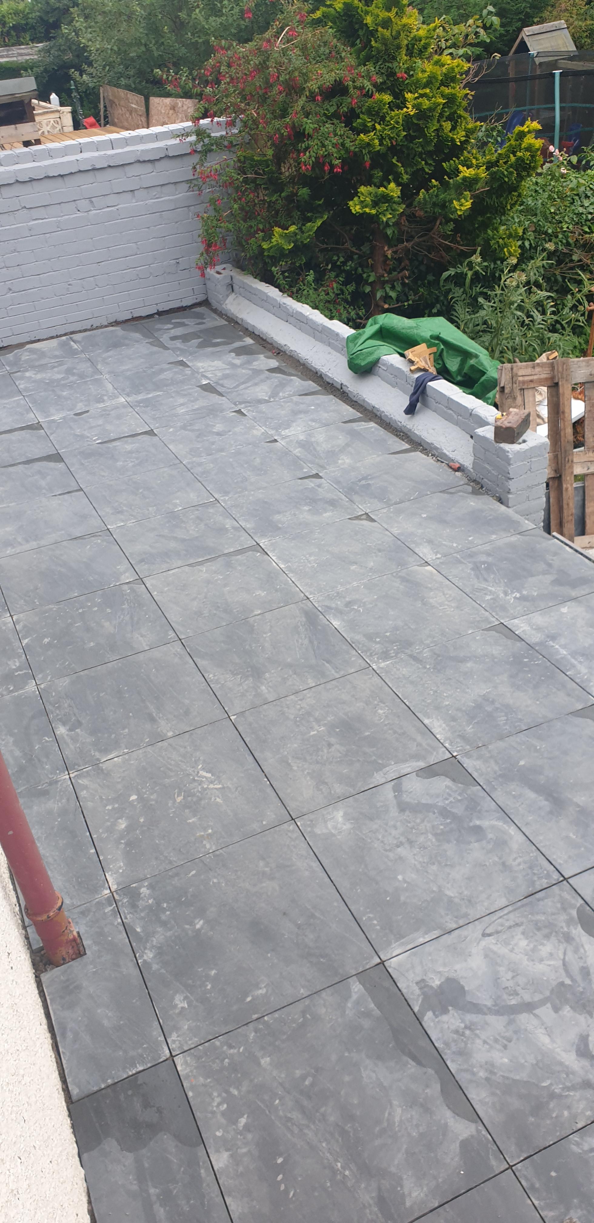

Graeme Posted August 1, 2020 Share Posted August 1, 2020 Hi. I have layed a 50m2 charcoal grey porcelain patio, but in doing so I've got quite a lot of slurry and clement residue over the tiles. I've tried jet washing them but it didn't really make much of a difference. Can anyone recommend a product or a method that will lift this? The tiles look great when wet but as soon as they dry you can see all the slurry/cement sitting on them. Thanks Graeme Link to comment Share on other sites More sharing options...
Ferdinand Posted August 1, 2020 Share Posted August 1, 2020 (edited) Brick acid? If necessary combined with one of those wire patio scrubbers. (Done on a small inconspicuous area first.) Edited August 1, 2020 by Ferdinand Link to comment Share on other sites More sharing options...
Declan52 Posted August 1, 2020 Share Posted August 1, 2020 You could try brick acid. Start of with it well watered down, maybe 20% acid, and try it on a hidden area. If it works great but if it doesn't just increase the mix little by little until it shifts it. Link to comment Share on other sites More sharing options...
PeterW Posted August 1, 2020 Share Posted August 1, 2020 HG do a grout and cement cleaner - it’s very good !! https://hg.eu/uk/products/hg-tiles-cement-grout-film-remover-product-11 1 Link to comment Share on other sites More sharing options...
Nickfromwales Posted August 1, 2020 Share Posted August 1, 2020 31 minutes ago, PeterW said: HG do a grout and cement cleaner - it’s very good !! https://hg.eu/uk/products/hg-tiles-cement-grout-film-remover-product-11 +1. Got me out of the shit a good few times. You'll need some elbow grease though. Best is to do this literally two tiles at a time or you'll be filling yourself with false hope ( as you're probably aware it's nigh-on impossible to tell good from bad when wet ). Link to comment Share on other sites More sharing options...
