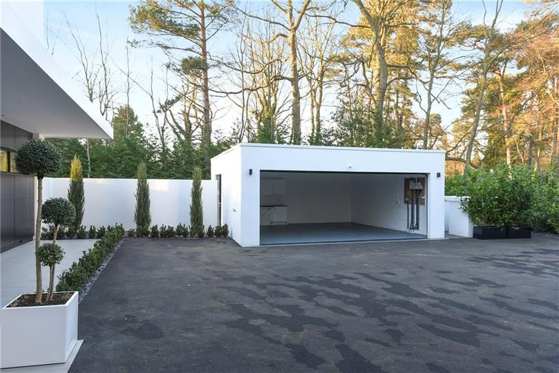

AliG Posted July 27, 2020 Share Posted July 27, 2020 Hi, Now that we have planning permission for a house we are looking to put in a separate application for a garage. It is a conservation area so no PD rights. As the house is flat roofed with off white render, wood panels and 7016 windows we would expect the garage to look similar, so a 6x6m double garage with 7016 door, off white render, wood panels and a flat EPDM roof. Something roughly like the attached picture. What is the best way to build this? It doesn't have to be insulated, used as a workshop or anything, just storage for a car and gardening equipment. Can we just build a stick built timber frame and attach render board directly to the outside and OSB to the inside, maybe filling with rock wool? Would it need a cavity if it is rendered on the outside? Or maybe it would be just as cheap to build it in single skin blockwork and render. We had a quote for a very snazzy aluminium carport and storage, it was 20K! I reckon, a concrete base, and this kind of structure, plus a single motorised door could be brought in for around 15k? Link to comment Share on other sites More sharing options...

Russell griffiths Posted July 27, 2020 Share Posted July 27, 2020 Single block with block piers, if you want the inside walls flat you will need to go double block to have piers, single block will not stand up on its own, unless maybe a 150mm semi lightweight block. Link to comment Share on other sites More sharing options...
AliG Posted July 27, 2020 Author Share Posted July 27, 2020 (edited) Thanks @Russell griffiths We don't need flat walls. Do you reckon single skin blockwork is cheaper/better quality than timber frame? Looks like we are talking around £100 per square metre of rendered wall. So £7500 for the walls including lintel, £3500 for the roof, £2000 for the door fitted, £5000 for foundations and slab. Then guttering etc probably takes it up to £20k. Edited July 27, 2020 by AliG Link to comment Share on other sites More sharing options...
