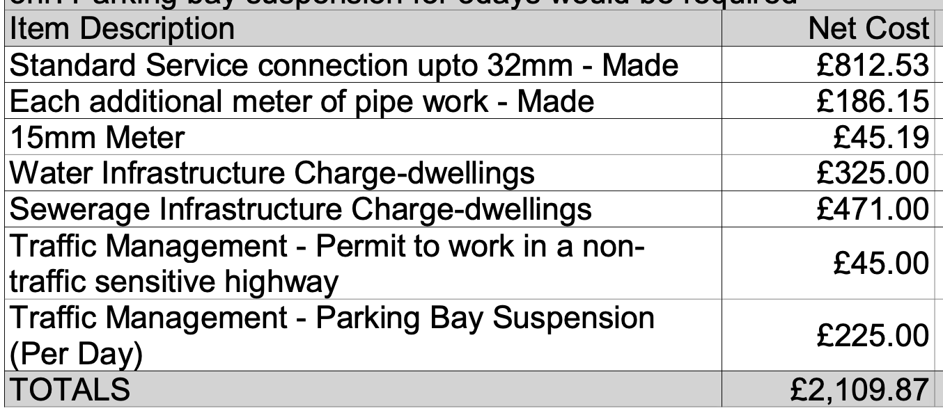

Potable water (work will be done in the next couple of months): 35 metre communication pipe in a non-adopted road (concrete surface) is about £110 per meter (by my contractor). The Cambridge Water connection cost to the mains is as follows:
Note: this price is from before April 2020 and I think it is due to rise a bit because of annual price rises.

It's not very safe to use an average figure as prices can vary a lot depending on the situation. In some cases you could be diggng short distances across grass verges  and in others hundreds of yards along a road.  Some work you can do yourself and some has to be done by a contractor working for the utility company. Some utility companies seem to exploit this and charge extortionate rates compared to what you could do it for yourself.
I would budget  £120-£150 per meter in grass and £200-300 per meter in tarmac plus anywhere from £1000-£5000 per connection.
Much higher fgures of aren't unheard of..
