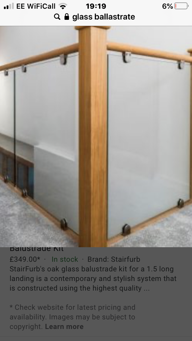

Boris Posted July 18, 2020 Share Posted July 18, 2020 Hi, we have a Stairbox oak on sides as we need carpet for the dogs to be able to use safely. The staircase is the type with the glass panels sitting in grooves. On a test run I have noticed they rattle in the cut out. What is best for securing them ? TIA. Link to comment Share on other sites More sharing options...
nod Posted July 18, 2020 Share Posted July 18, 2020 (edited) You would normally fix them onto both Newel posts leaving an even gap all around Exactly the same as fitting to steel uprights Edited July 18, 2020 by nod Link to comment Share on other sites More sharing options...
Declan52 Posted July 18, 2020 Share Posted July 18, 2020 Something as simple as some putty maybe. Link to comment Share on other sites More sharing options...
Onoff Posted July 18, 2020 Share Posted July 18, 2020 Clear CT1? Link to comment Share on other sites More sharing options...
