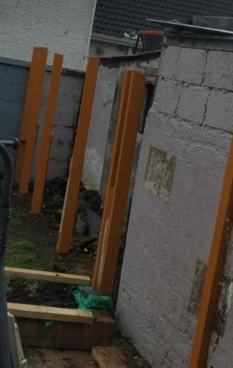

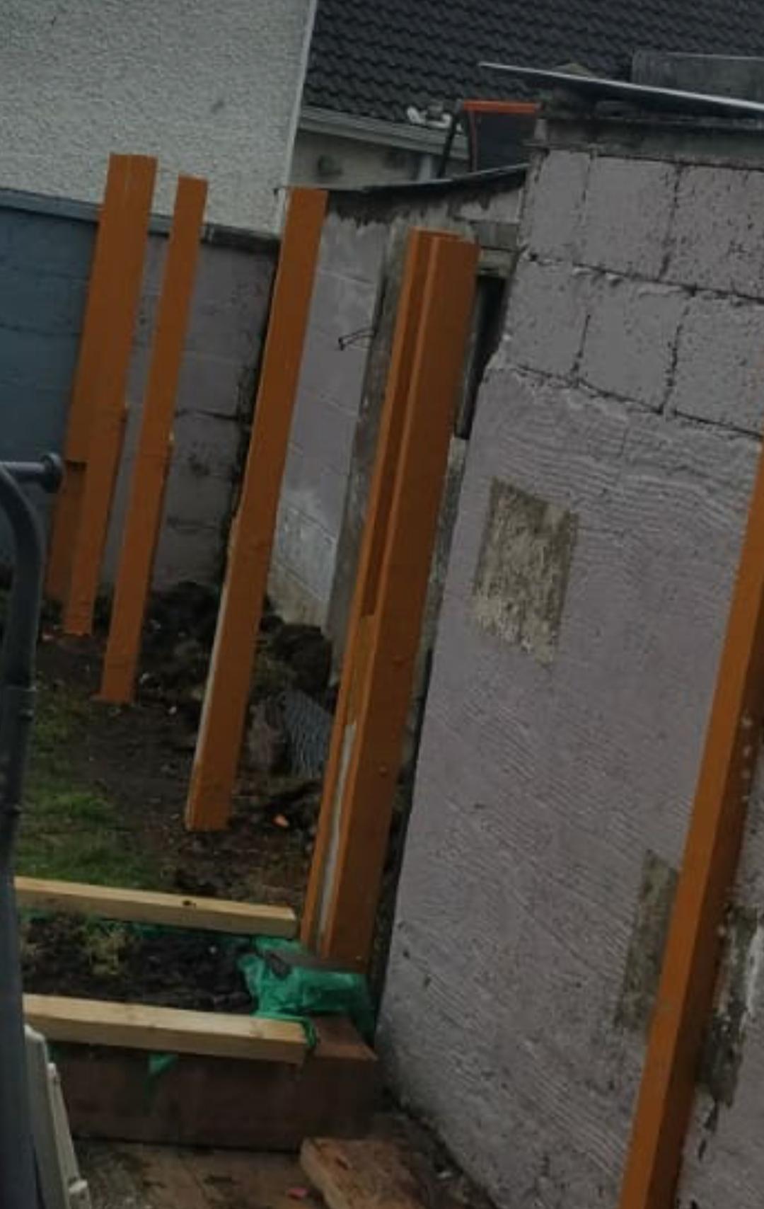

Declan52 Posted July 16, 2020 Share Posted July 16, 2020 How much are they out of line?? You could use long bolts and pack out some 4*2 or 6*2 treated to get you where you need to be assuming they are maybe 50mm -100mm max out of line. I did this a few weeks ago using M10 bolts and 4*2. You use the 4*2 as your new post and it gets set level and all in line and gets bolted to the wonky concrete post. You can see the old posts sticking out the back on the last two posts in the pic below. Link to comment Share on other sites More sharing options...

Declan52 Posted July 16, 2020 Share Posted July 16, 2020 58 minutes ago, ReX said: I like it - no digging and no concrete heavy lifting. If I do as you suggest I could have the timbers posts all in line and fix the cladding against them. Which pre-treated wood battens should I get to get a finish as in the picture attached? Will it last? It will depend on how far out they are. But hopefully it's an easier solution that digging them all out. You can use 4*4 posts instead on 4*2 of your concerned about the strength. Will just mean longer bolts. Link to comment Share on other sites More sharing options...
ReX Posted July 17, 2020 Author Share Posted July 17, 2020 16 hours ago, Declan52 said: It will depend on how far out they are. But hopefully it's an easier solution that digging them all out. You can use 4*4 posts instead on 4*2 of your concerned about the strength. Will just mean longer bolts. Having a look at them, I think the vast majority can be sorted in this way but 4-5 should be digged out and reinstalled because they are so out that also the panels tend to move. As for the battens to get the effect I want, would Siberian larch be a good choice? Link to comment Share on other sites More sharing options...
