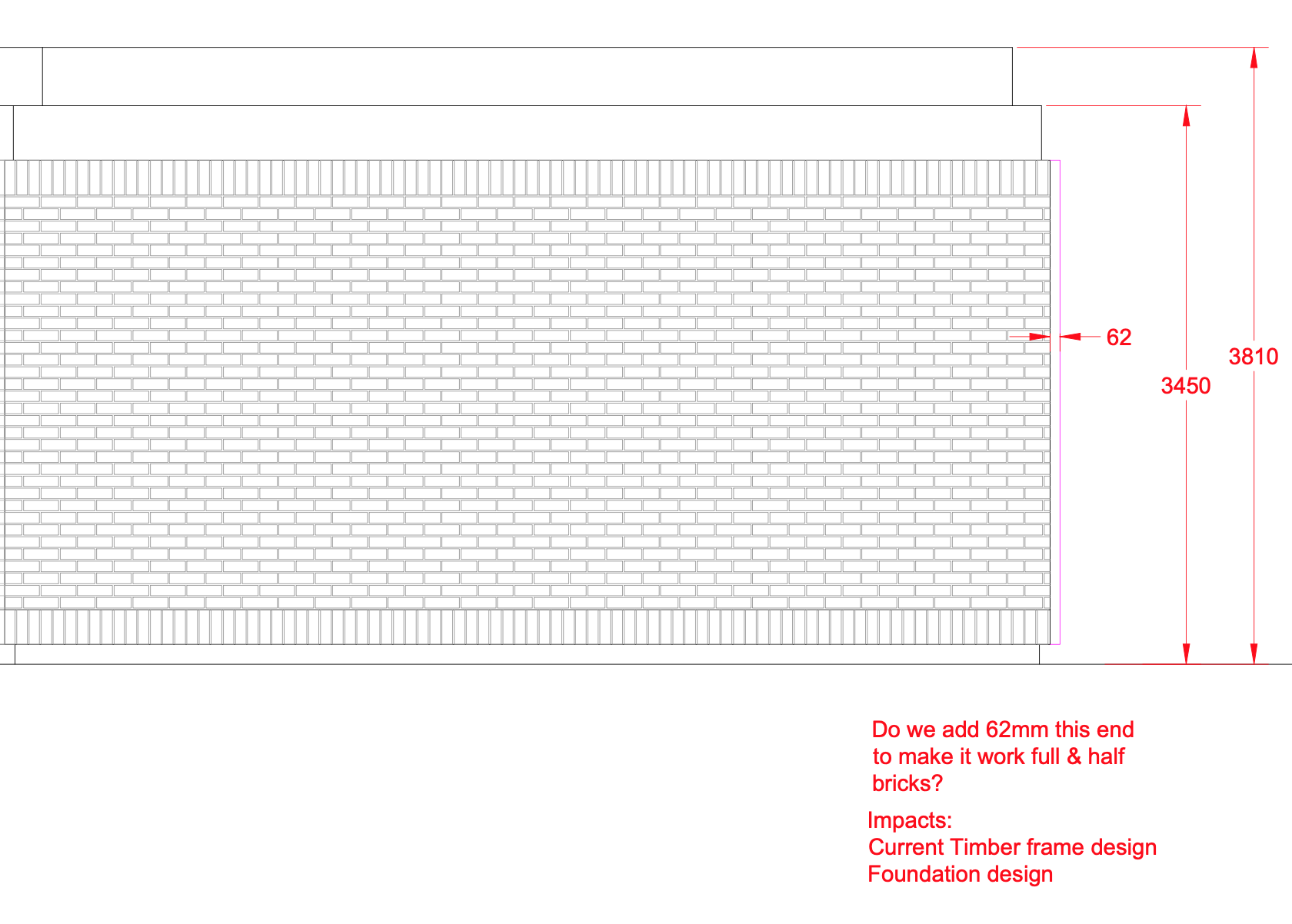

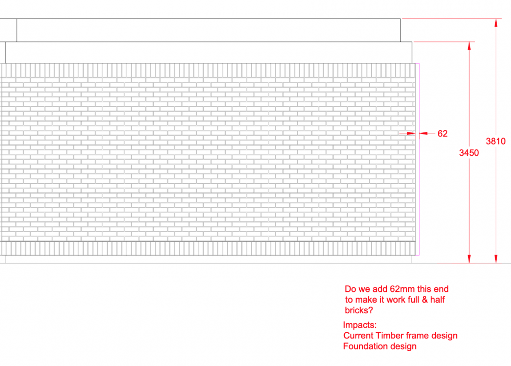

Dreadnaught Posted July 14, 2020 Posted July 14, 2020 My architect is designing my brick slips elevations. Note: they are slips not full bricks and they will come from by Eurobrick if that is relevant. See the 62mm gap at the end, what to do about it? Do I … Re-design the timber frame? Absorb 62mm into the mortar joints between the slips? Cut the slips? Something else? I have zero experience of brick-laying or slips. What do you all think? Now is the time to make any design changes, if needed.
Mr Punter Posted July 14, 2020 Posted July 14, 2020 Unless you are using a system that means the perps are set you will easily get this to work by slightly opening or closing up the slips. As it is shown, there are some small cuts at the end that look a bit crappy. Do these return round a corner? 1
Dreadnaught Posted July 14, 2020 Author Posted July 14, 2020 (edited) Thanks @Mr Punter. … slightly opening or closing up the slips … That sounds do-able I think, thanks. Do these return round a corner? Good question. The rear face of the building (around that corner) transitions immediately in to Cedral click cladding*. I am not sure how to make the transition from bricks to cladding look good. So don't know … Return around the corner with a pistol corner slip, and then transition to cladding with some sort of profile? Corner end aluminium profile? Something else? * I will never see that side around the corner, only the neighbours will, which is why I went for cladding rather than slips: to save money. Edited July 14, 2020 by Dreadnaught
Mr Punter Posted July 14, 2020 Posted July 14, 2020 You could use a Cedral stop end profile and extend it out the depth of the brick slips. Leave a small even gap at the end of the slips and fill either with the pointing material or mastic of the same colour. 1
Declan52 Posted July 14, 2020 Posted July 14, 2020 You just treat it like you would a standard brick wall. Just open the perps up to give you the required distance. 1
Dreadnaught Posted July 14, 2020 Author Posted July 14, 2020 Thanks guys! Great advice. That sounds like a solution: use Cedral stop end profile and open-up the perpends.
