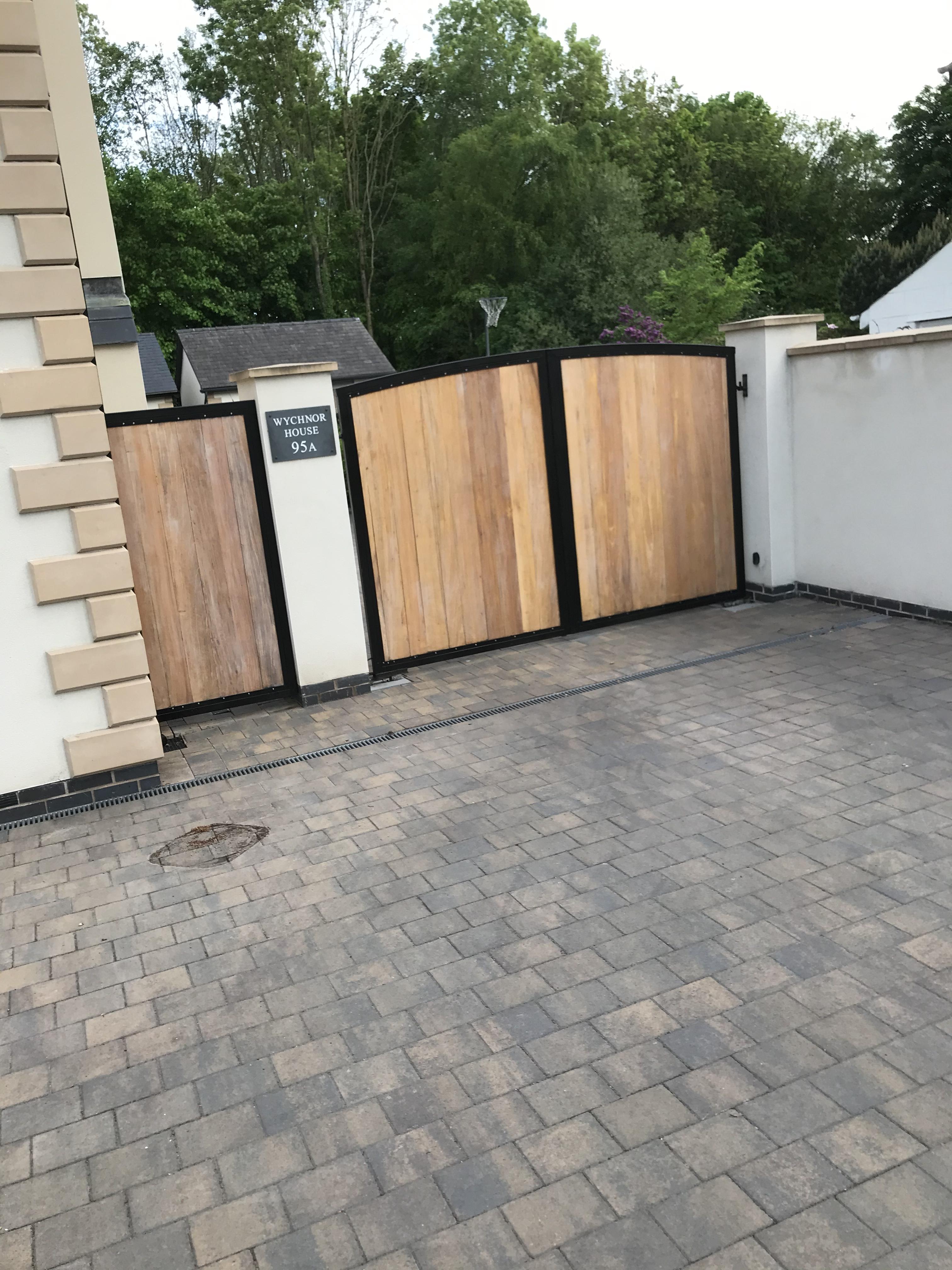

nod Posted July 12, 2020 Posted July 12, 2020 While Oak is expensive Iroko is long lasting and looks similar and less expensive I used Idigbo for my gates for the same reason Looks very similar to oak Or you could use pressure treated softwood But won’t last 1
