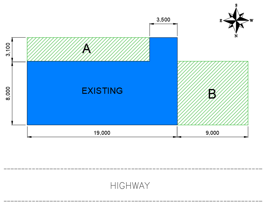

Matt Davey Posted July 9, 2020 Share Posted July 9, 2020 (edited) Hi there We joined the forum yesterday and used our 'introduce' entry of the new members group to outline a question we have over permitted development rights and how rear and side extension potentially inter-relate. In hindsight, we probably put too long an entry and over-complicated our question, so we felt it was probably better to refine our ask and add it to this more specific group. So here it is.... To help describe the question we attach a visual representation of our wish here. extension? Basically, can rear extension 'A' cover the whole back part of the property as it does not join 'B'? In other words, as 'B' uses the full half width condition, does this use up allocation for 'A' in the rear If it helps, our longer entry posted yesterday explains all other elements to our plot to pre-empt other questions which may follow to help get an answer to this. Really grateful for anyone who can help us understand the 50 page technical guidance issued around permitted development rights. Thanks in anticipation. Edited July 9, 2020 by Matt Davey Link to comment Share on other sites More sharing options...
DevilDamo Posted July 9, 2020 Share Posted July 9, 2020 (edited) PD relates to the ‘original’ house, which is not necessarily the ‘existing’. So assuming the part you label existing is infact original, then Part A is not PD as it’s greater than half the width of the house. Part B is PD and can be the full length/depth of the original house. Edited July 9, 2020 by DevilDamo Link to comment Share on other sites More sharing options...
Ferdinand Posted July 9, 2020 Share Posted July 9, 2020 (edited) 1 hour ago, DevilDamo said: PD relates to the ‘original’ house, which is not necessarily the ‘existing’. So assuming the part you label existing is infact original, then Part A is not PD as it’s greater than half the width of the house. Part B is PD and can be the full length/depth of the original house. AIUI understand it the half width rule applies to side extensions not back extensions, but this is ironically more discussed on the other thread. Ie the wrong one ?. Edited July 9, 2020 by Ferdinand Link to comment Share on other sites More sharing options...
DevilDamo Posted July 9, 2020 Share Posted July 9, 2020 You’re right, it does. However, if the ‘existing’ house is ‘original’ then the rear infill would be checked against the PD rules for rear and side extensions. And again under PD, that rear elevation has two rear walls. Under formal PP, it would just be deemed as a rear extension. Link to comment Share on other sites More sharing options...
Ferdinand Posted July 9, 2020 Share Posted July 9, 2020 1 hour ago, DevilDamo said: You’re right, it does. However, if the ‘existing’ house is ‘original’ then the rear infill would be checked against the PD rules for rear and side extensions. And again under PD, that rear elevation has two rear walls. Under formal PP, it would just be deemed as a rear extension. My understanding is that the practice will be to use the main plane rather than the smaller plane, and I think here the distinction is clear - and it is well within the 4m limit. AIUI the interpretation may actually allow a further section projecting back to follow the extra bit using the same limit, but I would need to check the dot and tittle. Link to comment Share on other sites More sharing options...
DevilDamo Posted July 10, 2020 Share Posted July 10, 2020 6 hours ago, Ferdinand said: My understanding is that the practice will be to use the main plane rather than the smaller plane, and I think here the distinction is clear - and it is well within the 4m limit. AIUI the interpretation may actually allow a further section projecting back to follow the extra bit using the same limit, but I would need to check the dot and tittle. I’m not sure what you mean? Rear infill extensions have to be checked against the PD rules for rear ‘and’ side extensions. It’s explained here... https://assets.publishing.service.gov.uk/government/uploads/system/uploads/attachment_data/file/830643/190910_Tech_Guide_for_publishing.pdf (Page 23) Link to comment Share on other sites More sharing options...
Ferdinand Posted July 10, 2020 Share Posted July 10, 2020 1 hour ago, DevilDamo said: I’m not sure what you mean? Rear infill extensions have to be checked against the PD rules for rear ‘and’ side extensions. It’s explained here... https://assets.publishing.service.gov.uk/government/uploads/system/uploads/attachment_data/file/830643/190910_Tech_Guide_for_publishing.pdf (Page 23) Off to a hosp appointment, but see page 28 in your doc. F Link to comment Share on other sites More sharing options...
DevilDamo Posted July 10, 2020 Share Posted July 10, 2020 Yes but am not sure how that relates to the OP’s situation!?! Unless I’ve missed something somewhere in that the smaller rear projecting part (3.5 x 3.1m) is not original and is an existing extension? If that is the case, then Part A would be considered to be PD. Link to comment Share on other sites More sharing options...

Ferdinand Posted July 10, 2020 Share Posted July 10, 2020 1 hour ago, DevilDamo said: Yes but am not sure how that relates to the OP’s situation!?! Unless I’ve missed something somewhere in that the smaller rear projecting part (3.5 x 3.1m) is not original and is an existing extension? If that is the case, then Part A would be considered to be PD. OP says that the stepped out bit is original. Point one third bullet here: Link to comment Share on other sites More sharing options...
DevilDamo Posted July 10, 2020 Share Posted July 10, 2020 That would mean the infill/squaring off extension would be determined under both the rear and side PD rules and restrictions. It comes up so much and many are refused CoL applications because of the understanding it is only a rear extension. Link to comment Share on other sites More sharing options...
Ferdinand Posted July 11, 2020 Share Posted July 11, 2020 On 10/07/2020 at 11:13, DevilDamo said: That would mean the infill/squaring off extension would be determined under both the rear and side PD rules and restrictions. It comes up so much and many are refused CoL applications because of the understanding it is only a rear extension. I see your point (p24 in your doc), and I bet it has been done to death in case-law. To me the rational interpretation is that something wholly behind a house should not be a "side extension", but that is not the case. Sometimes strange byways of Planning Law work well and sometimes not. Here - not. F Link to comment Share on other sites More sharing options...
DevilDamo Posted July 11, 2020 Share Posted July 11, 2020 Agreed and is just one of the ‘clever’ ways PD can catch people out. The thing that comes up most is having a side extension and a rear extension under PD but linking them requires formal Planning. If in the OP’s case we are only talking about a single storey rear/infill extension, there’s a 99% chance it’s sail through the formal Planning process anyway. But with that is a formal application, increased fees and a determination process. Link to comment Share on other sites More sharing options...

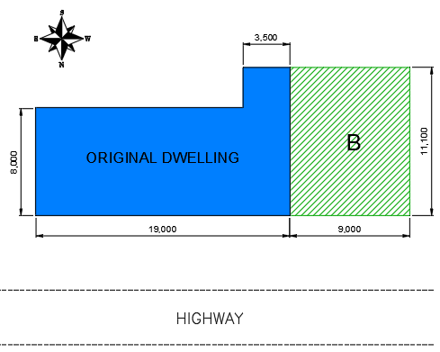

Matt Davey Posted July 11, 2020 Author Share Posted July 11, 2020 Thanks all for your valued input! We have come to the same conclusion; that the small protruding portion of original dwelling creates a rear & side PD extension issue, which in our instance hinders a rear full length extension. Should it not have ever been there, or have been a previous extension to the main dwelling - we could have extended fully along the rear without challenge, what a silly quirk! As such we are revising our scope to remove extension 'A' altogether, and increase the size of extension 'B' to finish flush with the rearmost section of the house. As we see it this would be fully compliant with PD for a side extension as it is less than half the width of the existing dwelling, and would still give us a similar square meter-age overall. Is this how you see it too, we would be interested to know? Thank you 1 Link to comment Share on other sites More sharing options...
DevilDamo Posted July 11, 2020 Share Posted July 11, 2020 That is correct. You could increase the width by another 500mm if need be. Any reason why you are wanting to go down the PD route as opposed to formal PP? Link to comment Share on other sites More sharing options...
