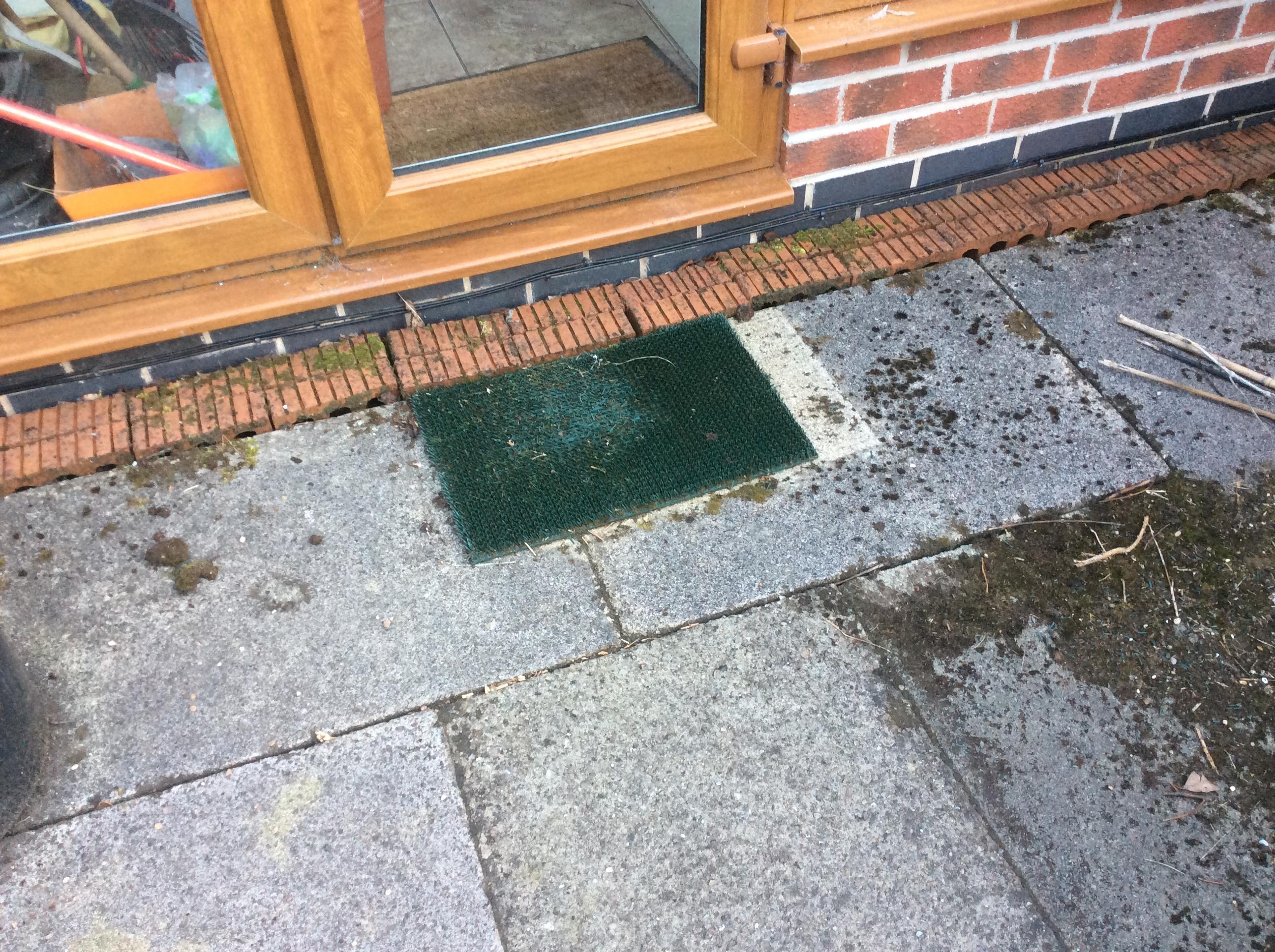

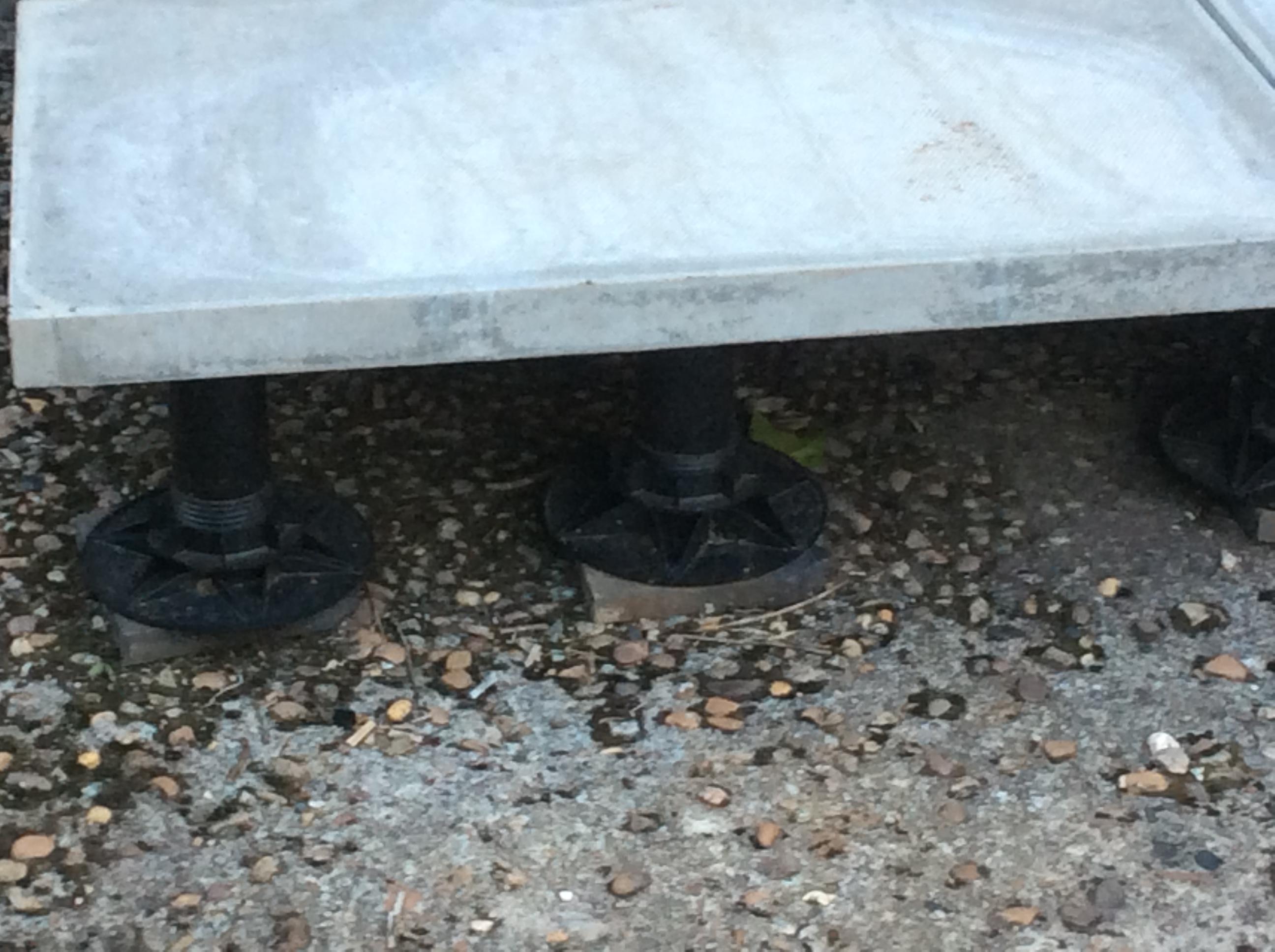

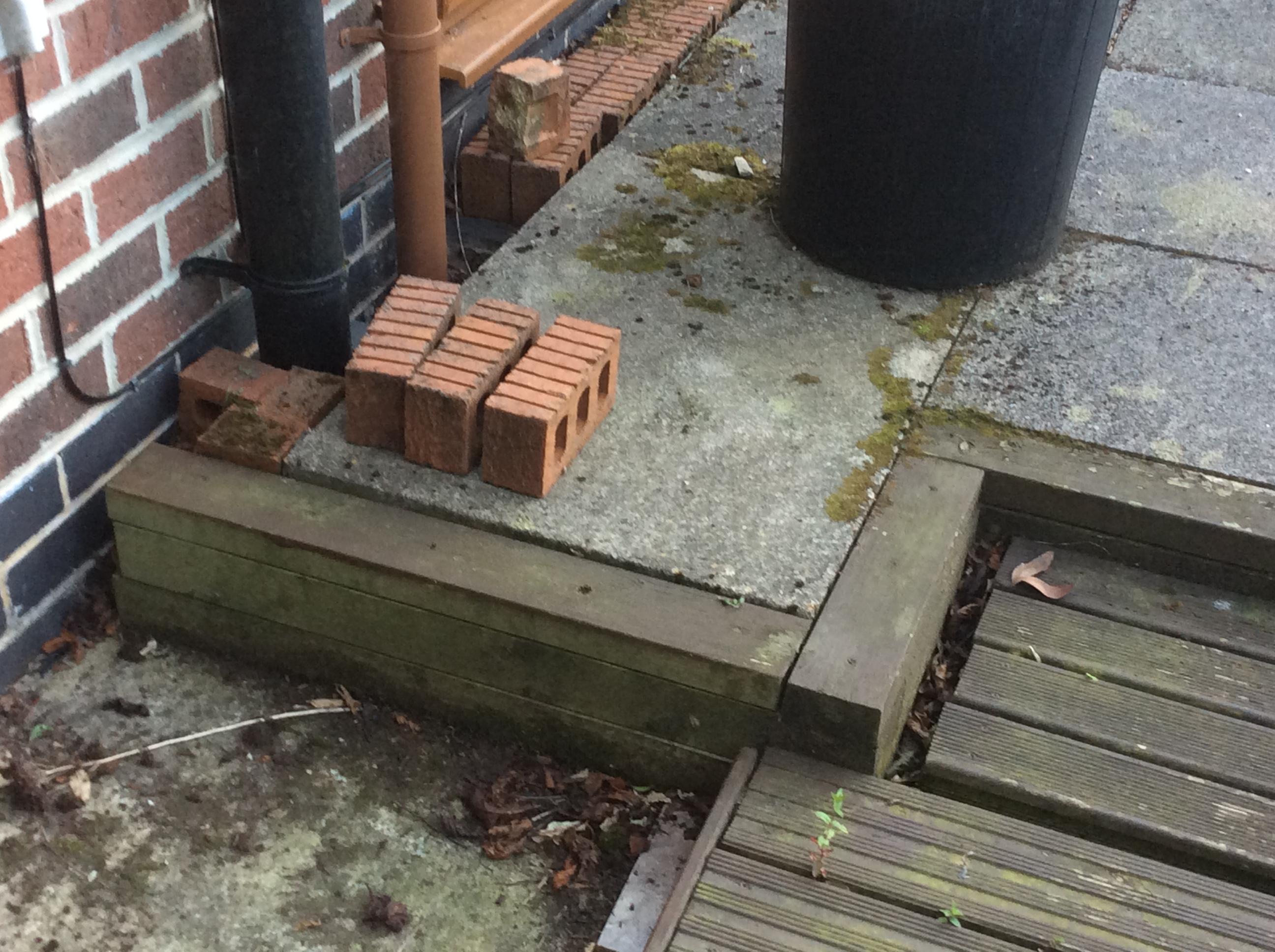

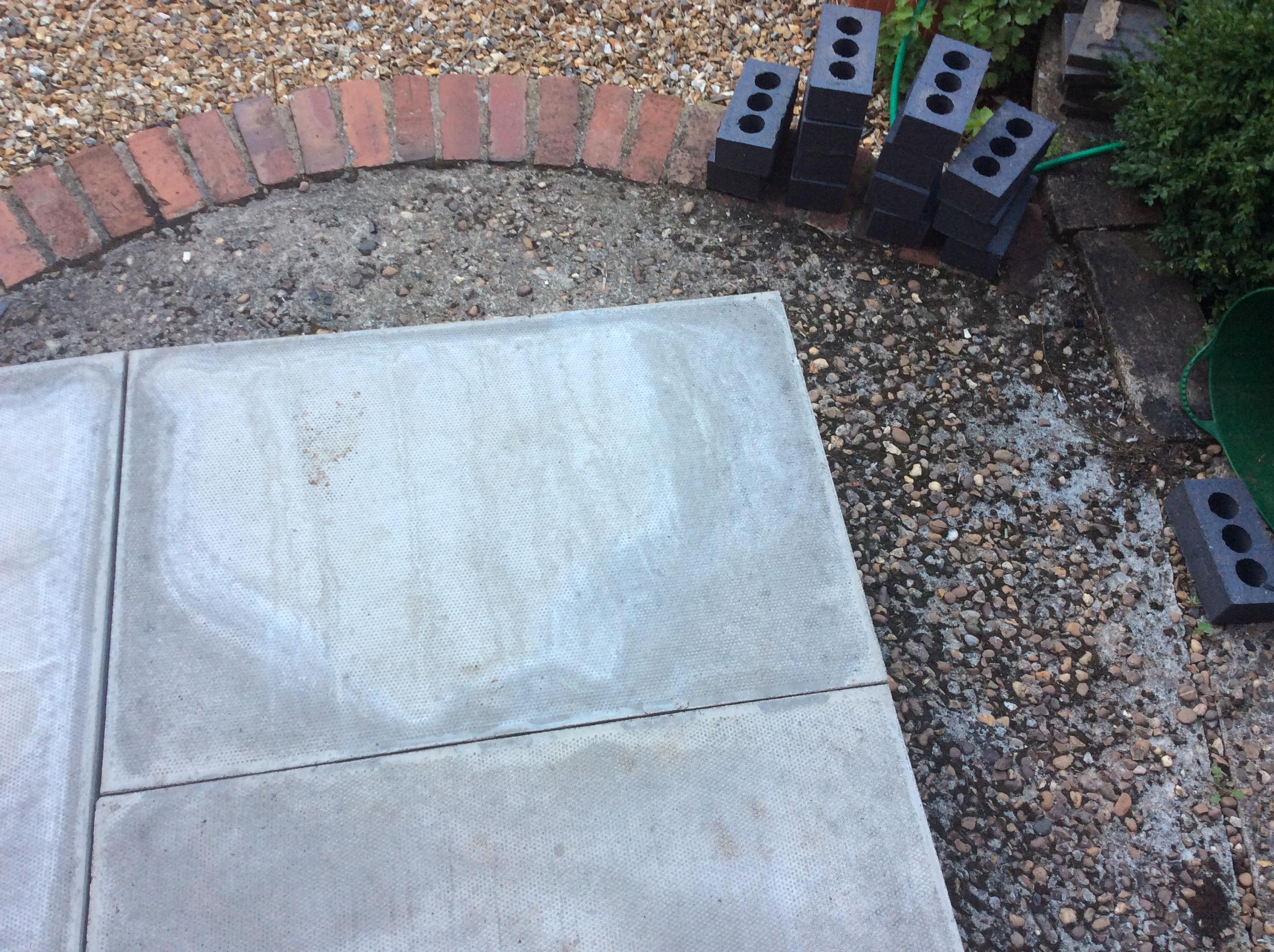

I have added few pics of the patio, better than my words (the old yellow and red slabs at the end of the new patio are all lifted, there will be grass there).

The whole patio / tiled area is built with a similar system (Eterno Ivica self levelling pedestals, I've attached a picture of the work in progress), but I wanted to give more lateral strength on the two sides (hence the two solid bases). Mainly because the tiles are not glued and the height is over 30cm. Having said that, it is rock solid, so no movement at all.
Maybe I could go ahead with the hybrid (aerated block + short pedestal + tile) solution described above in my reply to Temp. As the pedestals will be only 10cm (if not less) tall and glued down, any lateral movement should be impossible.

There is no wobble, but there is a micro slippage of some peripheral tiles. I can tell that the tile gap expands from 4mm to about 5mm in some points. This really annoys me!
I am convinced that the slippage is caused by the fact that the pedestals compensate for the uneven / sloped floor with a self levelling head, but the body of the pedestal itself is actually perpendicular to the sloped floor, so there is a tendency to shift in the direction of the slope (not sure if my description, in my own English, makes sense). This doesn't happen with the central tiles, as they block each other.
Eterno suggest to glue the metal insert that you put between the head of the peripheral pedestals and the tile, but the reason is mainly to avoid noises caused by metal against ceramic.

1 -  In my view,  it sounds as though your firbeglass planters may well be able to self  support to an extent,  and not need supporting over their full length (which could save some blocks and some work). You need to make a judgement.
2 - I have (will in a minute) attached a couple of  pics of my use  of the system. As you can see, I have done it with huge pavers, so nothing will move short of an intervention by a herd of elephants. The row of bricks  is me storing my spare housebricks in a channel which I also use  for  running satellite cables etc.
3 - I think the way I would suggest proceeding is to get your planters in, and get some blocks, then have an experiment to see what you think works before you commit to 300 blocks. If fewer will do it - so much the better.
4 - I would recommend putting a couple of drawstrings in under your patio at the sides whilst you can - if you may want to insert electrical cables, watering systems etc later. Alternatively you may decide that they will run happily behind your planters and can be added later.
