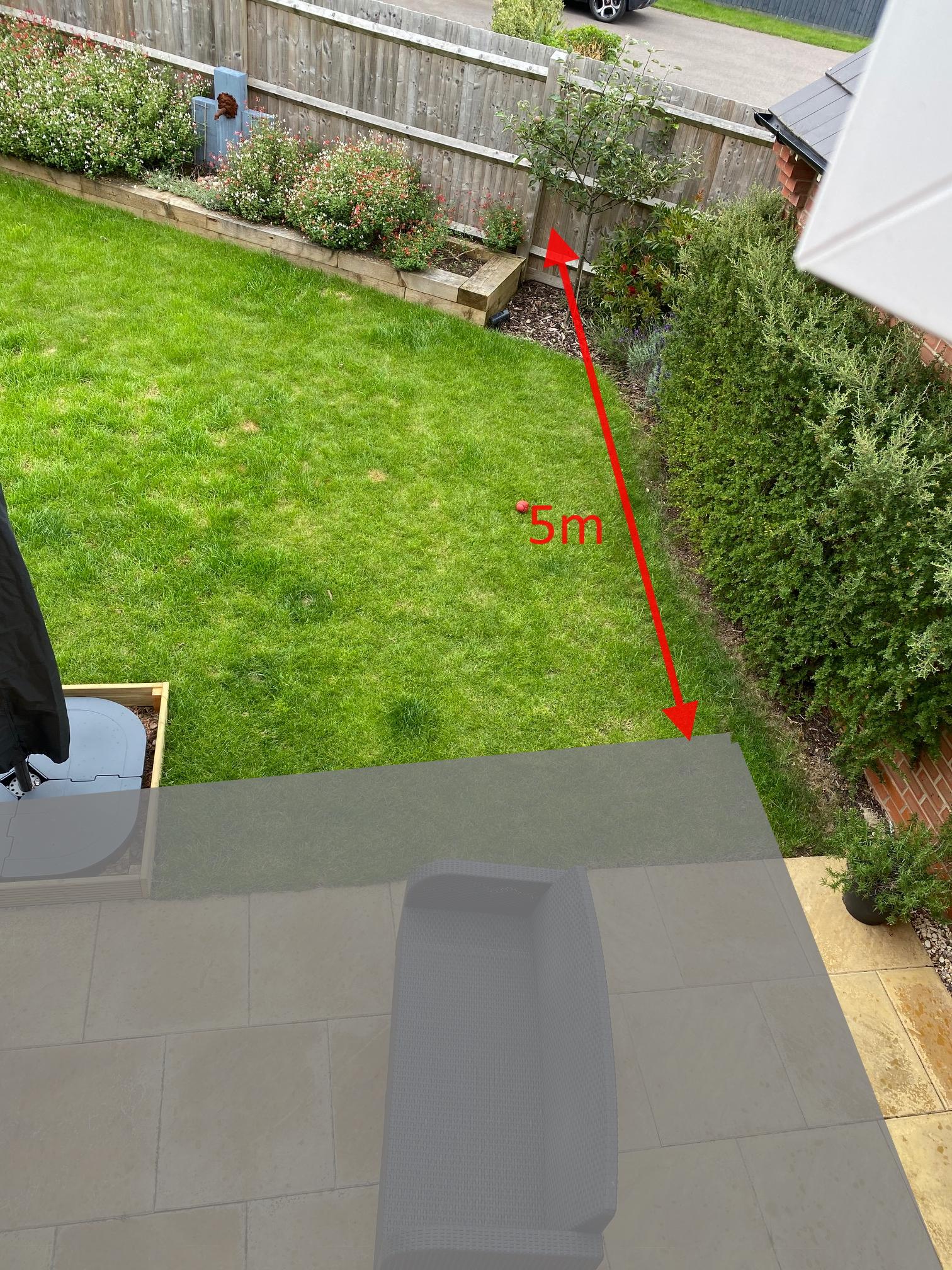

Laurence737 Posted July 3, 2020 Posted July 3, 2020 Hi Everyone, we are planning a full length extension with a half second storey extension in our property, as we have a tapered garden the nearest point on our extension will only be 5m away from the boundary of our rear neighbours access road and drive (it is a bungalow and we cannot see into their garden. I have attached a picture of the side with the two storey extension. Do you think this would form grounds for the planning application to be refused or do you think they are likely to be ok with it as it will only be overlooking the access road and driveway? Any help or advice would be greatly appreciated.
ProDave Posted July 3, 2020 Posted July 3, 2020 I thought the overlooking issue was if one set of windows faces another. I doubt that applies in this case.
Laurence737 Posted July 3, 2020 Author Posted July 3, 2020 That's what we thought as the front windows of the rear neighbour will be roughly 90 degrees off our rear windows. We were just concerned that we weren't getting the 7m from the rear boundary.
DevilDamo Posted July 3, 2020 Posted July 3, 2020 What’s the relevance of the 7m? Is that your LPA’s residential design guidance? Overlooking is normally considered when looking into neighbours’ gardens and is usually the rear.
Laurence737 Posted July 3, 2020 Author Posted July 3, 2020 The 7m was just from the planning website for the permitted development. So wondered if it would equally cause problems with our planning application? Extensions of more than one storey must not extend beyond the rear wall of the original house* by more than three metres or be within seven metres of any boundary* opposite the rear wall of the house.
DevilDamo Posted July 3, 2020 Posted July 3, 2020 Not necessarily as the two are completely un-related. The LPA should not raise any issues in terms of overlooking as it’s not normally considered for front gardens especially if the majority forms a driveway. They may obviously raise other policy concerns.
