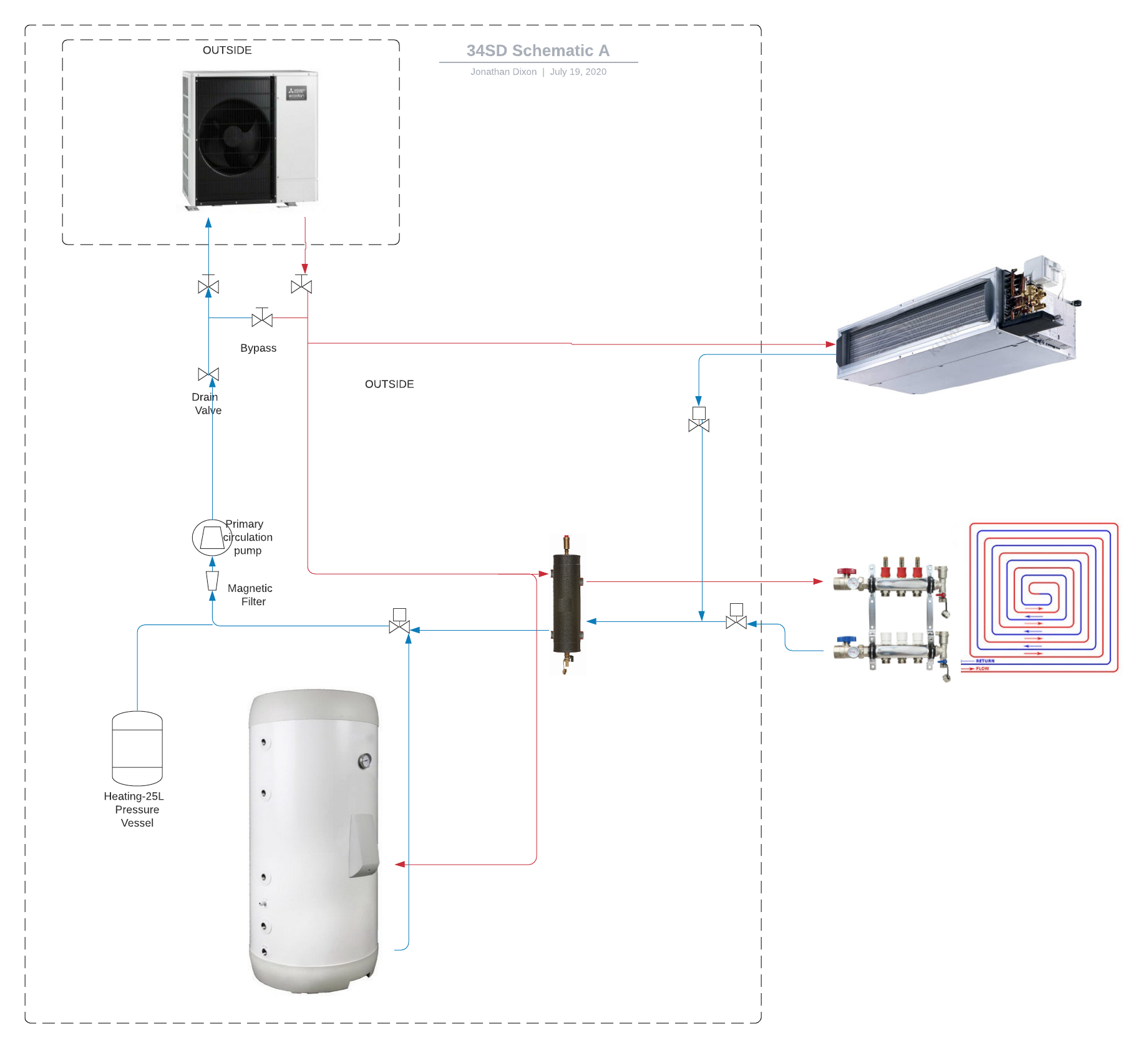

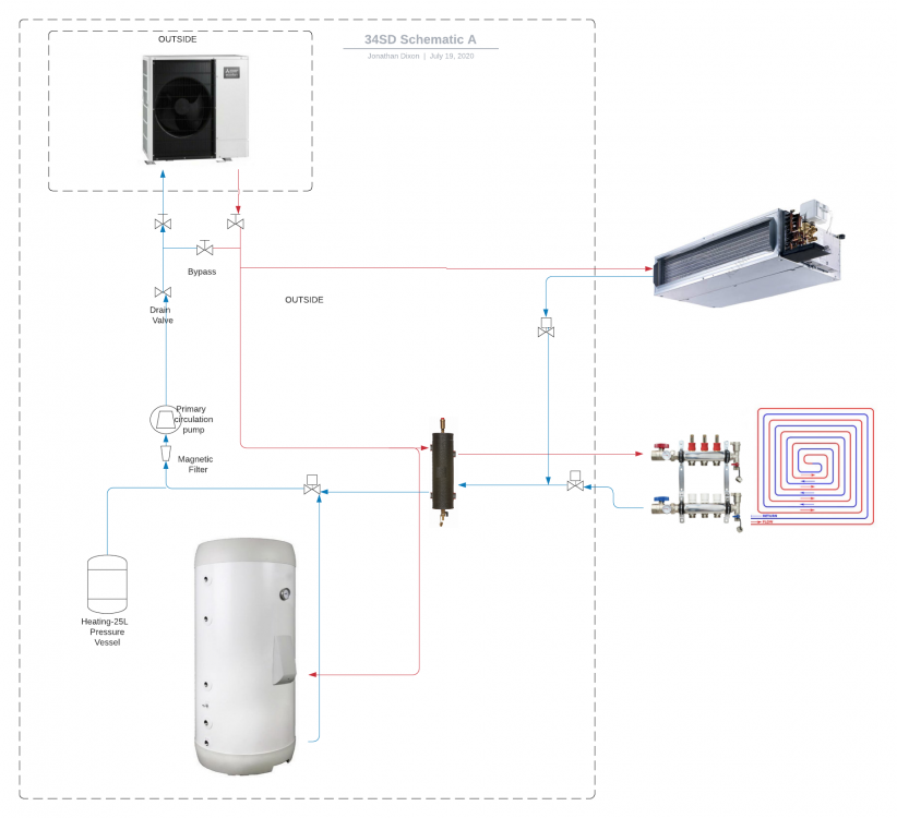

I played around with lucidchart.com yesterday and got quite far quite quickly. It's a bit annoying to connect the wires (pipes) to small components like valves, and the routing all goes a bit mental if you move things around too much, but for a free online app it's very usable.
(Still very much WIP, but gives the idea)
