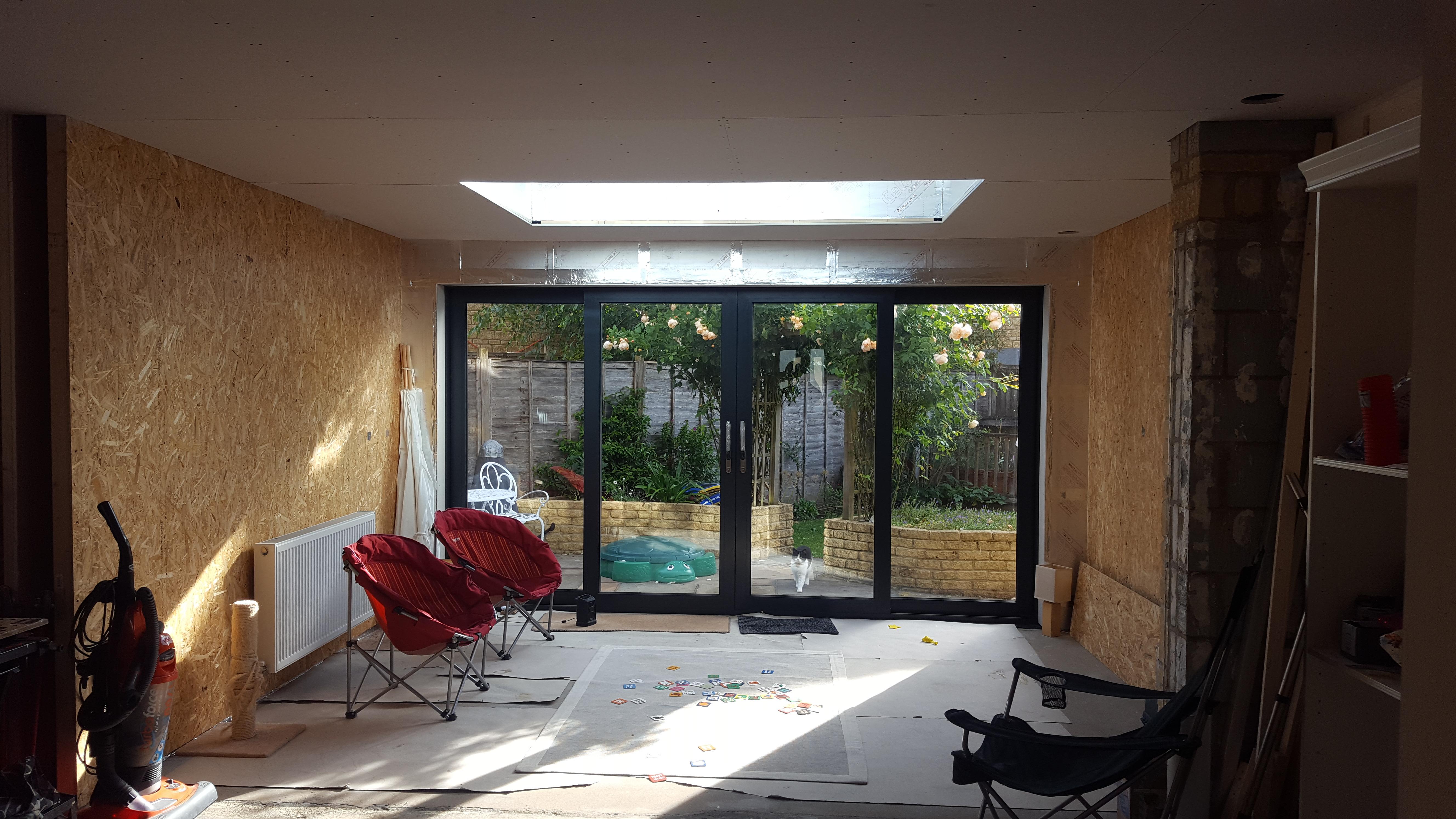

MJNewton Posted June 25, 2020 Share Posted June 25, 2020 (edited) Whilst not one of your options I thought I'd share what we did with a similar-sized opening (a bit smaller at 3.9m x 2.2m) even if just for you to firmly rule it out if it's not your cup of tea... Our room will be a lounge area with a layout such that we only wanted/needed a centre (not side) opening thus a 2 panel slider wasn't really an option and a 3 panel would mean only a ~1.3m opening which we didn't feel was wide enough when compared to the UPVC french doors we had previously. Hence, we went for a 4 panel, with 2 centre openers, thus given us a ~1.9m centre opening which, in practice, works really well for us and definitely feels wide, perhaps because it essentially represents half of the opening, the rest is glass so doesn't 'feel' closed as such and there's a natural thoroughfare through to the arch on the patio. I honestly don't think we'd want it wider based on the usage we've had so far. The doors are Reynaers CP130-LS and we've been really pleased with them. They've got chunky frames compared to most and whilst if we'd had a bigger budget (these were £5.5k fitted) I suspect we would've sought thinner ones at the time I don't think I would now having lived with, and got used, to them. If anything we now see the chunkiness as part of the appearl nd they match the roof lantern frame well. I guess if we had an ocean view things would be different! Incidentally, we were worried that as this is our (only) back door how they'd be day-to-day just for nipping in and out. Turns out to be a complete non-issue, perhaps helped by the fact that we don't have handles on the outside (only finger pulls) and so don't need to lock them on the inside so it's just a reasonably quick turn of the handle and go out. They've been better in many respects than a swinging door (e.g. on a bi-fold) as we can leave the door in an ajar position of any size (including a just-narrower-than-a-3yr-old width) without wind-induced slamming etc. I think our concerns must've stemmed from sliding patio doors of yesteryear but lift-and-slide are a completely different beast. So simple I'm surprised they haven't always been like this. Edited June 25, 2020 by MJNewton Link to comment Share on other sites More sharing options...
Dan_the_man Posted June 26, 2020 Author Share Posted June 26, 2020 Your doors look lovely @MJNewton Unfortunately they would not suit my layout. My middle access is very restricted due to island/dining table and living furniture placement. I have to have the opening on the left or right. Link to comment Share on other sites More sharing options...
