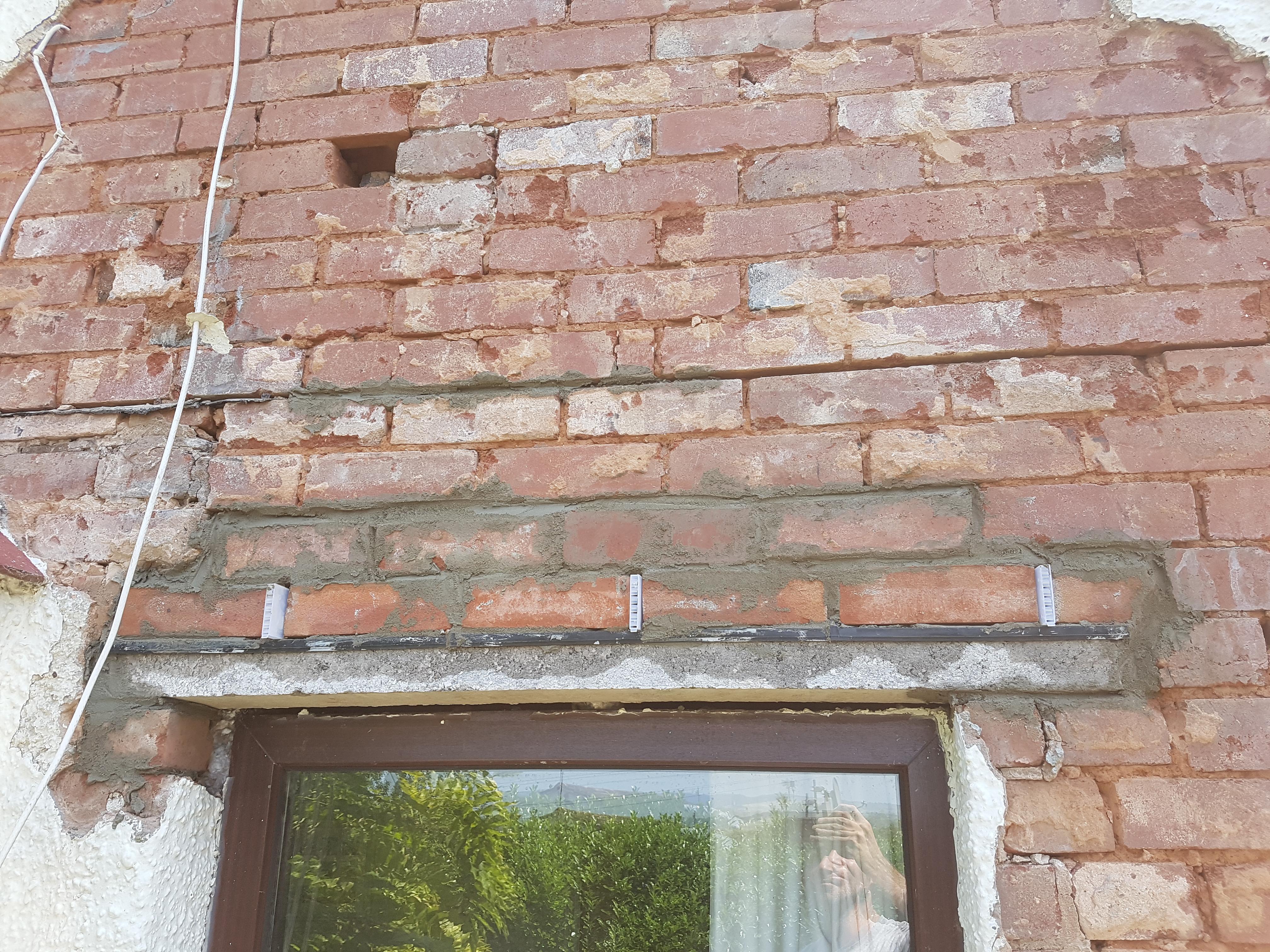

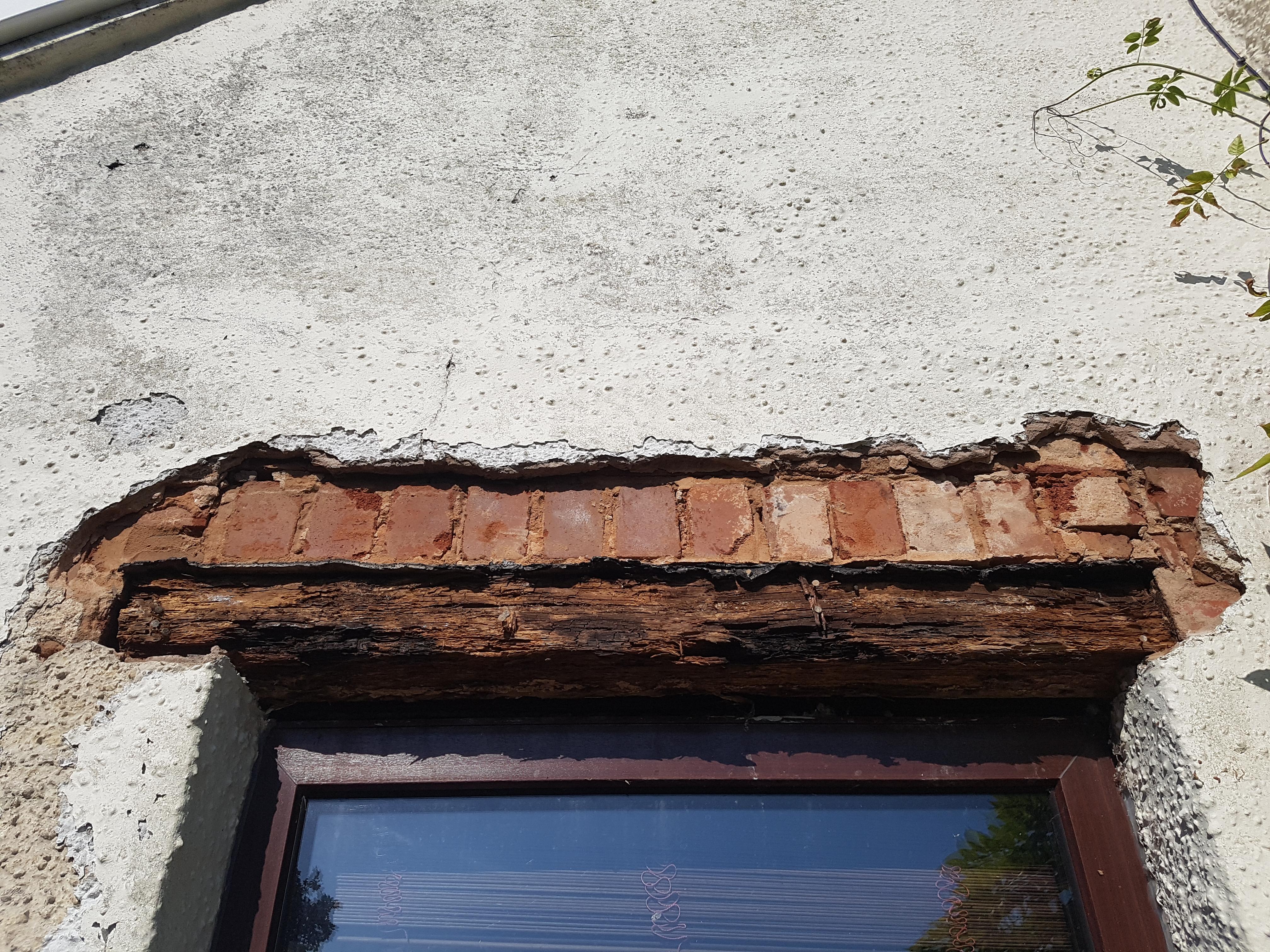

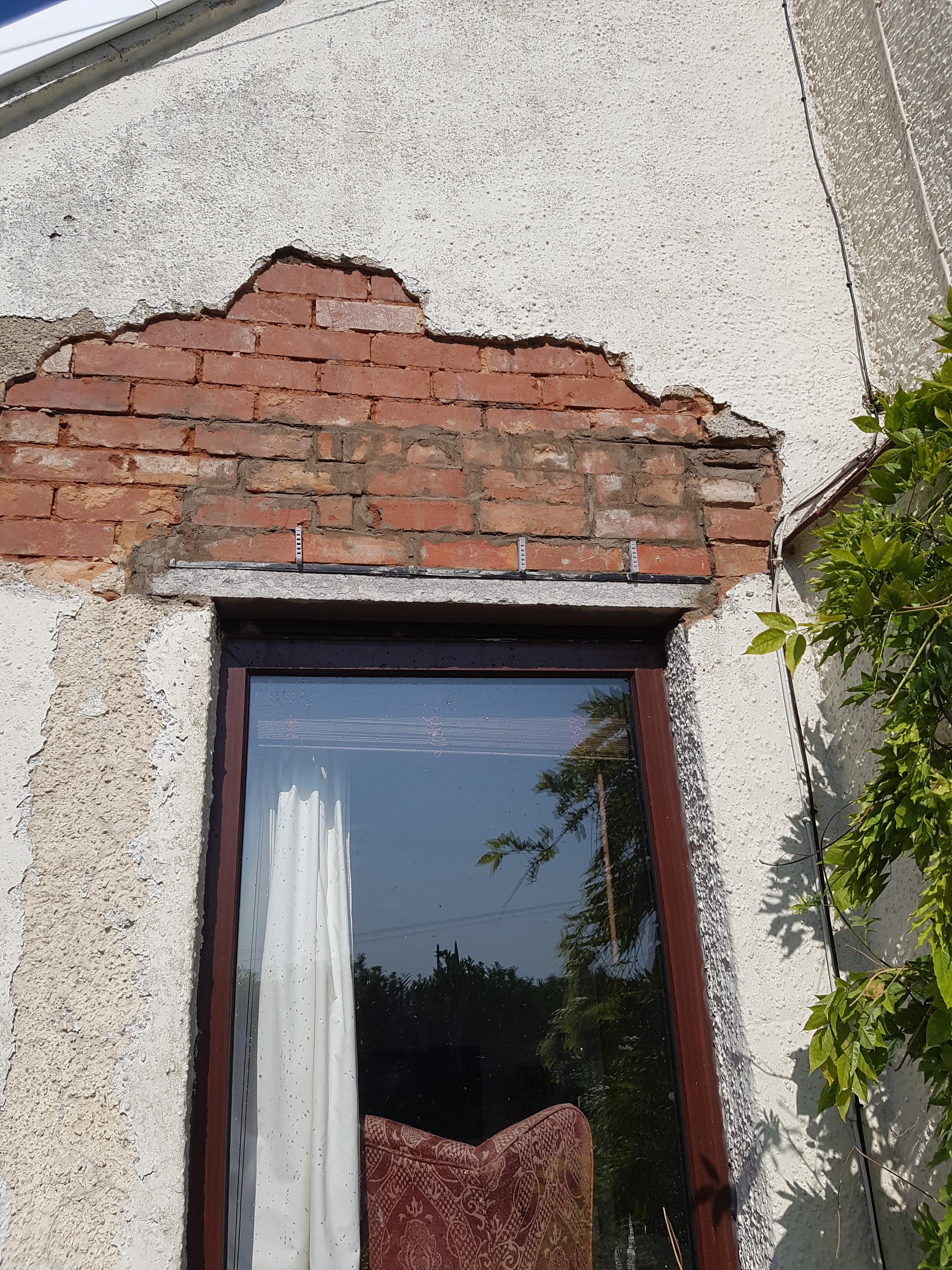

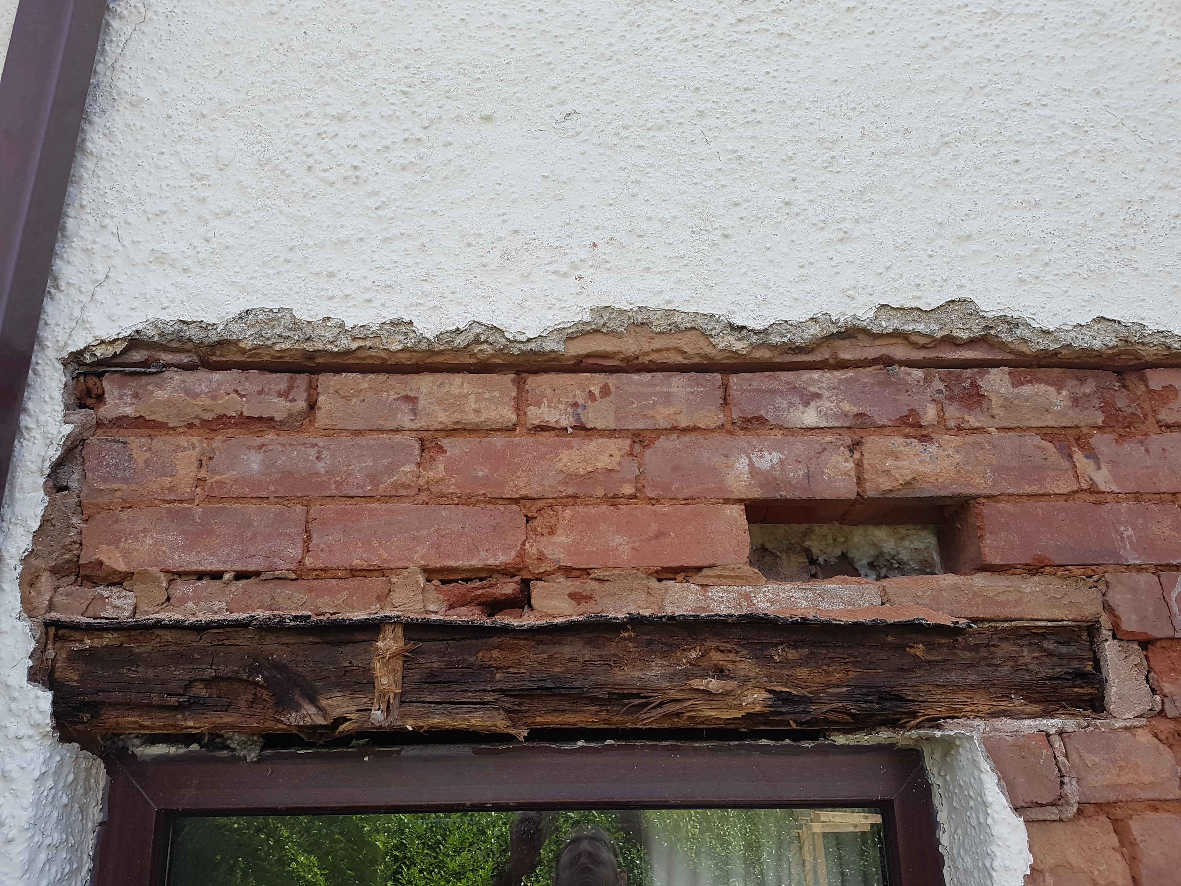

Moonshine Posted June 23, 2020 Share Posted June 23, 2020 I am feeling a bit chuffed, removing render from the out side of my house I found two very rotted out external wall leaf wooden lintels, age god knows, as below. These needed to be replaced, given I have a bit of time on my hands I decided to DIY it, so got some lintels, cavity trays and a strong boy from jewsons this morning, and gave it a go. Main thing was the house didn't fall down, but I actually got it all done in a day in the sun. Pretty happy with the results, though the brick work is appalling!!! Not sure what the going rate is for lintel replacement, but feels like I have saved a fair chunk of money. 5 Link to comment Share on other sites More sharing options...
