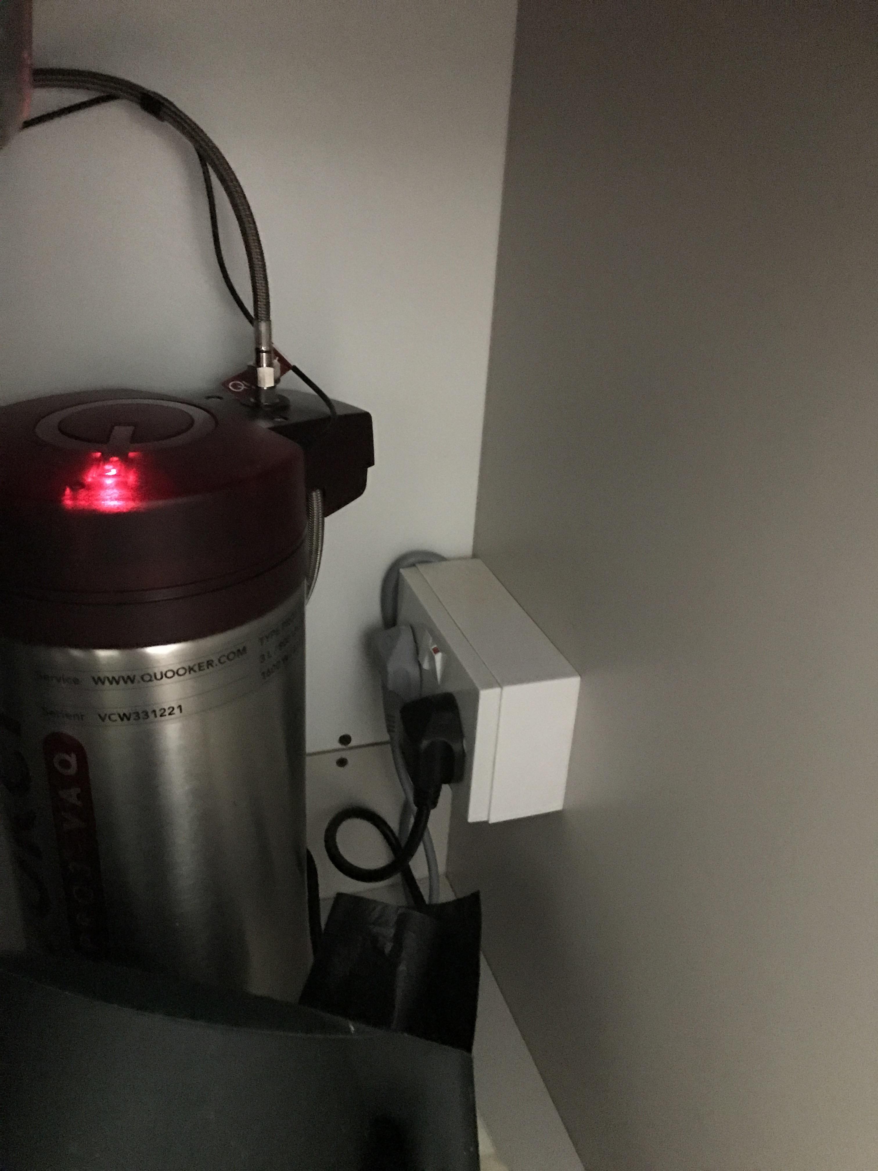

daiking Posted June 23, 2020 Posted June 23, 2020 Does a boiling water tap require any specific electrical supply or just off a decent ring main? (I.e. recent install without eleventy-four bodged spurs off it already) Under the sink there is a single socket for the dishwasher on a kitchen ring main. That switched socket is connected to a wall mounted grid switch isolator. Kitchen wise, the monster hob is on its own monster supply and the 2 ovens are on different circuits so maybe there’s 2 rings in here.
daiking Posted June 23, 2020 Author Posted June 23, 2020 45 minutes ago, nod said: Quooker and dishwasher on the same D socket Cheers. Does that have an above worktop isolator as well? The 3 switch grid I have is for the dishwasher, fridge and extractor fan. But if the Quooker is plug-in then they should already be a suitable rating.
nod Posted June 23, 2020 Posted June 23, 2020 2 minutes ago, daiking said: Cheers. Does that have an above worktop isolator as well? The 3 switch grid I have is for the dishwasher, fridge and extractor fan. But if the Quooker is plug-in then they should already be a suitable rating. Yes

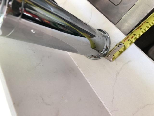

daiking Posted June 23, 2020 Author Posted June 23, 2020 The under sink cupboard is full of crap so everything will fit and there’ll be some way to tap in the waste pipe. My concern from looking at the installation guide is that the current tap hole is only 40mm from the edge of the worktop/sink, not the specified 70mm. It can’t be easy fitting it in the 100mm gap behind the sink but that must be the same for any replacement tap.
daiking Posted August 6, 2020 Author Posted August 6, 2020 On 23/06/2020 at 10:23, nod said: Quooker and dishwasher on the same D socket @nod that looks like the boiler unit is on the deck. Does that mean the £100 bracket is not required? Also, does anyone have the COMBI unit? I’m wonder is if it’s worth the extra. It does take a while for hot water to get to the kitchen tap. Having instant hot water would be very convenient.

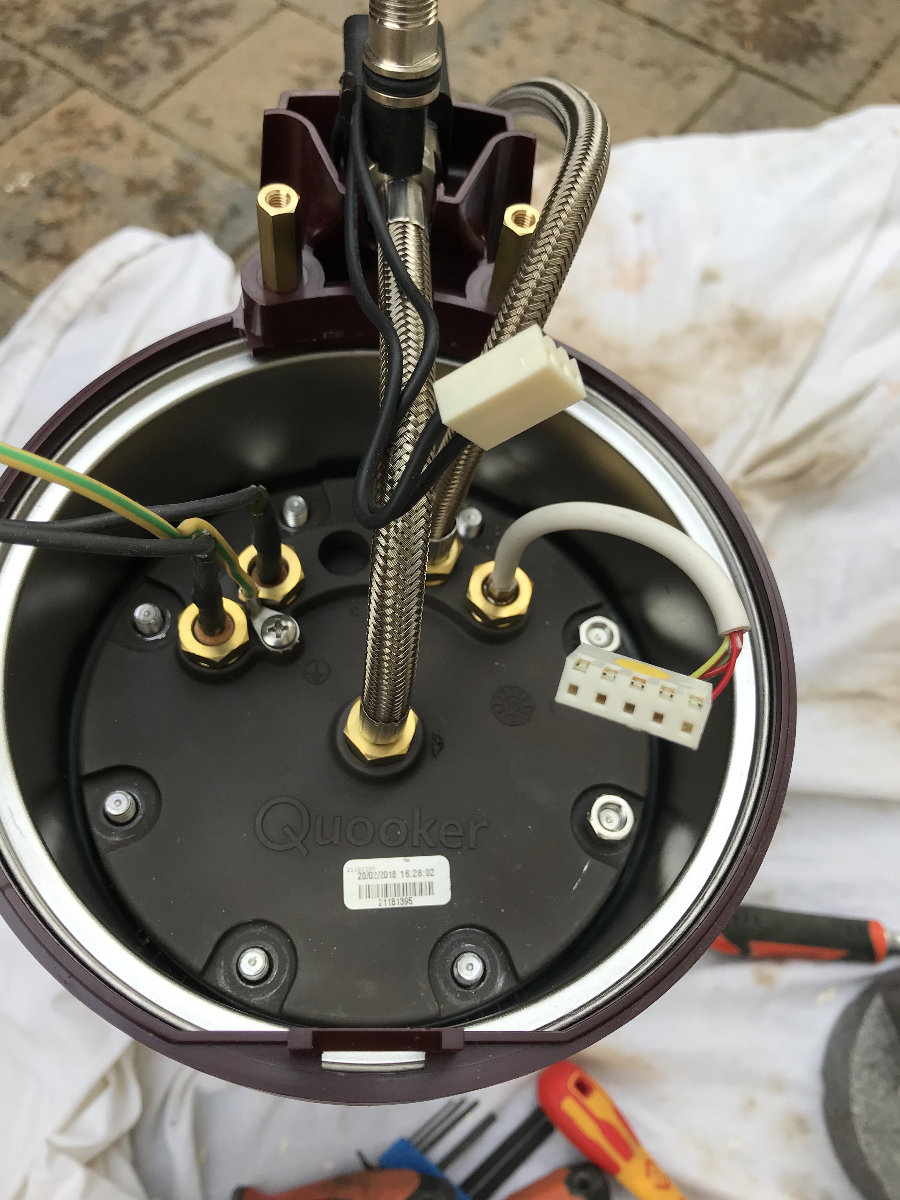

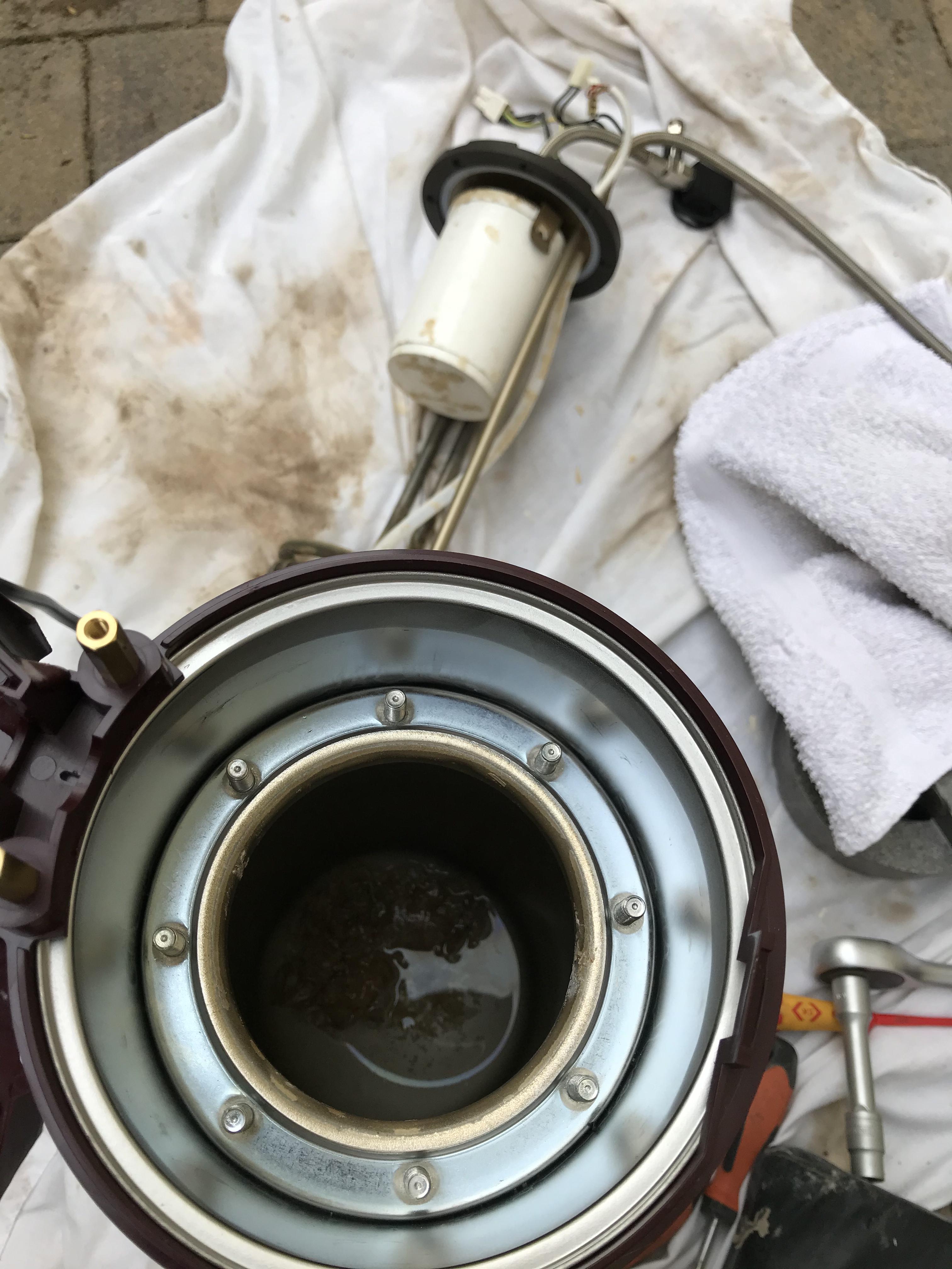

nod Posted August 6, 2020 Posted August 6, 2020 My wife chose the German kitchen Spent £££££ on quarts work surfaces I chose the Quooker Money well spent The unit is absolutely fine free standing Quite stable when full The two years guarantee was disappointing Parts only We did have a problem after twelve months But I found the unit easy to dismantle and clear the limescale I combined unit is on my shopping list for our next build
ryder72 Posted August 7, 2020 Posted August 7, 2020 14 hours ago, nod said: My wife chose the German kitchen Spent £££££ on quarts work surfaces I chose the Quooker Money well spent The unit is absolutely fine free standing Quite stable when full The two years guarantee was disappointing Parts only We did have a problem after twelve months But I found the unit easy to dismantle and clear the limescale I combined unit is on my shopping list for our next build Have you had the scale reduction filter installed? Highly recommended.

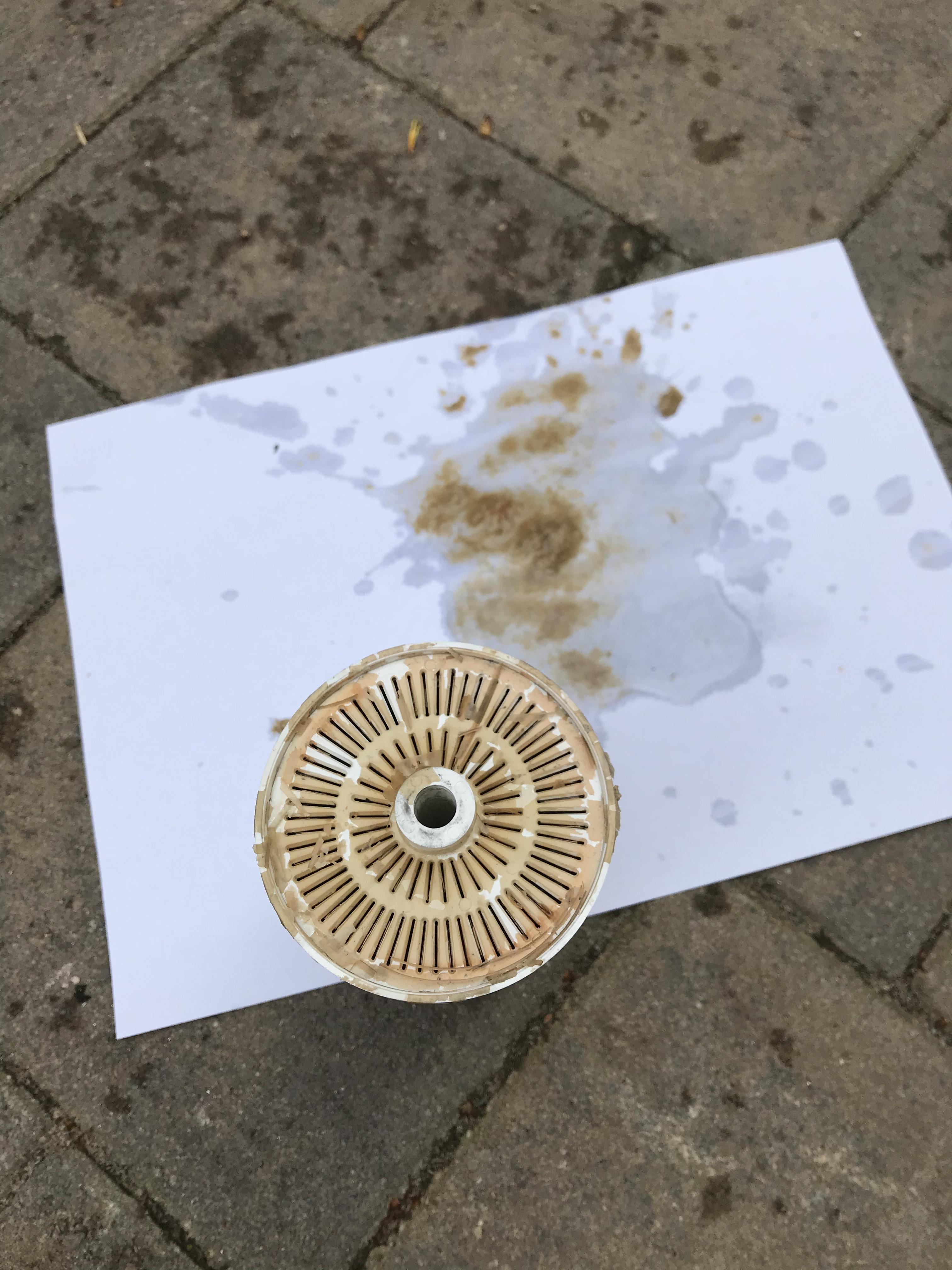

nod Posted August 7, 2020 Posted August 7, 2020 No I simply removed the internal filter and flushed it out It works perfect now I was surprised how much was in there We are in a soft water area 1
daiking Posted August 7, 2020 Author Posted August 7, 2020 5 minutes ago, ryder72 said: Have you had the scale reduction filter installed? Highly recommended. Really? ?
nod Posted August 7, 2020 Posted August 7, 2020 8 minutes ago, daiking said: Really? ? Exactly I thought I’d be in there with a pin ? The problem we where having was that we would come home and the tap would be flashing and running cold Quick reset 20 minute wait and all was fine For two or three days

nod Posted August 7, 2020 Posted August 7, 2020 We where told 3 to 5 years I would say it’s worth removing the filter and cleaning it each year
