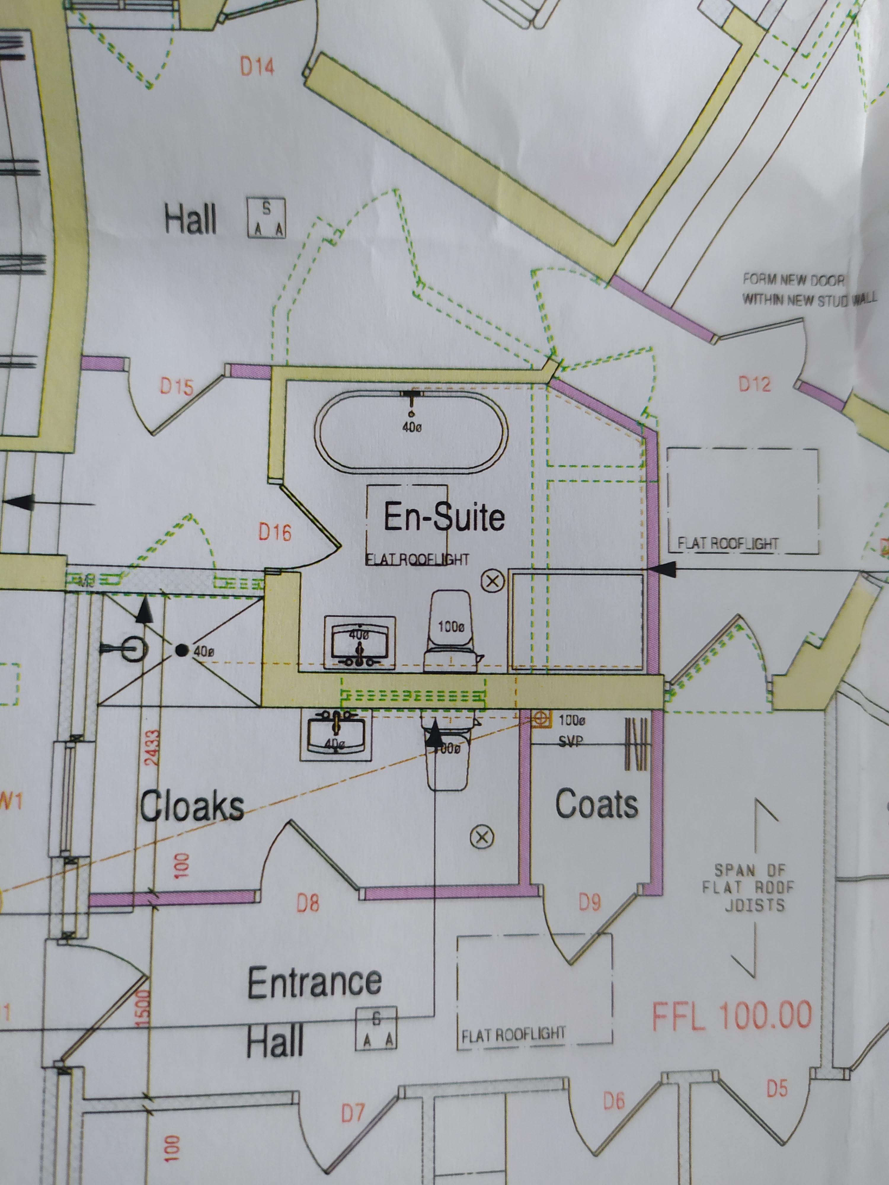

Looking at the gap the walk in shower was meant to go tonight and it is smaller than what I thought, I mean it is as it was on the plans but seeing it seems far smaller and I'm now wondering what is best.
It's 1320mm and ideally we just want a walk in one with no sliding or pivot door just a glass and a slim tray which needs to fit in between the walls on the Cloaks on the plan. I'm guessing it would be better to have a 1200 size tray to allow for tiles/wall covering and 1300 tray sizes don't seem common.
Every walk in shower I've seen this size isn't between two walls. Is it viable to have a walk in shower fitting in this size or is the gap to walk in going to be too small?

Oooh thanks. Builder said 1200mm would be better but I'm pushing for a 1300mm tray. 100mm makes a big difference ?
The issue will be what we have on the walls and thickness. If we went for that one we would only have 20mm spare....

Is this in the ensuite?
Why is the shower not running along the other side of the corner?
If it is butted (sorry) up against the loo, you need to think carefully about how you will clean all the different bits.
Mine is butted up against a bath, and I deliberately went for a narrow bath to give me a comfortable hand width to clean between.
If you mean the one in the cloaks, that should be Ok if you get your wall coverings right.
Tiles or panels drop onto the top of the tray anyway ... You can also use panels direct onto blockwork so saves on boarding out too.
@Ferdinand No the cloaks.
I'm not happy with the ensuite shower positioning for the reasons you mention and need to sort that, especially as we have our freestanding bath already purchased! The bath/shower location in the ensuite needs tweaking. We initially weren't having a shower in there but we both realised we needed one for washing hair after a soak in the bath.... Long story.... It could even be a corner one and not that big either. Need to speak to the builder about that.
