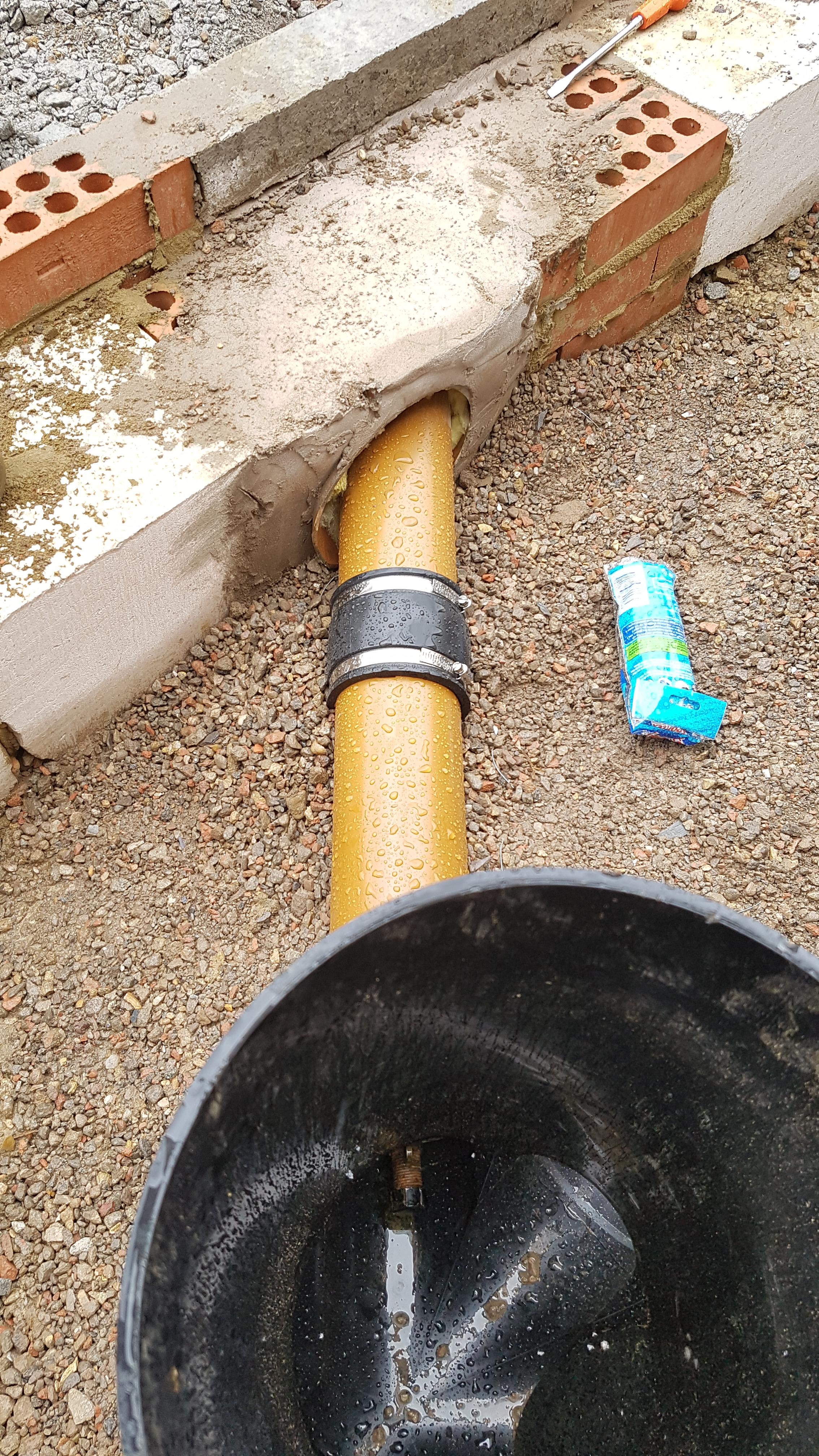

Posted
Easier to post this than find the thread from anonymousbosch
This is sleeved in 6" pipe but should be 8" if by the book. Stuff the gap with insulation and stainless steel scouring balls
