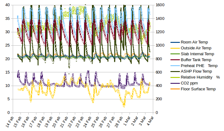

Jeremy, I did a quick plot of this, for the benefit of others.  The temps are in °C, the RH in %, and the CO2 PPM are on the right hand scale.
Jeremy-data.png.db16a4f1ef7a006e2a53126e8ef5701d.pnge PPM is on the RH scale.

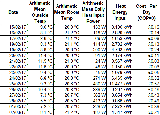

Thanks Terry, I've been crunching the numbers a bit to see what the heat power and energy input is, and have made this little table:
The cost column on the right isn't exact, because I've assumed a heat pump COP of 3, when in reality it may well be over 3 some of the time, or even under 3 occasionally, plus the cost assumes 100% import, which isn't that likely; the chances are that at least some of the heat pump power is coming from the PV array, even on dull days.  Even so, it looks like the house will only cost around £1 or so per week to maintain at a fairly steady 20 to 21 deg C, which is pretty good.  The room thermostat was set to 20.5 deg C, with a 0.1 deg C hysteresis.  The house is empty most of the time, with just me there for a few hours each weekday, and no cooking, showers etc to contribute to heating the house, so this is close to a worst case, in terms of heat requirement.
For the benefit of any statistics whizz reading this, the daily arithmetic means were calculated by summing the 6 minute sample values and dividing by the number of samples per day.  It's interesting to see the way that the relatively cold 24th February didn't really impact the heat input until the 25th February, due to the long thermal time constant.  For those reading this and thinking about "thermal mass", it's worth noting that this house is a lightweight construction, entirely made from timber, with the exception of the 100mm thick concrete slab and the ~15mm plasterboard and plaster skin inside; even the insulation is made from wood, in the form of blown-in cellulose.
Edited by JSHarris
Error in data descriptions - now corrected

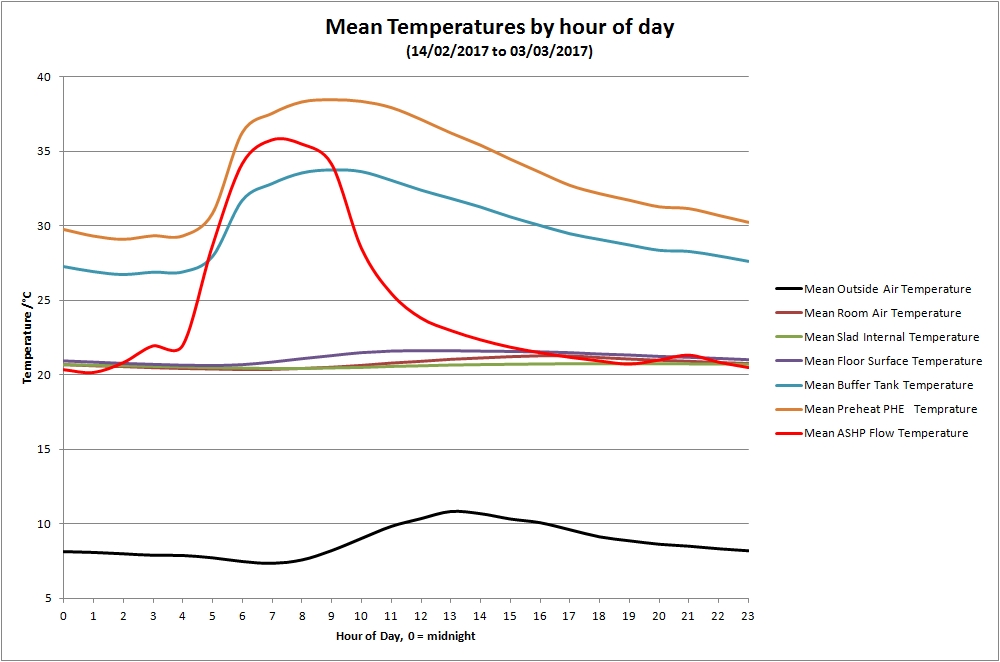

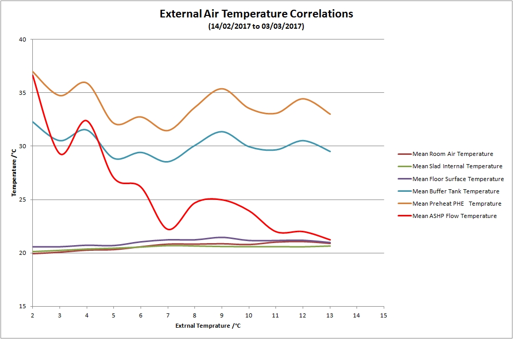

Right, have had a little play this morning and produced two charts.  One is the correlation between the invariant of external air temperature and the other against time.
I picked these two because we have no control over them and can therefore be used to both correlate and draw implications.
There is really not enough data to draw very precise data for the long term, but as the floor surface, slab internal and room air temperature are amazingly stable (basically within the accuracy of the sensors) the 11°C external temperature swings that have recently happened are a good indicator of overall performance.
As Jeremy a already said, the ASHP is coming on at around 3AM for about 3 hours.  This fits in with the coldest part of the day, though may not be the best time to start heating.  That depends on lifestyle and how you like your house heated (It would suit me as I like a warm evening).
The slab, on average, has the highest temperature at about 2PM until 1AM.
Room air temperature peaks at about 4PM.
On the Correlations, everything is pretty flat except the Mean ASHP Flow Temperatures.  This is to be expected because if the outside air is warmer, the ASHP will be working less often, rather than delivering a lower flow temperature.  This will force the mean flow temperature downwards.

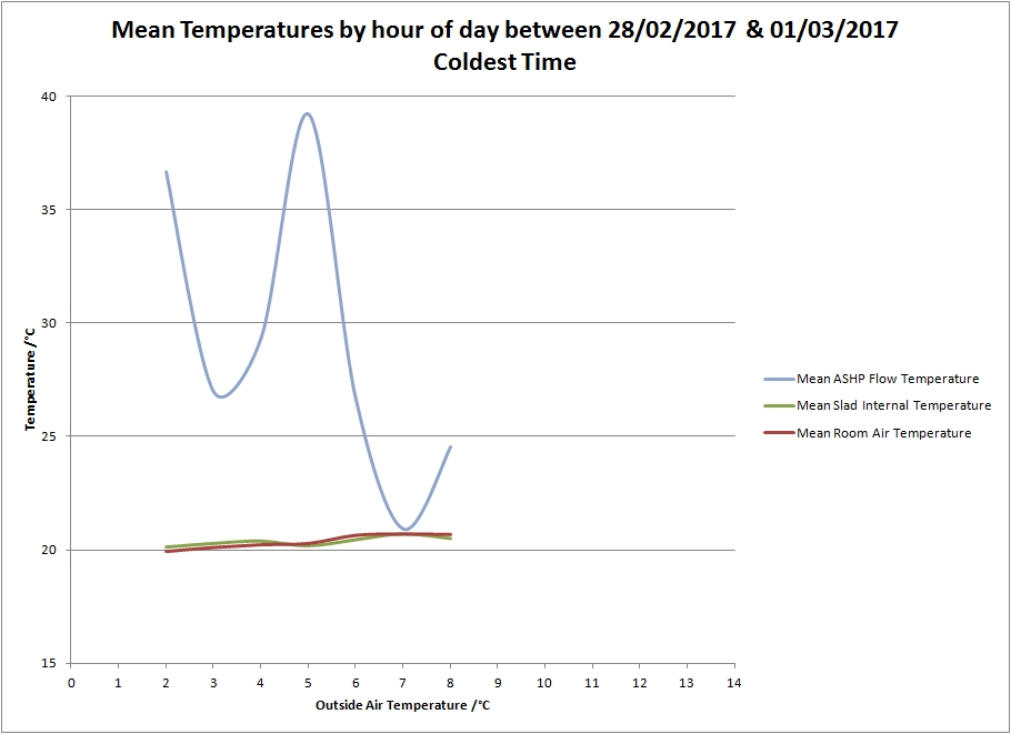

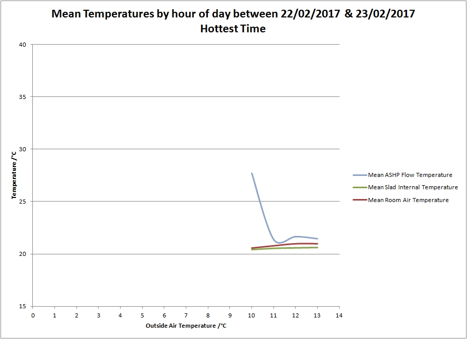

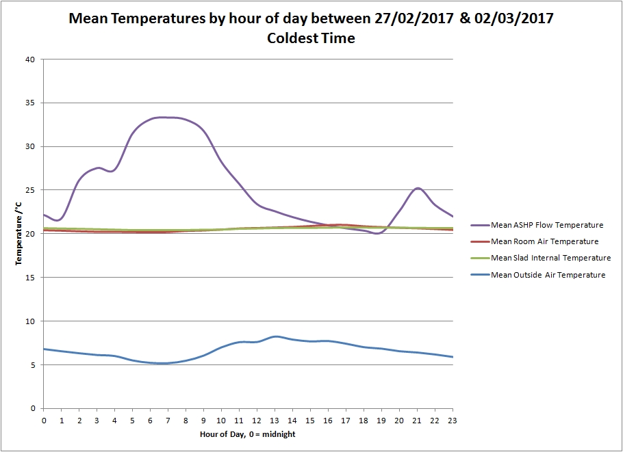

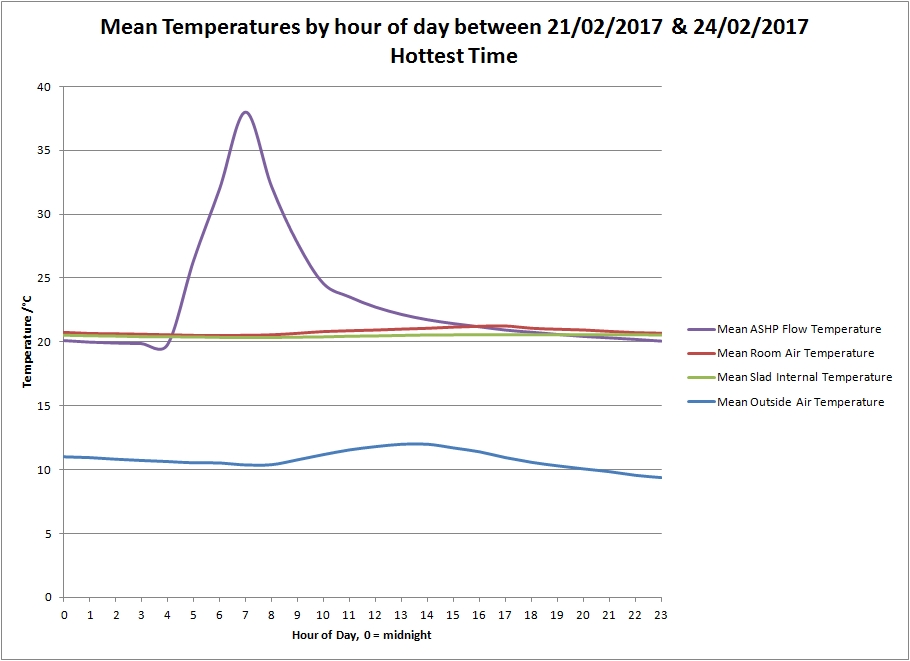

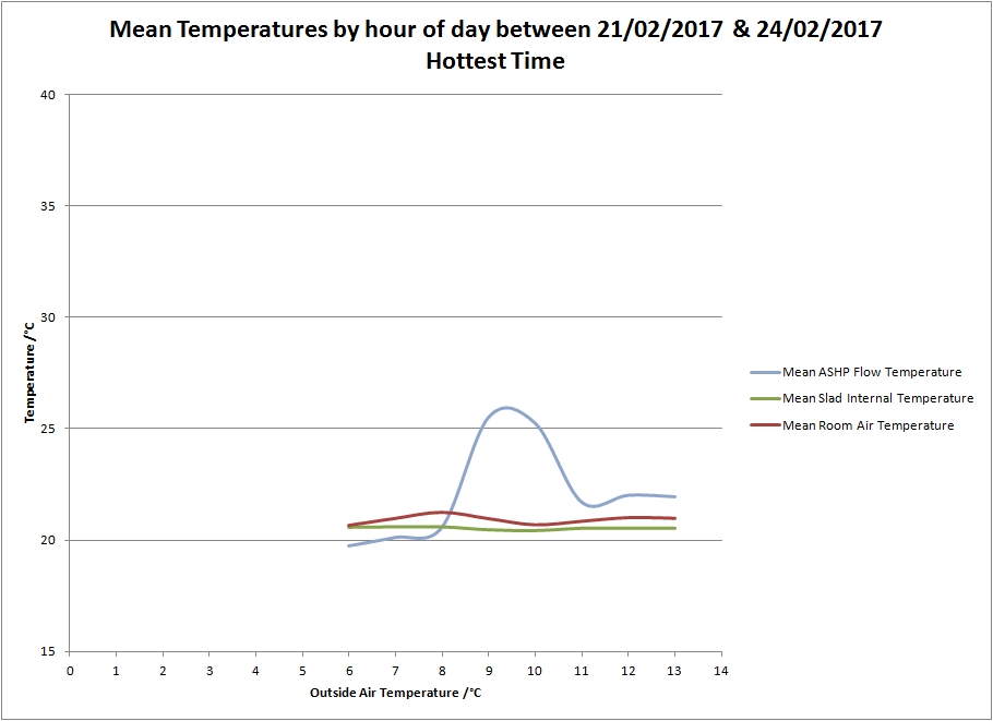

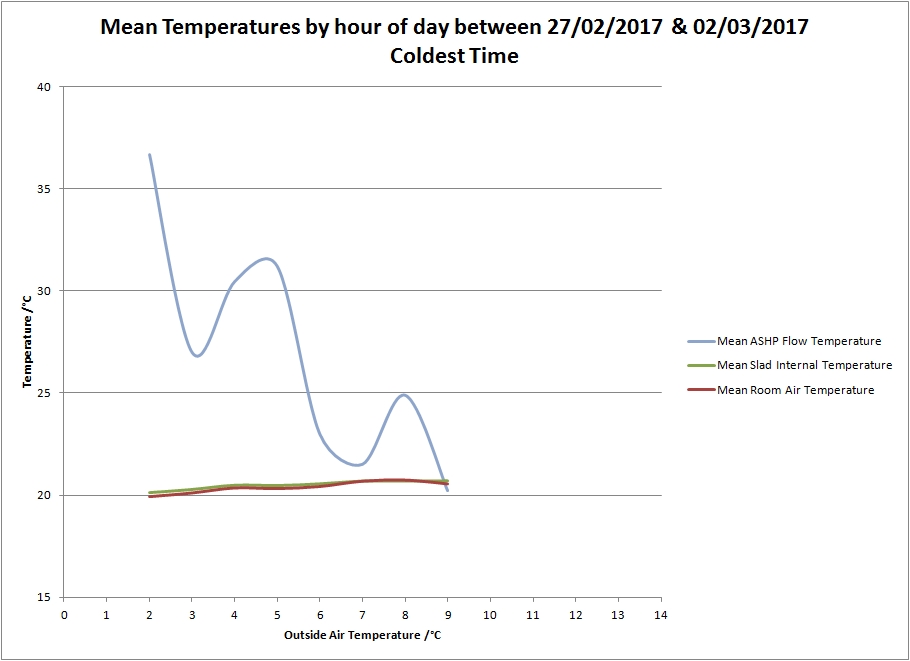

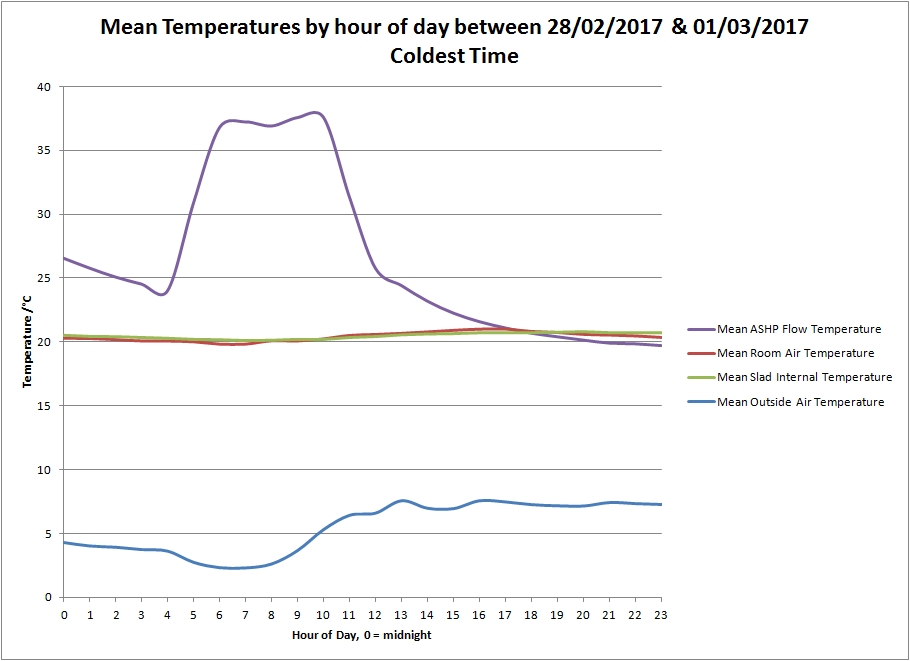

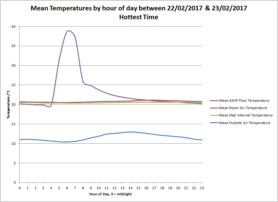

Right, a few more pictures.  I notice that the time between maximum ASHP Flow temperature and there it crosses the slab temp plot on the cooling cycle is pretty consistent at about 8 hours.
Not sure what these plots really show, other than you could shift the time that the ASHP is working to take advantage of the PV without affecting the house temperature unduly (less than a °C I would think).  This would take away for car charging time, which is probably a greater cash saving.
The charts, are for the hottest day and then including the two days either side, then the same for the coldest time.

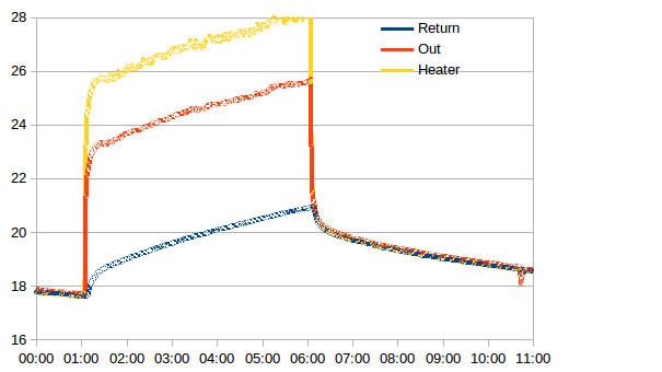

Just out of interest for those that want to compare "real-world" results to the model shown on the previous page, here is a plot take from our commissioning runs where I had our Willis heater running for 6hr at Economy 7 low tariff (cost ~£1.40).  The house is still warming, hence the slab is still dumping heat into room space.   But it's already got to the point where I am stripping off jumpers when working.  The overall conclusions are:
  • The slab is reacting pretty much as I modelled it.
  • The output of the Willis is easily enough to heat our house.
  • Our actual flow rates through the slab on the pump's middle setting are about half what I estimated, hence the out:return delta temp is nearer 5° rather than 2° but this doesn't matter.
  • At this cost even if I use E7 electricity to heat my house the annual running costs will still be less than out BGas maintenance contract on our current boiler.
  • The Willis is simple cheap and effective.  Even if you have an ASHP or alternative, then it;'s still worth considering fitting one as a fallback heater
Trust the physics, but validate your assumptions.

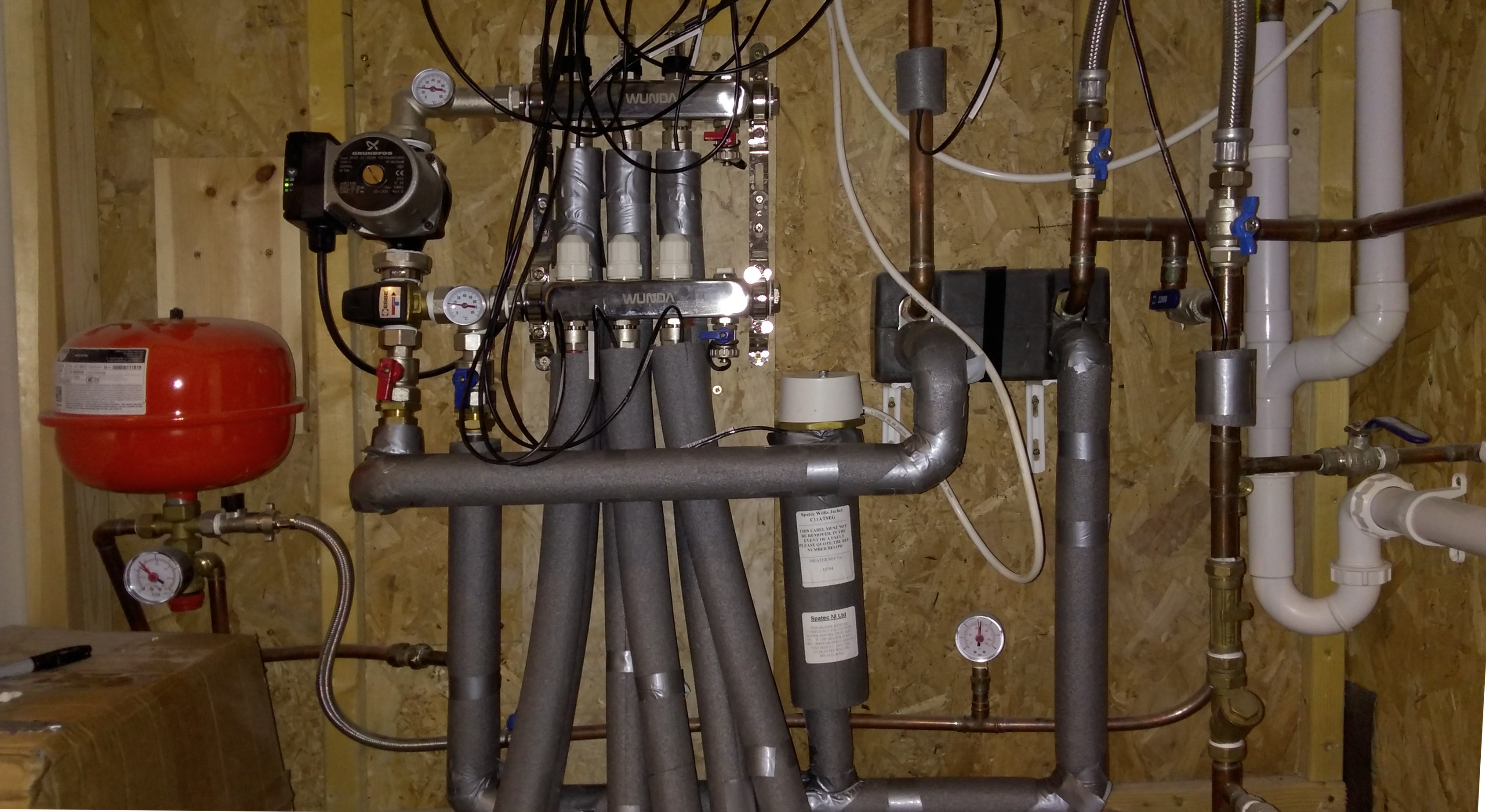

Funny you should post this, Terry, as several times over the past few weeks I've been thinking of the simplicity and low capital cost of using a Willis Heater.  I've even been tempted to dismantle the base at the front of the airing cupboard to see if there is room in there to fit one, primarily as a back up at this stage, but with thoughts that I could could divert excess PV to it, once the Sunamp PV is charged.  Days like today, when it was pretty clear and cold, would be good days to just stick some extra heat into the buffer tank, even though the house was sitting at around 21.5 deg C and the heating hasn't been on for a few days now.  I did expect the heating to have been on this morning, as it was sub-zero last night, but the house still seems to have plenty of stored heat in reserve, and with the early morning sunshine there was enough solar gain to warm the house.
Link to comment
Share on other sites

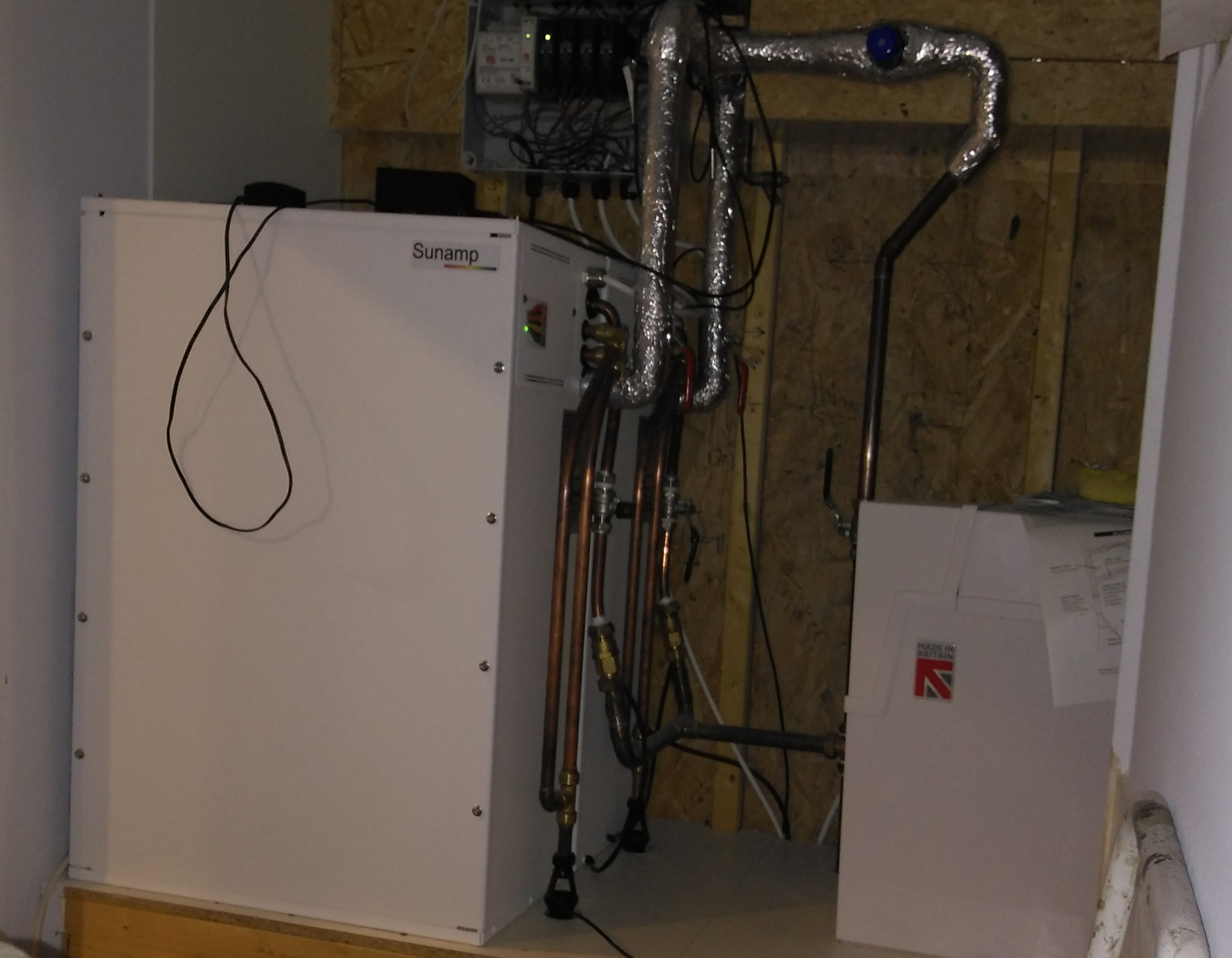

I've included the upper and lower levels of my system.  This is the lot -- CW + Filter + DHW + CH all in a cupboard some 1.2m × 0.7m off the side of my ground-floor loo.  The hot-works are all lagged.  The system is stripped down to its bare essentials, and only electromechanical bit is the UFH pump.  If running your CH on this costs maybe ~ £200 a years and my current BGas boiler maintenance contract is over £300, then its hard to make any payback case for anything more complicated.
DHW_CH-upper.thumb.jpg.db70e13bf8e4f6d79d6b3a5400f3dd7c.jpgDHW_CH-lower.thumb.jpg.fc8666d7c5d4d500953d39c341ea3cfb.jpg
At the moment the heat exchanger preheats the DHW mix (which is the reason for the notch in my output temp above.   If I do decide to use an ASHP, then I'll pinch this HE and prime it from the ASHP.
