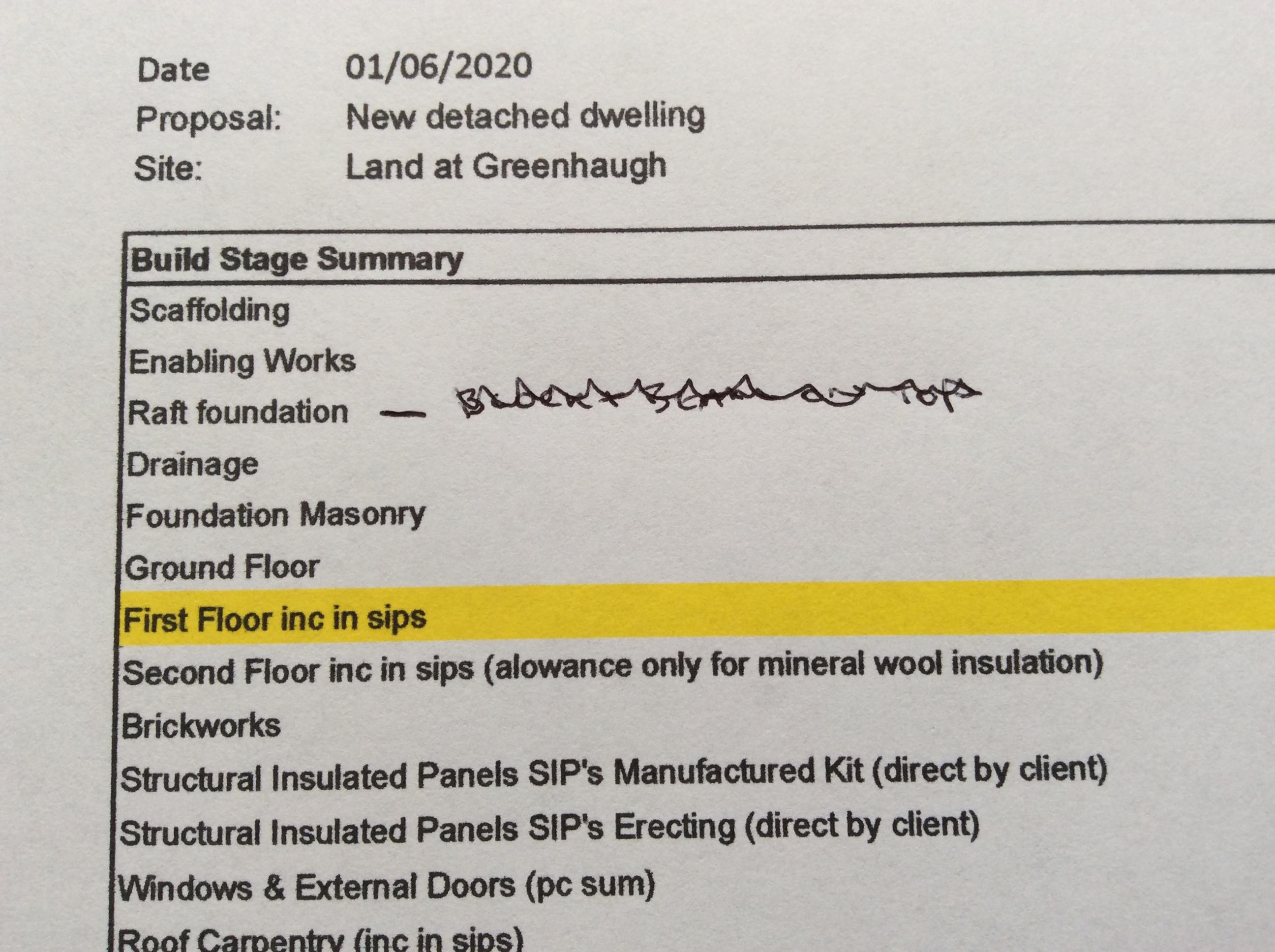

Taff Posted June 9, 2020 Posted June 9, 2020 Confused.com! Morning can anyone help please. Within my build stage summary see pic. would anyone know what the foundation masonry is? there’s a raft with a block and beam structure on it what else would be required Ta
PeterW Posted June 9, 2020 Posted June 9, 2020 Looks like block and beam has been removed..? Raft with beam and block would be a bit odd tbh - foundation masonry is your below ground/below DPC brick and blockwork
Taff Posted June 9, 2020 Author Posted June 9, 2020 Thanks Peter, Our option was to be raft however For what ever reason due to the ground conditions this had to be re looked at. we were going for piles but they would have incurred a lengthy delay. So engineers came up with 250 raft with an elevated block beam plan. Don’t know why or how as I’m not clever enough. We might even utilise the space under the beam! So just to confirm the foundation masonry it would be below the block and beam level? And my thinking that this entry entry would then not be required? thanks
PeterW Posted June 9, 2020 Posted June 9, 2020 Have you got any section drawings as that doesn't make sense

PeterW Posted June 10, 2020 Posted June 10, 2020 I think between the architect and the SEng, you've got a bit of a mongrel... So if the SEng wants a raft, you then should be building up from that and looking to reduce your cold bridging. Building a raft, then using a perimeter blockwork and filling the inside with your insulation and capping it off with a concrete screed, and then build up the SIPs off the edge blockwork. You then dispense with the beam and block floor as it becomes an irrelevant cost. Insulation could be EPS rather than PIR - so cheaper - and you can design out the cold bridging. If the SEng still insists on a beam and block floor then look at one of the insulated ones such as tetris as you can kill two birds and get a better and lower insulation value with a thinner floor build up.
