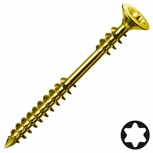

Onoff Posted June 5, 2020 Share Posted June 5, 2020 It's a common problem to have floors nailed down with angular ring nails like this: Far better is to use SPAX flooring screws: Ask me how I know! Our upstairs (ring nailed by hand) is 18mm T&G chipboard on 400mm centres and it initially had terrible problems. The SPAX have made it better but it's still not perfect. All the noggins appear hand nailed so I think they might be part of the problem. Link to comment Share on other sites More sharing options...
pam Posted June 5, 2020 Author Share Posted June 5, 2020 hi there thanks for your quick response. we definitely used spax flooring screws as my husband bought them. he wanted Timco collated screws but couldn't source them and therefore went for the spax 4.5x60mm screws. we don't have any noggins in the main part of the floor which along with the joists not being secured to the concrete floor is what's causing it to squeak... I think... Link to comment Share on other sites More sharing options...

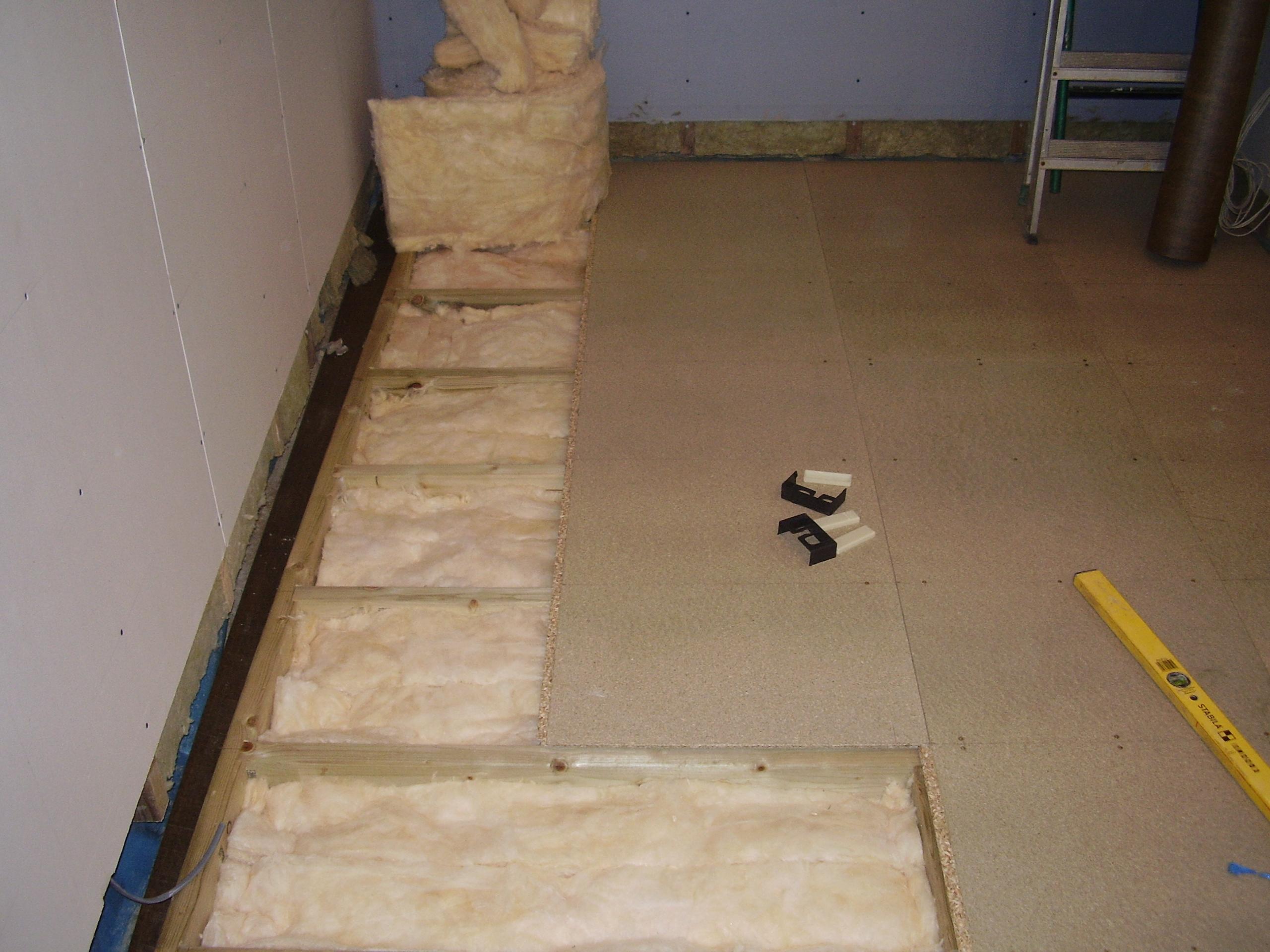

Onoff Posted June 5, 2020 Share Posted June 5, 2020 I did a similar floor downstairs: - Original concrete subfloor - 2 layers of waxed building paper - 4x2 CLS @ 400mm ctrs (in effect a glued & screwed stud wall laid on its side) - 100x100 ply packers - thickness to suit. These slipped under the floor joists with a big slug of D4 glue at each point. -22mm T&G affixed with SPAX It's the best floor in the house. Not a peep of noise and rock solid. Might sound a mad idea but I wonder if you could pour some sort of self levelling compound in through some discreet holes to flow under all the gaps? Maybe via a solid board cutter: Link to comment Share on other sites More sharing options...

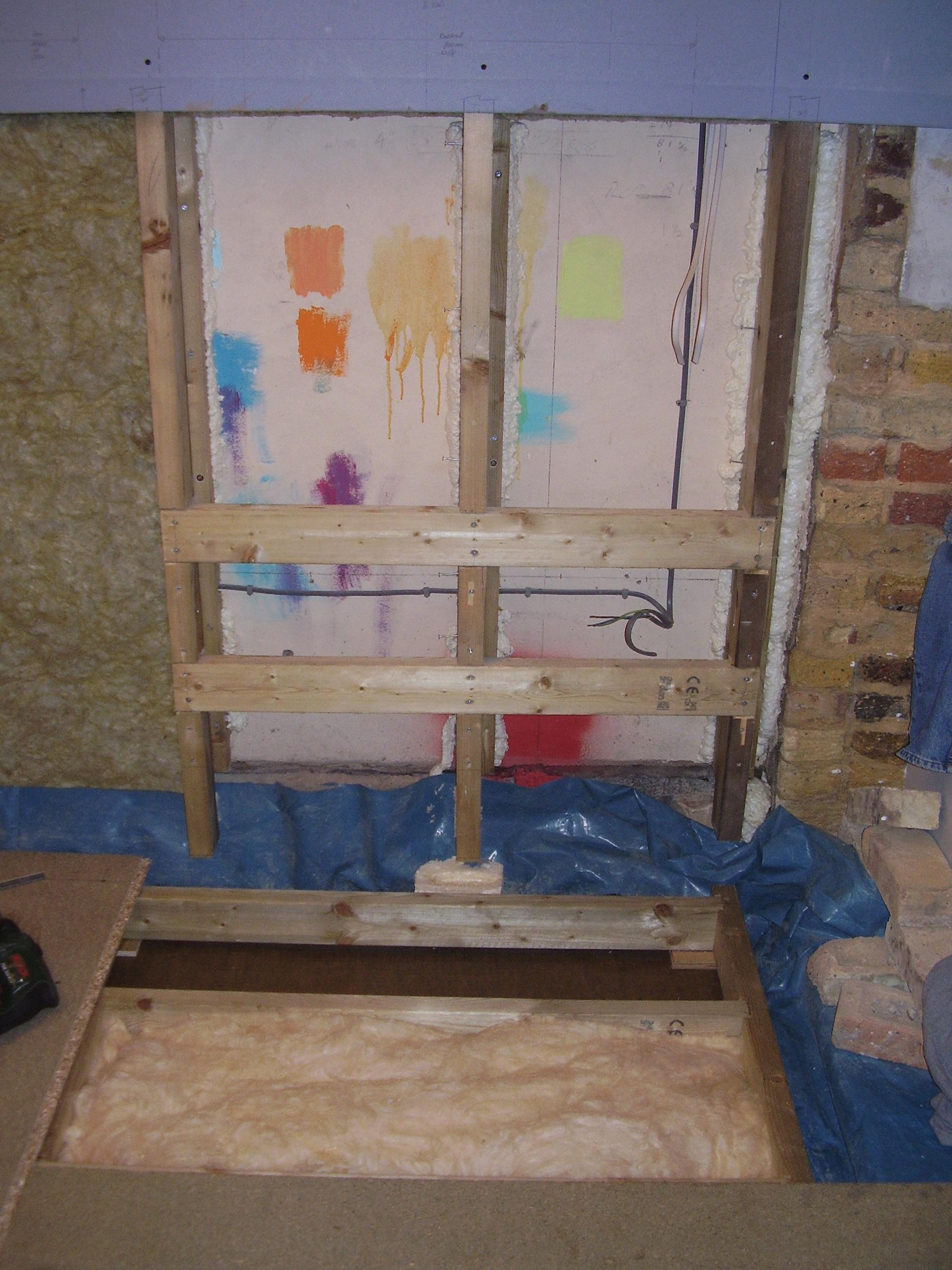

Onoff Posted June 6, 2020 Share Posted June 6, 2020 (edited) My CLS is not secured to the concrete floor in any way whatsoever. Not got many photos of back then but a few. We had a low boot room / coal store that was lower than the rest of the house. (Previous owner used to breed rabbits in there). I simply put a DPC down, 2 layers of wax building paper (no idea why) then made up a glued and screwed "stud wall" which I then laid down flat. The "frame" has a gap underneath. You can just see 2 of the 100x100 ply packs. I laid the frame down and figured how much it had to come up to meet the adjacent floor. Then just slipped in ply packs to suit the gap at that point be it 6, 9, 12, 18, 24mm etc. I lifted the frame off the packs and put a big squrt of pva between ply and underside of the CLS then left to dry. Rock solid is an understatement, no squeaks whatsoever! Widened the doorway, studded the walls etc: I've only got 100mm of roll insulation between joists. There's also a deliberate gap all round the floor frame. I had some mad idea it would be good for airflow/to stop damp! ? NB: This was before I discovered the forum or I'd have done it all different with UFH and masses of insulation under the floor that I'd have had to dig deeper. Hindsight eh! Edited June 6, 2020 by Onoff Link to comment Share on other sites More sharing options...
