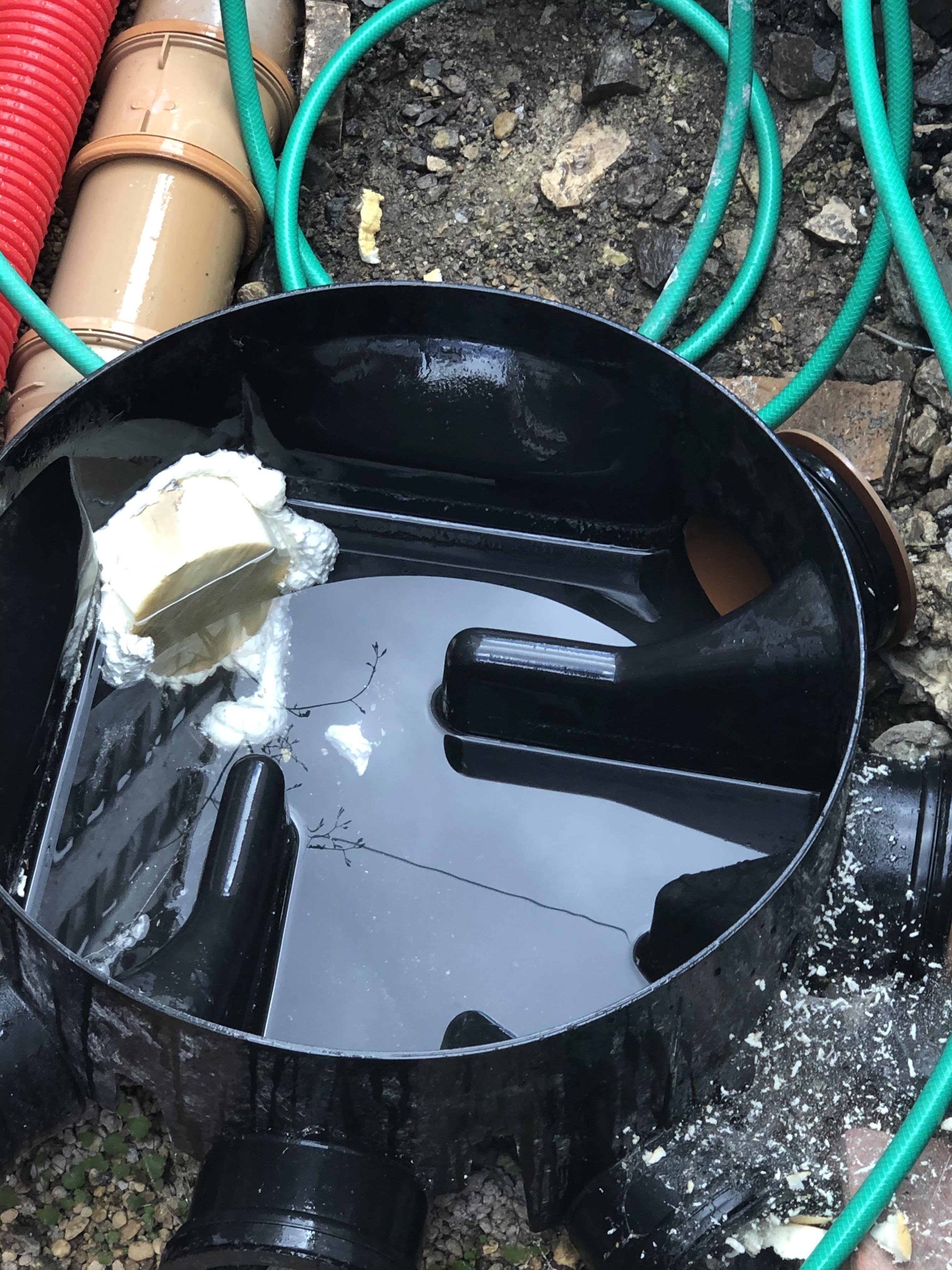

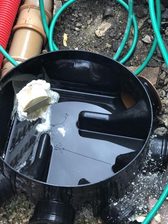

Pocster Posted June 8, 2020 Author Posted June 8, 2020 Ok . It’s not a water tight seal ( lifted drain further down the line and there is a slight trickle ) . It’s a ‘partial’ test . No indication of any leaks in underground bunker
PeterW Posted June 8, 2020 Posted June 8, 2020 42 minutes ago, pocster said: Because I want a water tight seal and I love expanding foam ! ? But you've now screwed the pipe up, you can't use foam eater to clean it as it will damage the pipe, and there is a very good chance the foam will leave a residue on the nice shiny pipe that will trap crud and other sliding items... 1
Pocster Posted June 8, 2020 Author Posted June 8, 2020 12 minutes ago, PeterW said: But you've now screwed the pipe up, you can't use foam eater to clean it as it will damage the pipe, and there is a very good chance the foam will leave a residue on the nice shiny pipe that will trap crud and other sliding items... ? Its now cleaner than a babies bum !
Mr Punter Posted June 8, 2020 Posted June 8, 2020 It is well worth buying a couple of drainage plugs for testing and isolating. https://www.screwfix.com/p/bailey-steel-drain-test-plug-100mm-2-pack/62513 The expanding foam was a bit mental. 1
Pocster Posted June 8, 2020 Author Posted June 8, 2020 13 minutes ago, Mr Punter said: It is well worth buying a couple of drainage plugs for testing and isolating. https://www.screwfix.com/p/bailey-steel-drain-test-plug-100mm-2-pack/62513 The expanding foam was a bit mental. Mental or sheer brilliance!!? !
Oz07 Posted June 8, 2020 Posted June 8, 2020 Yeh I've got a few bungs 6" and 4" always like to test drainage to 1m. To be fair though I've never had a bad pvc underground joint. Sometimes I've had an air bubble/lock in a temporary fitting or something which can play tricks on you 1
