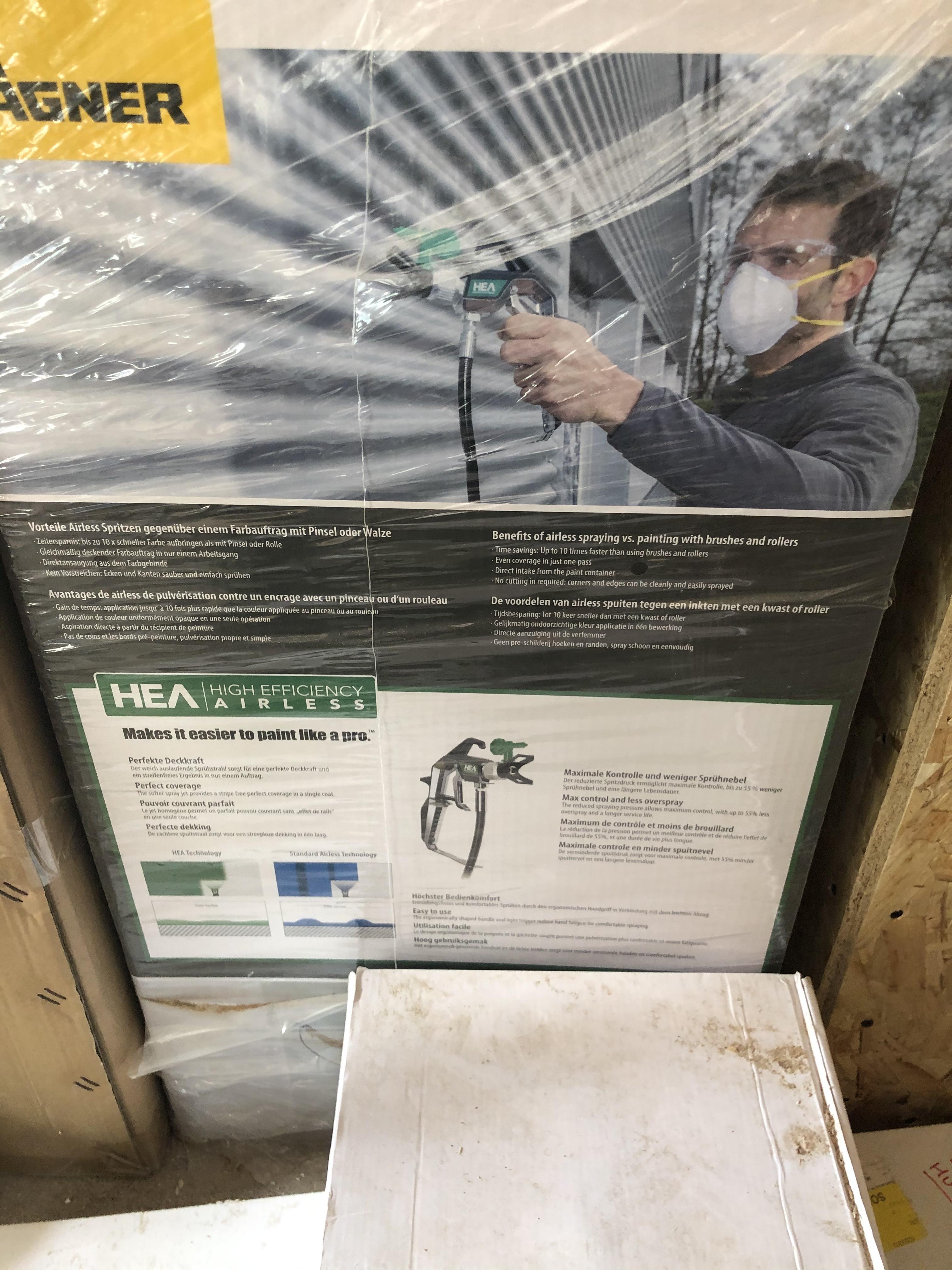

Pocster Posted May 26, 2020 Share Posted May 26, 2020 Ceilings being skimmed this week . I wanted to finally unwrap the Wagner to spray them . I did want to use moisture resistant bathroom paint for the ceilings . Any suggestions on a brand ? . Also I know I need to dilute for the initial few passes to seal the plaster . That not a problem with “bathroom” paint as opposed to standard emulsion ? Link to comment Share on other sites More sharing options...
Pocster Posted May 26, 2020 Author Share Posted May 26, 2020 He’s got his ppe ! Link to comment Share on other sites More sharing options...

Onoff Posted June 2, 2020 Share Posted June 2, 2020 On 26/05/2020 at 10:06, pocster said: Ceilings being skimmed this week . I wanted to finally unwrap the Wagner to spray them . I did want to use moisture resistant bathroom paint for the ceilings . Any suggestions on a brand ? . Also I know I need to dilute for the initial few passes to seal the plaster . That not a problem with “bathroom” paint as opposed to standard emulsion ? 'airless like your avatar. 1 Link to comment Share on other sites More sharing options...

Ferdinand Posted June 2, 2020 Share Posted June 2, 2020 (edited) 5 hours ago, pocster said: That not a problem with “bathroom” paint as opposed to standard emulsion ? I'd say that will be a helluva problem. Personally: don't without a test. I would spray the first coats then roller, unless you are in boy with toy mode. Read the megathread though. The paints I have sprayed OK: Leyland Trade, Armstead (sp?), Valspar. Who's the ugly chap in the photo? Edited June 2, 2020 by Ferdinand 1 Link to comment Share on other sites More sharing options...
