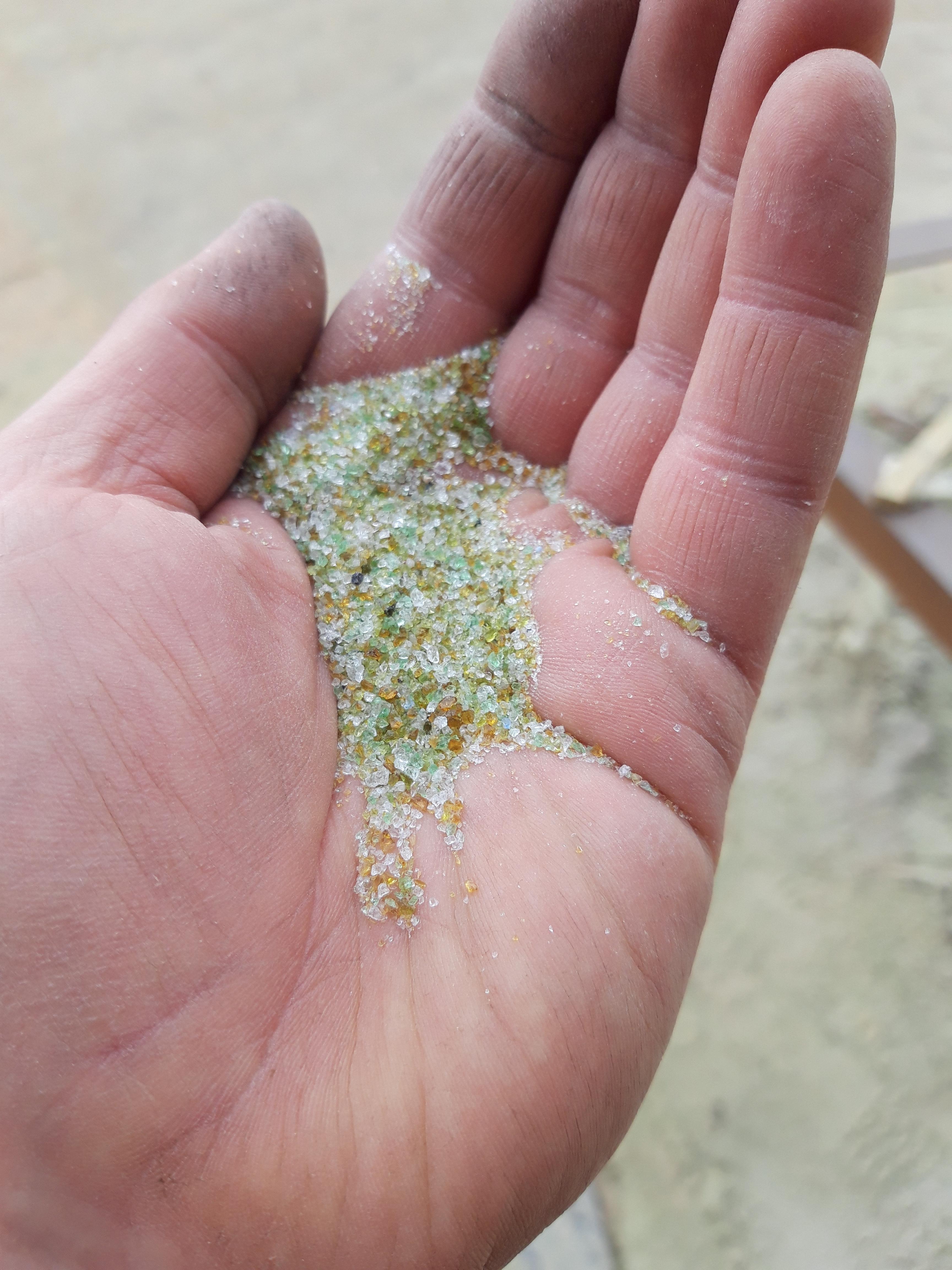

Just collected circa 50kg of crushed glass blasting medium:

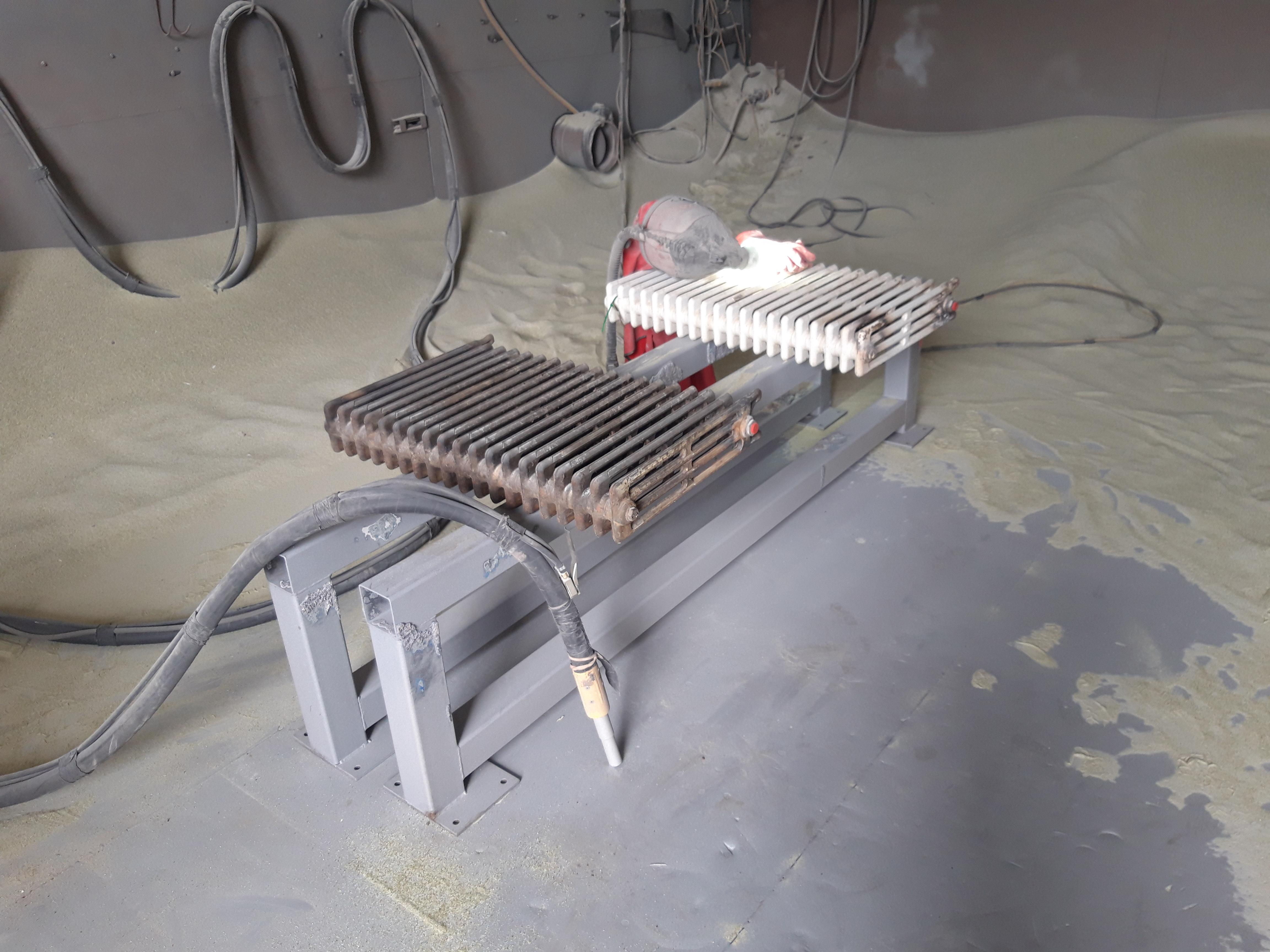

Had a wander whilst waiting for it to be bagged up. Fascinating (to me anyway):
Oak?
Something from Narnia:
Something from Narnia in front of some really big pipes:
And I thought my sliding gate was big:
Bet they've lost count of how many of these done over the years:

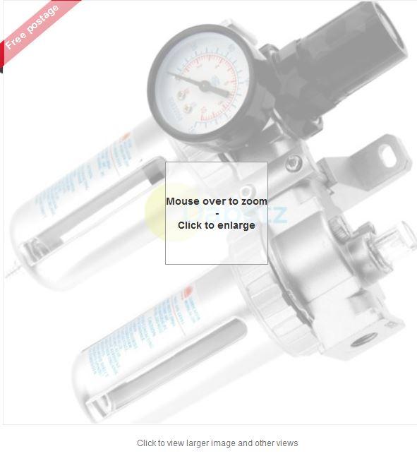

Started blasting and all was good, cleaning up a strut mount top off the wife's old Pug. Very soon though it was just air, not sand coming out. (Same as happened with the Lidl Parkside gun). The air too appears damp as it darkens the metal you're pointing it at. It doesn't darken it when you start off and it's blasting OK. My very uneducated guess is I need a "moisture trap". Tbh I'm a bit of a compressor virgin. Always borrowed one if I've needed to use my nail guns. Spraying, I've only ever done from rattle cans. By a stroke of right place/right time luck I managed to score an Aldi Workzone 24L compressor for the princely sum of £29.95, new and delivered.

I think what I need is as I say a moisture trap maybe combined with an "oiler". I have no experience of either. Been looking at something like this:
https://www.ebay.co.uk/itm/1-4-BSP-...375798&hash=item3b3a1dfde0:g:wfoAAOSw8oJdlh0D
Specification is: Max Pressure: 220 Psi - Oil Capacity: 130cc - Max Air Flow: 105 Cfm
Compared to others on eBay it appears to have the two "glass" cylinders somewhat better protected by what looks like alloy housings. Some are all "glass" which I doubt would last very long with me!
A question, using an oiler with a blasting gun seems a bit counter intuitive. Yes, it prolongs the tool life but surely it must deposit a film of oil on the workpiece that then needs degreasing?
Any pointers to what's good/bad, what I should look for would be appreciated.

Posted
oil is only for tools. Plenty of places run un-oiled air, with the guys putting a drop or two into the end of the tool when plugging in. Or not...
Your problem is probably that the air isn't getting a chance to drop the water out in the tank as the tank volume is small. A moisture trap will certainly help. Remember that big setups use a refrigerated dryer.

Posted
Cheers. Can I get a dual one then and run without oil if blasting, only adding oil if I'm using say the nail gun?
