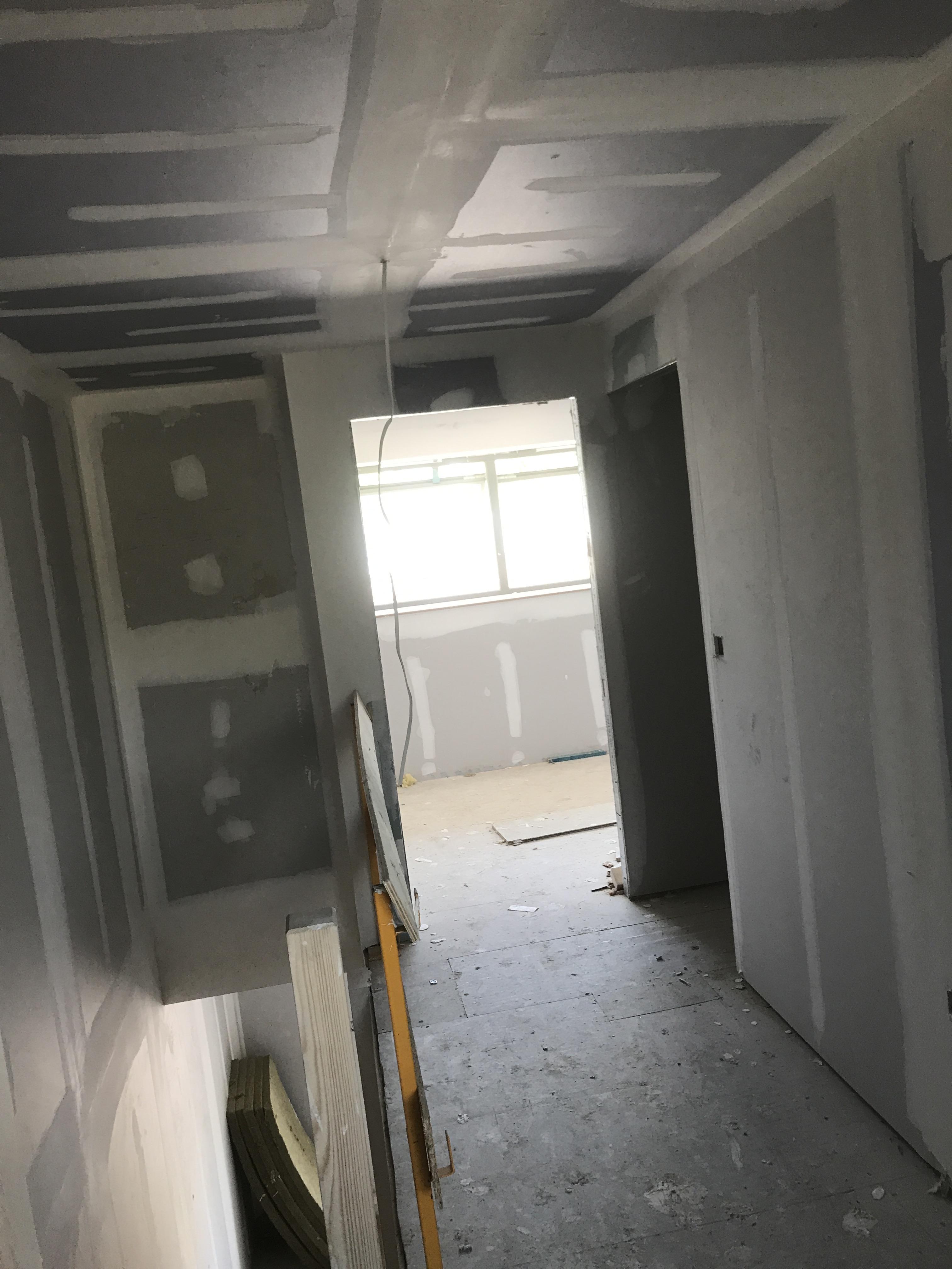

zoothorn Posted May 21, 2020 Posted May 21, 2020 (edited) Hi. Does anyone know - ie from the pov of a plasterer- of any issue with plastering onto taper-edge boards on a ceiling? or, could I not just taper-edge-fill & then its plastered? Reason is: I cannot source 12.5mm straight-edge Soundblock boards (current situation etc).. only taper-edge, so no choice/ have to put on ceiling now. Thanks. zoot Edited May 21, 2020 by zoothorn
Miller3857 Posted May 21, 2020 Posted May 21, 2020 Absolutely no issues with plastering tapered edge boards, I have recently done the same for the same reasons as you = short supply! My Plasterer had no concerns whatsoever!
nod Posted May 21, 2020 Posted May 21, 2020 42 minutes ago, Miller3857 said: Absolutely no issues with plastering tapered edge boards, I have recently done the same for the same reasons as you = short supply! My Plasterer had no concerns whatsoever! I’ve just taped this one this morning Some of these boards are square edge due to supply The-other 42 Units have been skimmed
zoothorn Posted May 21, 2020 Author Posted May 21, 2020 1 minute ago, nod said: I’ve just taped this one this morning Some of these boards are square edge due to supply The-other 42 Units have been skimmed Good job! (ok nod when it comes to taping/ filling my wall boards, I'm gonna be asking a few Q's your way). Good news I can get plasterer to do TE boards then.. don't need to worry & get the damn things up now. Actually thinking on it.. why can't I just tape/ fill & no need for any plastering, like you here then?? I was just under the impression for B.Regs all ceilings had to be plastered, only walls could be taped/ filled. Not neccessarily so then?

PeterW Posted May 21, 2020 Posted May 21, 2020 1 minute ago, zoothorn said: Actually thinking on it.. why can't I just tape/ fill & no need for any plastering, like you here then?? I was just under the impression for B.Regs all ceilings had to be plastered, only walls could be taped/ filled. Not neccessarily so then? You may need it for fire reasons - continue with getting the ceiling skimmed.
nod Posted May 21, 2020 Posted May 21, 2020 If it’s for fire taping fine Most of the fire protection we do is taped and jointed
zoothorn Posted May 21, 2020 Author Posted May 21, 2020 4 minutes ago, PeterW said: You may need it for fire reasons - continue with getting the ceiling skimmed. Good point. Ok so long as I can go ahead & get the pB up.. I can cross this bridghe later. I'm just suddenly landed with my delivery (including xyz for the cabin job).. not end of next week, but tmrw!! (good tho- but panic on!)
zoothorn Posted May 21, 2020 Author Posted May 21, 2020 2 minutes ago, nod said: If it’s for fire taping fine Most of the fire protection we do is taped and jointed Ok this sounds good.. I might just need plasterer in to do my ceiling upstairs only. £saves me.. as surely just 1/2 a day labour to skim it, in these current times, isn't gonna be sniffed at by a plasterer.
nod Posted May 21, 2020 Posted May 21, 2020 2 minutes ago, zoothorn said: Good point. Ok so long as I can go ahead & get the pB up.. I can cross this bridghe later. I'm just suddenly landed with my delivery (including xyz for the cabin job).. not end of next week, but tmrw!! (good tho- but panic on!) Yep push on If you can’t get it skimmed Get it taped
zoothorn Posted May 21, 2020 Author Posted May 21, 2020 1 minute ago, nod said: Yep push on If you can’t get it skimmed Get it taped Exactly- actually it'll be me taping/ filling as only a workshop not perfect is fine for me in here.. if BCO agrees that is. thanks chaps- thread all but over then. miraculously on page1!
