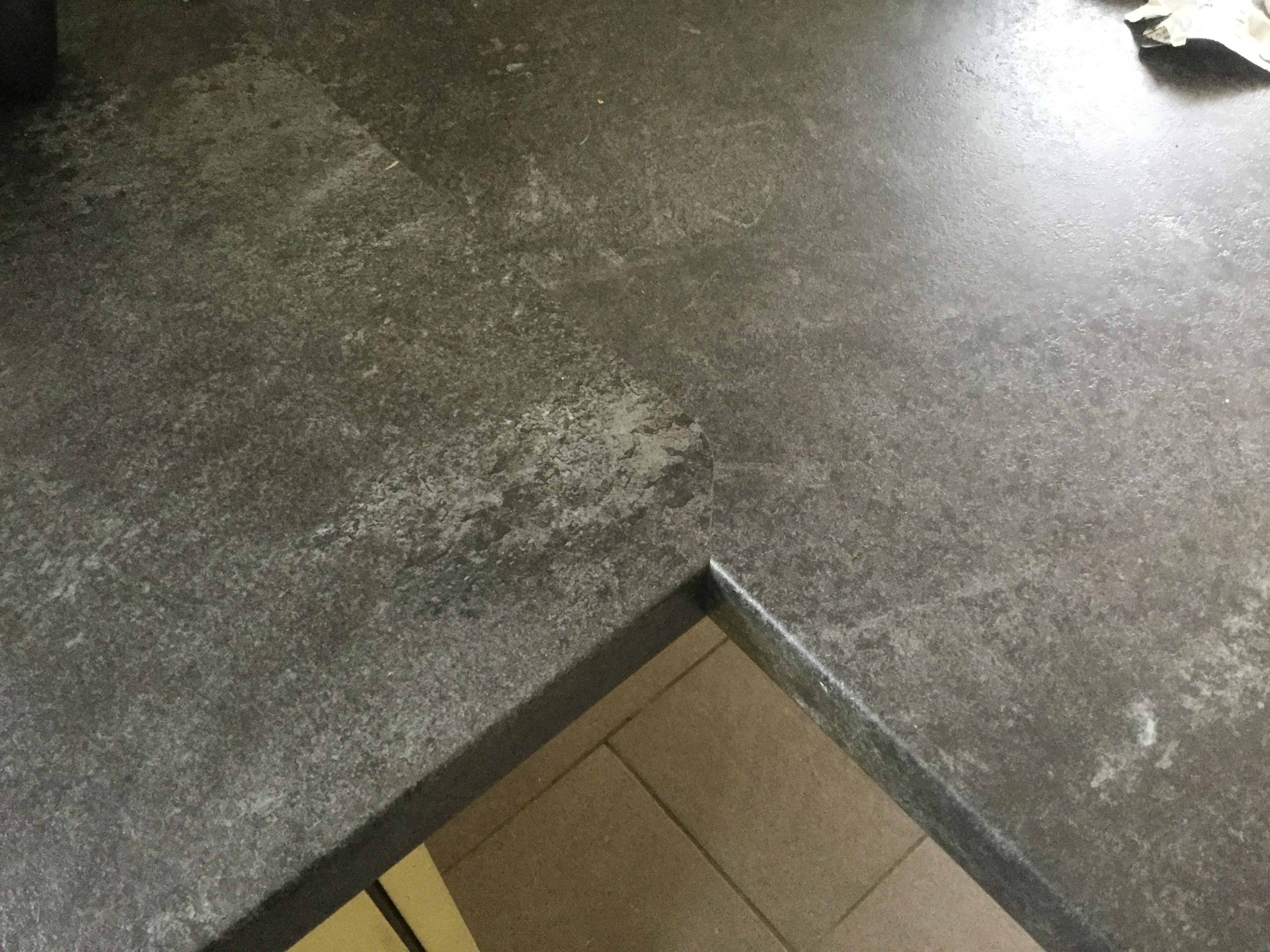

Carrerahill Posted May 19, 2020 Share Posted May 19, 2020 I am ready to fit the worktops, I am now therefore in a bit of a predicament. I like mitred counters, I think it looks smart, I don't know if it's just the geometry of perfectly jointed counters I like because it's clever or if I do actually really care about the joint at an aesthetic level. I like nice engineering and nicely made things so I can sometimes be swayed by something well engineered. I have a 1/4" collet router, which isn't really big enough to take a long enough cutter to do counters and with end float being an issue on long cutters on smaller shafts I just ain't going to risk it. Best case scenario I ruin £500 piece of worktop, worst case I lose an eye. So my thinking was, I will call in the joiner chappy who has done work for my brother and I trust to do the job correctly and well and also to be careful working in my kitchen - then came along the bug from Wuhan! After doing a fair bit of image searching I found that many square edge counters appear just to be butt jointed and clamped (my router will easily deal with the "T" cuts for the clamps) and I have a professional saw that I'd get a brand new fine tooth blade for. However, I suspect that it may actually be laziness and or a lack of skill that many "kitchen fitters" don't take the time to do a mitre. I am tempted to try it myself, I could buy a jig and borrow a 1/2" collet router, buy a couple of good quality cutters and go for it. I could always cut the male piece initially too long as a trial cut. Link to comment Share on other sites More sharing options...

Oz07 Posted May 19, 2020 Share Posted May 19, 2020 10mm mason mitre best for this job Link to comment Share on other sites More sharing options...
Oz07 Posted May 19, 2020 Share Posted May 19, 2020 Link to comment Share on other sites More sharing options...
