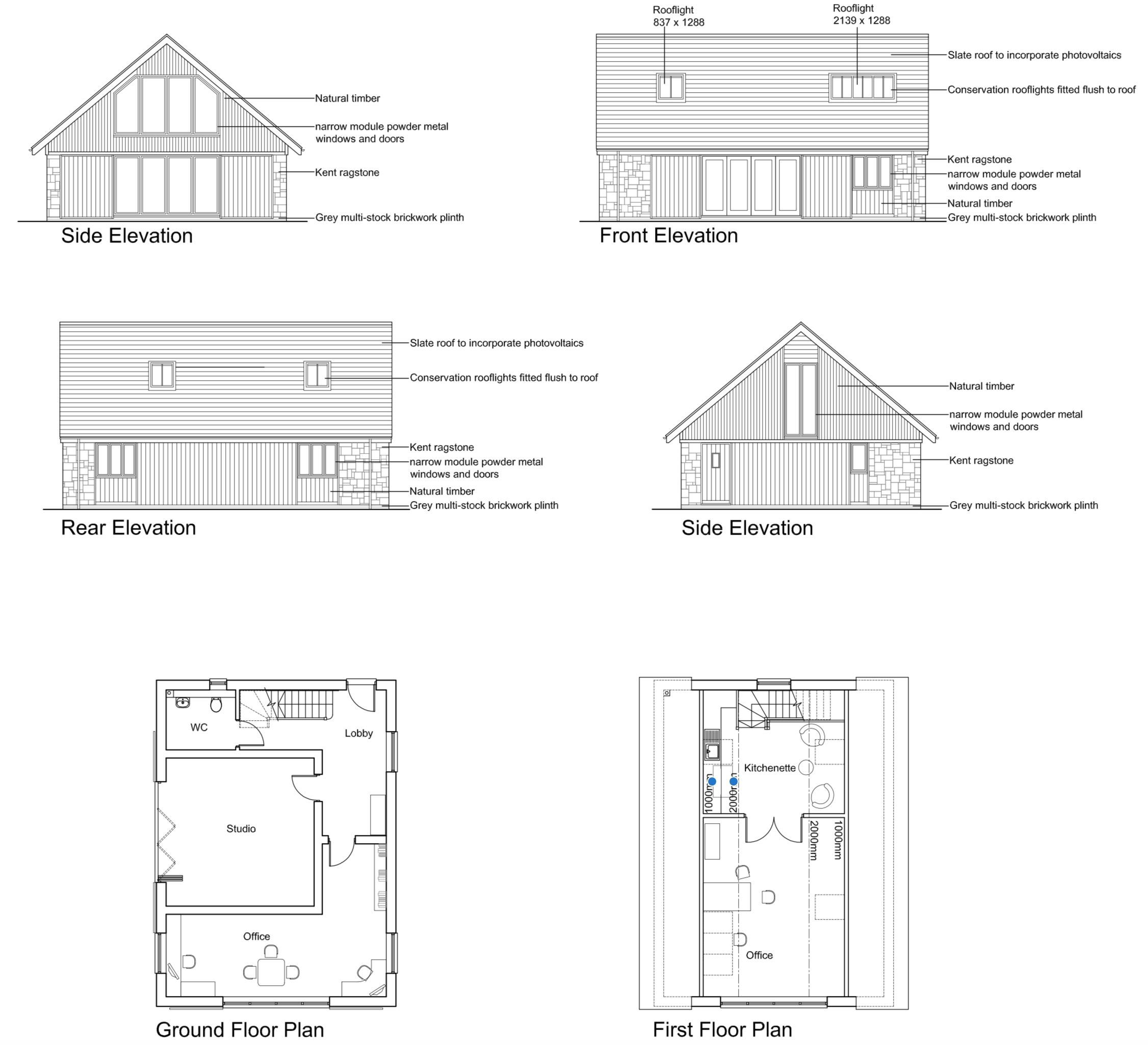

Field_of_Dreams Posted May 19, 2020 Share Posted May 19, 2020 Hi All, I am thinking about a change to one of the buildings I have been granted planning permission for and just wanted to know the best way forward in terms of the planners. The build has not been started yet. See attached drawing of current design. I was thinking about taking the first floor (side elevation top left) south wall (all of it including the windows) back 2 meters. This would then give me an undercover outdoor area. Everything else, roof, walls, ground floor, overall size etc would remain as it is now on the plans and has approval for. There would also be a need for a slight change to the roof windows in that they would either be reduced in number or moved slightly. Does this usually mean a change to the application or can it be dealt with in a more simple manor? I am hoping that it can be simple as I am not changing the external size or footprint but maybe I am placing too much hope in our planning system ? Thanks Link to comment Share on other sites More sharing options...
Carrerahill Posted May 19, 2020 Share Posted May 19, 2020 1 minute ago, Field_of_Dreams said: Hi All, I am thinking about a change to one of the buildings I have been granted planning permission for and just wanted to know the best way forward in terms of the planners. The build has not been started yet. See attached drawing of current design. I was thinking about taking the first floor (side elevation top left) south wall (all of it including the windows) back 2 meters. This would then give me an undercover outdoor area. Everything else, roof, walls, ground floor, overall size etc would remain as it is now on the plans and has approval for. There would also be a need for a slight change to the roof windows in that they would either be reduced in number or moved slightly. Does this usually mean a change to the application or can it be dealt with in a more simple manor? I am hoping that it can be simple as I am not changing the external size or footprint but maybe I am placing too much hope in our planning system ? Thanks Just email or phone your planning officer and ask them what they will accept. I spoke to my officer, she told me to email it over and alter drawings to suit and she's put it through as a non-material variation. Not sure if moving a wall 2 meters would count... Link to comment Share on other sites More sharing options...
DevilDamo Posted May 19, 2020 Share Posted May 19, 2020 You would normally have three options... - Non-material amendment - Variation of Condition - Revised Full application (as I assume this didn’t go through as a Householder application) The NMA is the quickest but the LPA do not make it clear as to what is classed as non-material. The VoC is definitely one way but can take up to 8 weeks to be determined. The revised Full application is also another way but again, can take up to 8 weeks to be determined. You’s have to pay application fees for the NMA and VoC applications with the latter being the more expensive. You’d be exempt from having to pay another application fee if you went down the revised application route, providing the re-submission is within 12mths of the previous and you haven’t had a free go on the site in the past. As above, check with the Planning Officer as to how they think the amendments can be dealt with. Link to comment Share on other sites More sharing options...

Field_of_Dreams Posted May 19, 2020 Author Share Posted May 19, 2020 Thanks for taking the time to explain @Temp, @DevilDamo, @Carrerahill. Now I know my options, things are much clearer to me. I will have a chat with the case officer and see what can be done. Link to comment Share on other sites More sharing options...
Field_of_Dreams Posted May 22, 2020 Author Share Posted May 22, 2020 FYI...Case officer has come back and said "minor material (Section 73) application" would be needed. https://www.planningportal.co.uk/faqs/faq/65/where_can_i_find_the_material_amendments_form Will investigate further. Link to comment Share on other sites More sharing options...

DevilDamo Posted May 23, 2020 Share Posted May 23, 2020 A Section 73 application is a Variation of Condition application, which is completely different to a Non-material amendment application. The application fee, process and timescales are different. Just out of interest, what type of application was the original, Householder or Full? Link to comment Share on other sites More sharing options...
Field_of_Dreams Posted May 23, 2020 Author Share Posted May 23, 2020 @DevilDamo Full planning permission originally. Link to comment Share on other sites More sharing options...
DevilDamo Posted May 23, 2020 Share Posted May 23, 2020 Ok. If you were to proceed down the VoC route, you’d have to pay an application fee of £234.00 with a determination period of up to 8 weeks. Your other option is to submit a revised Full application as you’d be exempt from having to pay the application fee but would still have a determination period of up to 8 weeks. Just a note on the “free go” is that the revised application would need to be submitted within 12mths of the previous and you haven’t used up a free go on the ‘site’ before. Link to comment Share on other sites More sharing options...
